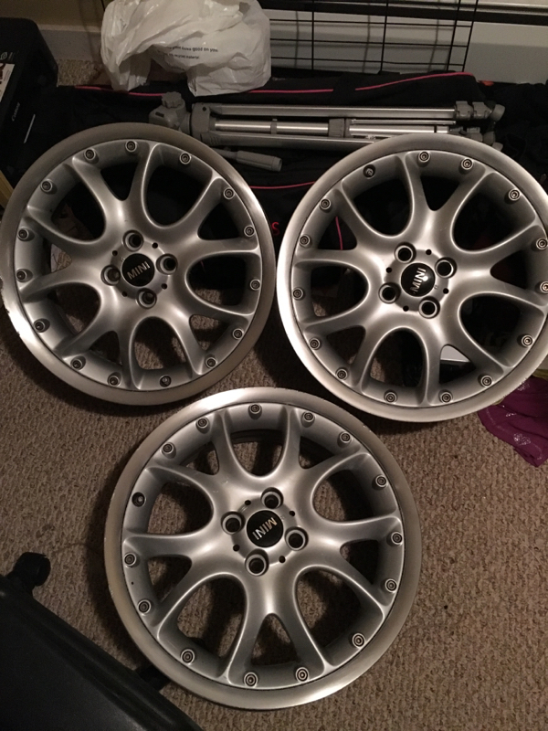

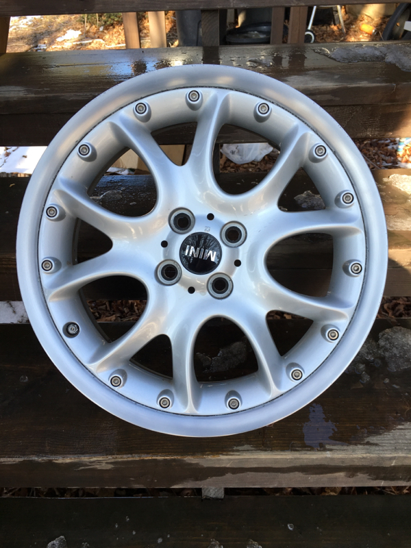

Started refurbing my recently acquired r98s used some 3m sandblasted sanding pads. Stiripped the clear coat with Kleen strip and sanded with 60 grit then 80 grit and finished with 320. Then hit them with never dull. Came out pretty decent for my first attempt at wheel refurbing.

Well done, glad you are saving the R98 and bringing it back to life.

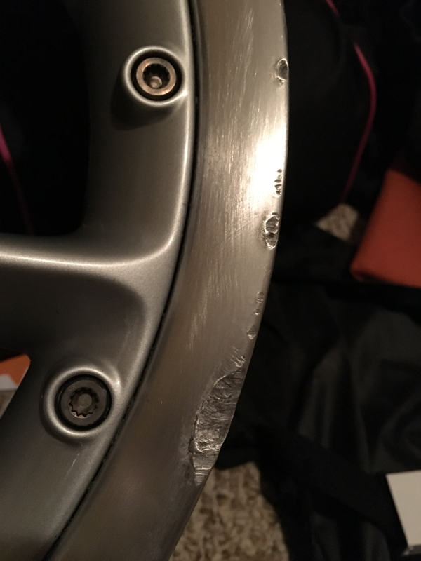

I've refinished the r98 lips so I think I'll get a set of tires for them and get them on soon. 3 wheels were rough while one was in excellent shape. One has a chunk missing which I haven't decided what to do with yet, I'm sure it won't cause any issues but it's not real pretty to look at.

Wheel repair places can fix that, I would get a quote to fix that.
Shoot me some pictures of what you have as far as the wheels go. (PM me and I'll shoot you my cell #). Every Saturday morning, I hang out at my friends wheel repair shop. I can get you a quote. He does everything from Hyundai to Lamborghini wheels. I'm in the middle of a complete refurb of some R98's. The next pics show what I was playing around with. I'm not going to go with this finish for the center but I wanted to see how it would look.
