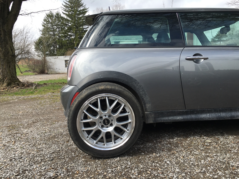

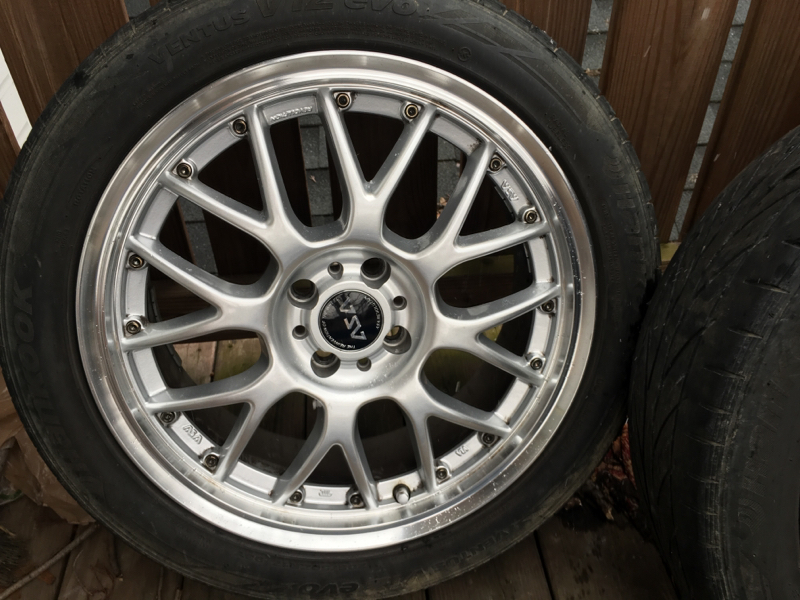

Really happy today, been wanting a set of r90s forever. Today I bought the next best thing, ASA AR1 revolutions. $325 and they are almost mint, I'd say 9.5 out of 10 can't wait to get them mounted up. Couple quick photos I took
Attached Thumbnails My r53s progress thus far-image-1605206559.jpg   My r53s progress thus far-image-857438461.jpg   My r53s progress thus far-image-718532897.jpg

Those are some nice lookin wheels bav.

Looks good, nice find. Looking forward to pics when they're mounted!
