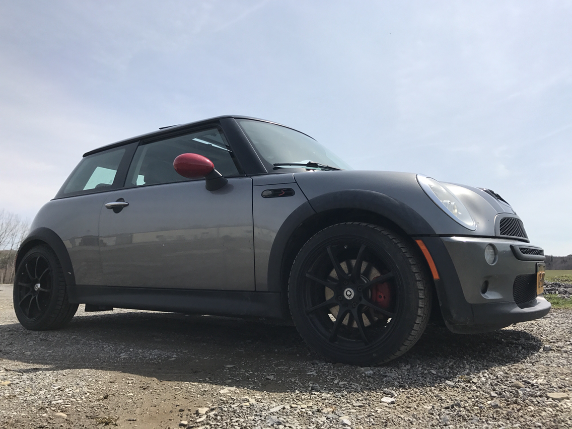

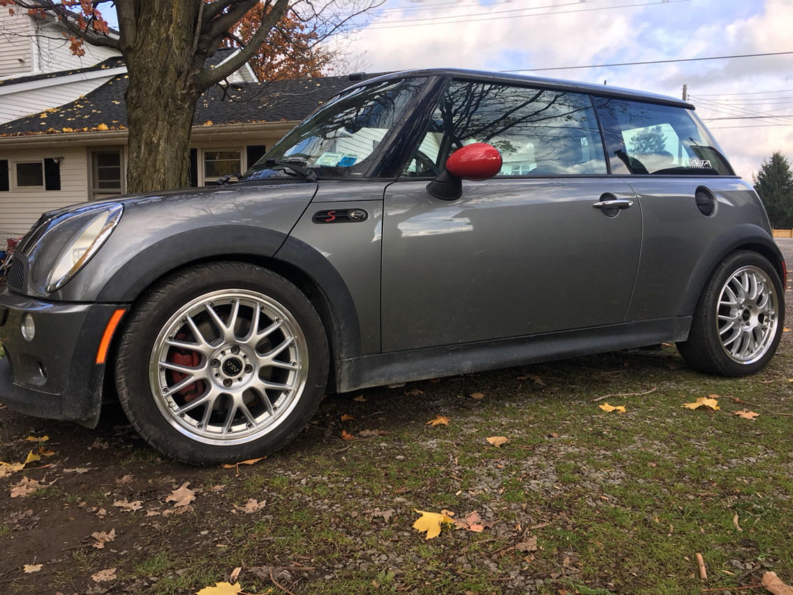

Slapped my summer wheels on temporarily while I get my tires mounted to my feathers. Tire profile isn't correct but otherwise should look decent when lowered. Going with TSW springs for a moderate drop and undecided on the shocks yet.

Quick driveway shot

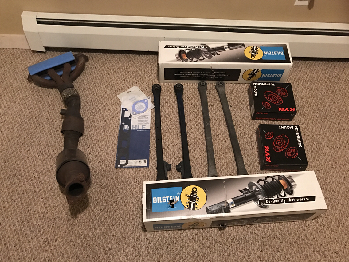

Got a few parts in today, time to swap some parts out this weekend.
-front bilstein shocks
-Kyb strut mounts
- used oem header to replace my cracked header along with new gaskets
- all rear control arms that i received from a local member (in much better shape than mine)

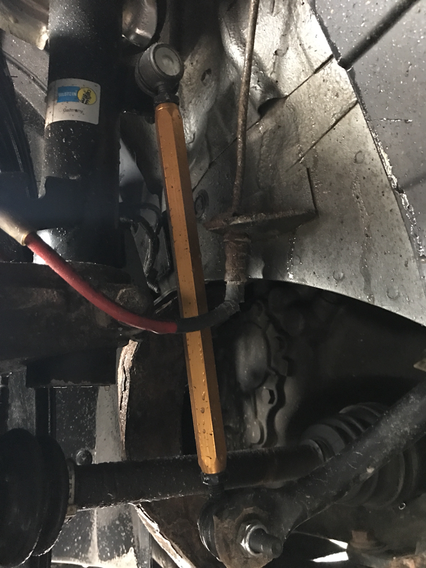

So after a long day today, got the new bilsteins and mounts on, along with some whiteline end links, a rear wheel bearing and the replacement header. She's quiet and smooth as silk.

Every front suspension bushing is new now. Handling is excellent

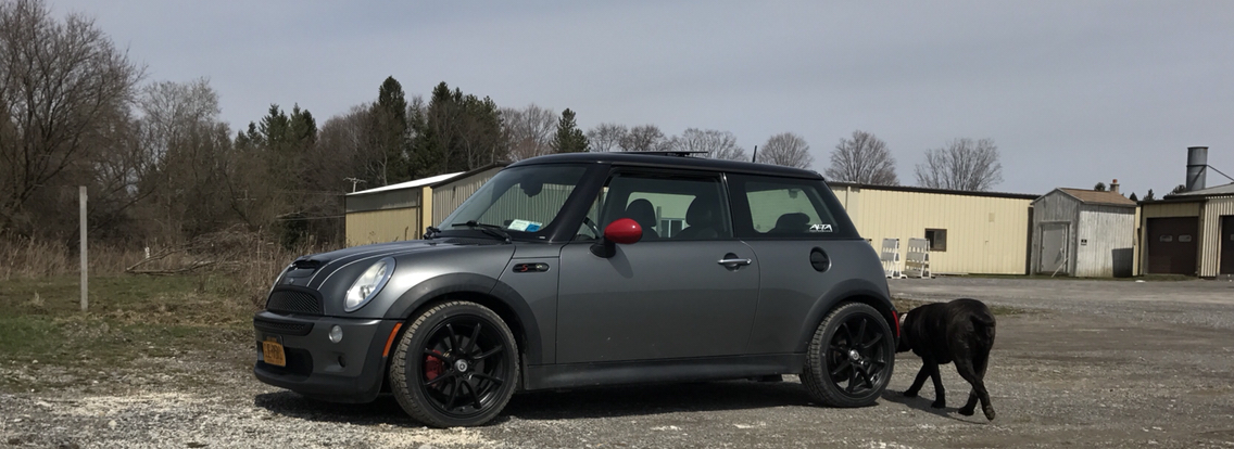

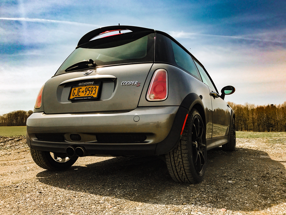

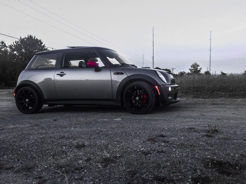

ended up keeping the stock springs for now, she rides nicely but the fender gap is too much to stay this way. heres some spring weather shots

Clean and mean
