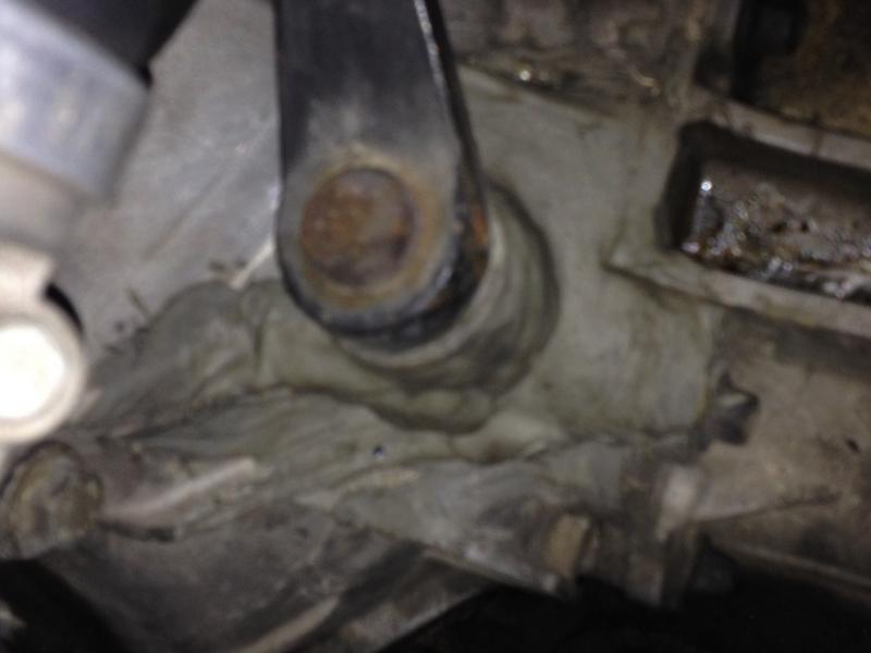

I bought my first mini a week ago .... Yesterday clutch goes out!! So drop it off
At big apple auto repair in Marietta , the tech sends me THIS PIC!!!

Wow, that really looks like #$%#$. With that said, did that have anything to do with the clutch failure?

Tech said it allowed for "play" & said he drop tranny & see what eles is going on
The pedal became sorta hard to push & with 100miles now when you ouch in the clutch it's sounded like a bottom end knocking .... & clutch was 100% not working ((as in I couldn't disengage) ..... But I crank it in first & speed shift to 3rd then 5th to get it to the repair shop

Get your money back.....

+1 on this. You clearly inherited a problem that someone took a major shortcut to fix.

I also would try to get your money back.. Ive seen a few MINIs now with the 5 speed transmissions where the case has been welded from some previous problem.. So there must be something that is a known problem.. I think the 5 speed trans. is the Midland type that have these problems.. But either way I wouldn't leave the JB cold weld on it.. I would either get it welded or find a new case or transmission..
