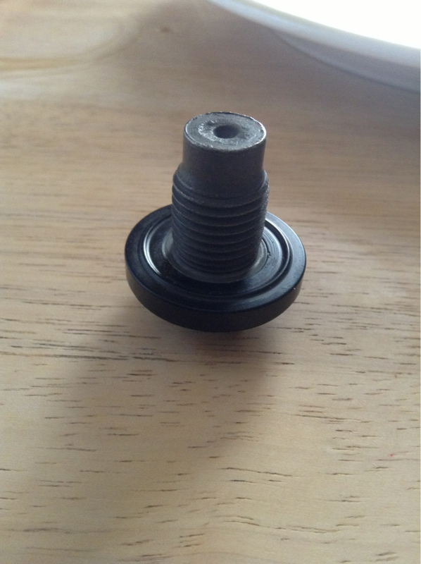

What do you guys think of this photo. This drain plug was in the cup holder when I bought the car. I first wondered if it was used already, but now I don't really see any tool marks, and the ridge on the inside rubber part looks tall and defined. It may have kicked around with a handful of quarters in the cup holder, judging from the bolt face.
In your opinion, do used ones come out that clean, or is this new?

It looks new. So I would IMO feel safe using it.

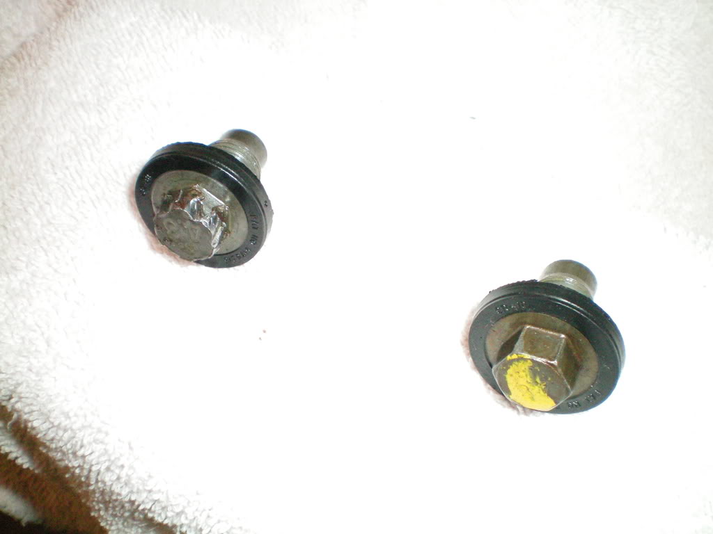

I'd order a Fumoto and hold off on the change
The plastic looks the same on all I've removed . . .
left ... mangled after being stuck and attacked by an extractor
right .... one that's never been a problem
does the plastic seal look different?
