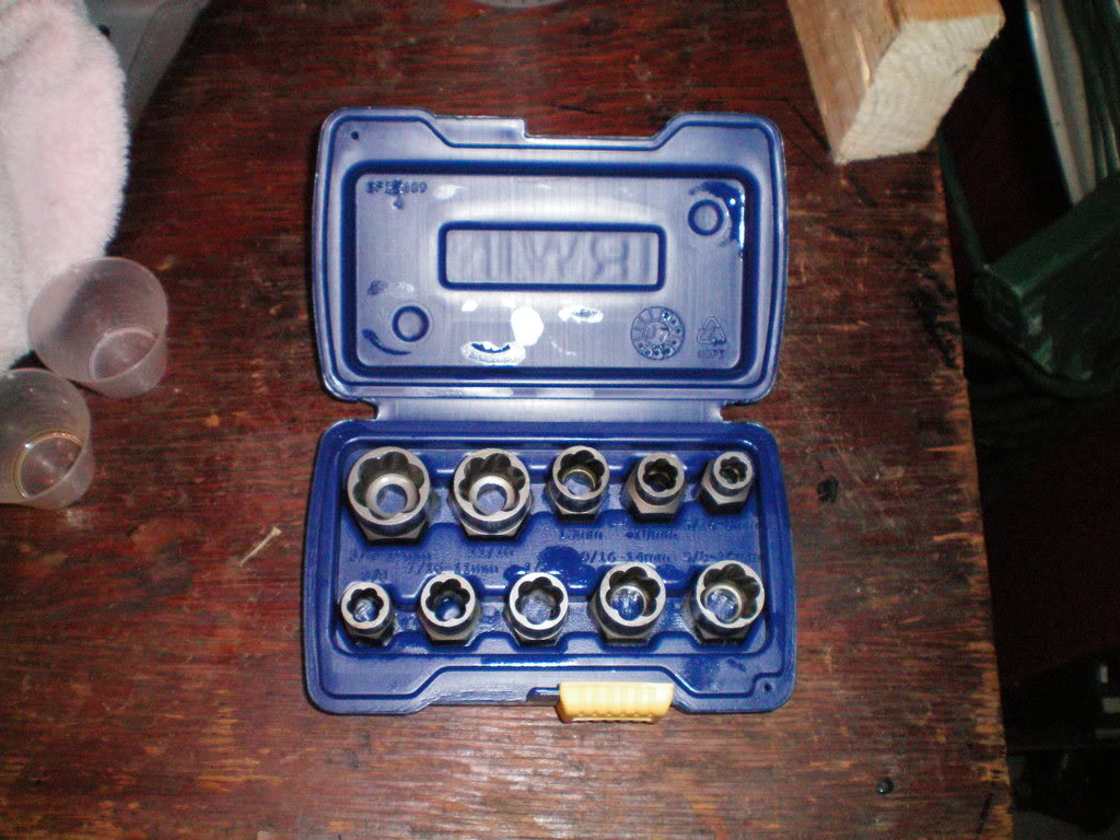

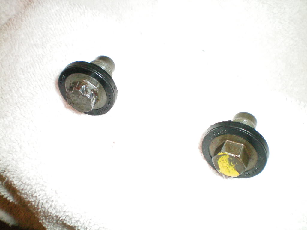

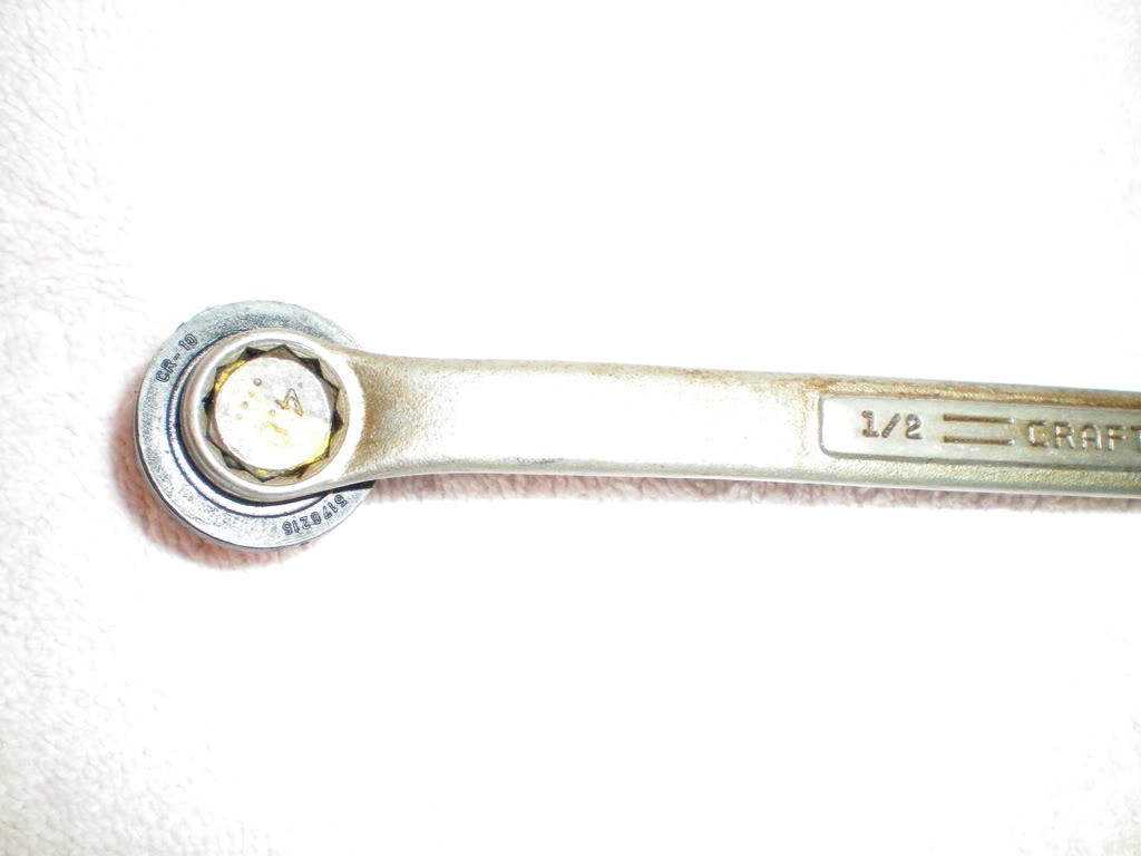

I don't suppose you read any of the MANY threads on this issue? Written up many times since about 2003 . . . but I guess not expecting a problem you didn't search on 'oil change' or any related topics. Example:
https://www.northamericanmotoring.co...rain-plug.html
Then you would have known that the built on plastic gasket is highly suspect as the problem .. bad design.
And that the recommended metric size for the drain bung is actually not the right size and contributes to your problem - it is a perfect 1/2 inch bolt size.
an outside extractor is a recourse once you mess up the head

once again you discover that a 1/2 fits best . . .

on all of the cars I've had that use a crush washer on the bung - and I believe the first of those was my 83 rabbit convert' - the washer was a use once item. My current Honda's and KIA use alum' ones that cost a few cents each. Crush washers are sometimes a fiber material too, scanning the selection at my local parts store when I decided using one might stop a drip on my 79 - which it did.
The GEN1 MINI service manual actually calls for a new plug each time since the crush washer - plastic - is integral to the bung
