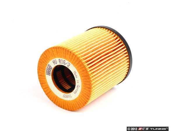

If I have the new style oil filter cap am I good? Is it possible a previous owner put on the new style cap on an old style base? Is Mann-Filter HU 816/2 X for the new or old style housing?

ewgoforth - First Make sure they sent you the correct filter.
Mann HU 816/2 X Looks like this. Its for all Gen 1 MINIs.
http://www.ecstuning.com/Search/SiteSearch/11427512446/ES257649/
Also here is a thread which talks about the older and newer style housing and all the links.
https://www.northamericanmotoring.co...-question.html
Thanks and hope that helps.
Yes, you're good. That's the filter with the plastic cage inside. And yes it's very likely that in the past someone put the new style cap on the old base.
That's what my new filter looks like. the old one was different. I'll see if it has any numbers, etc. on it, it was a Mann too.
The 816/2 fits both early and late filter housings? I guess you still need a spring with the early housing? If it has a frame, I wouldn't think you'd need a frame?
Are you saying this filter works with either housing style?

FYI- I put that exact filter over my spring/cage assembly last time I did an oil change. So in my experience they work with both.

I have a 11/2003 production 2004 MCS, bought new, and it has the "later style" canister cover without the plastic cage and spring. This doesn't jive with the 7/2004 production change from the old to the new style mentioned earlier. The car was serviced by the dealer during the free maintenance period (as I recall 3 yrs) so perhaps they swapped it out to the newer style, although I'm sure it never appeared on any work order.
I've been using the Mann HU 216/2x for all the oil changes the last six years or so and they've worked fine. I am pretty careful to pre-fit the filter before starting the cover on, making sure it doesn't x-thread, and lubing the o-ring well so it doesn't pinch. No issues so far. It is a fussy car to do an oil change on though. Why the Germans don't adapt the proven and reasonably fool-proof spin-on one-piece disposable design is unfathomable to me.

I pulled off the cover on my oil filter and it's definitely the later type, so I guess I'm okay unless somebody just put the newer style cover on the older style base. It doesn't seem like anyone knows if that'll work. It also looks like I was lucky that the oil filter that I got from Advance Auto didn't implode, since it looks like it was the early type without a frame.
I didn't realize that the new part is the cap AND base... I thought that the base was the same on both, and everyone was only replacing the cap as the correct upgrade. I after reading the description of the upgrade part on MINI Mania, I see it's the cap and base, so it was erroneous for me to say "Yes someone probably put a new cap on an old base".
-Apparently now Genuine MINI Brand only makes one filter that fits all 2002 to 2006 MINI Cooper R50 and R53. That would mean the length of the filter is the same so I can't see why it would make a difference if it's the base holding the filter with the spring, or the new cap pushing from the other end, either case has the same result of holding the filter in the right place.
Only potential problem I see is if one had an old cap and lost the spring, or if one had a new cap and somehow found an old filter without a built-in cage on the market.

What's your production date? For all this talk about the old-style canister cover with spring/cage, there sure don't seem to be many out there with this setup. If the 7/2004 production date mentioned earlier is correct, then I would think well over half the 1st gen production run would have the old-style canister as this would include virtually all the 2002-2004 MY's. I did a quick search and on another forum, someone mentioned that all S models have the new-style canister cover, regardless of production date. So perhaps the 7/2004 production and prior date range is only a R50 thing.
