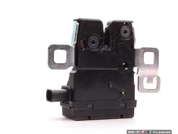

Yea, That's what I figured:
What production month / year in your 2002? I find it very interesting that MINI did not have these in those early 2002- 2003 as it must have not been required yet by MINI for regulations.
Let me know if you want to add it , it looks like they were successful from the links with the retrofit so that way you have the option to have the emergency cable in the future.
Just make sure your older part has the loop to add it.
http://www.ecstuning.com/Search/51242754528/ES91986/
Door lock parts: either the cable snapped or the lock itself is broken
Cable for door lock.
http://www.ecstuning.com/Search/51217143538/ES89991/
Door Lock - Left
http://www.ecstuning.com/Search/51200556768/ES88657/
Door Lock - Right
http://www.ecstuning.com/Search/51200556769/ES88658/
Thanks and good luck
