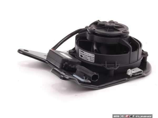

Did you replace the Fan also?
http://www.ecstuning.com/Search/32416857718/ES2558179/
Make sure is spins freely.
Doing the PS pump you just have to reach into a small space and then watch the PS lines and keep things clean.
For the PS pump all the ones we carry are re-manufactured as they have a core charge from Genuine MINI and ZF.
