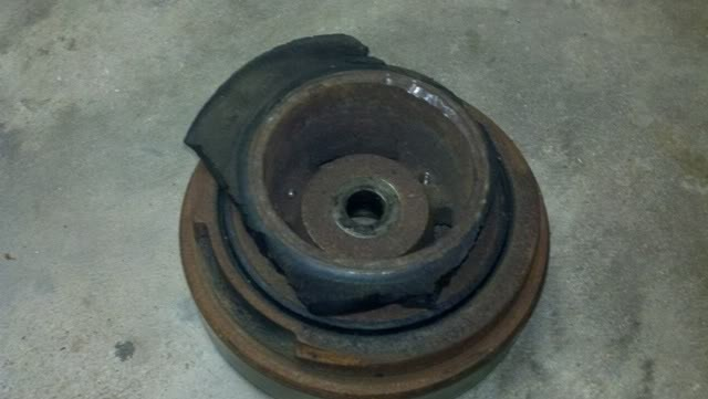

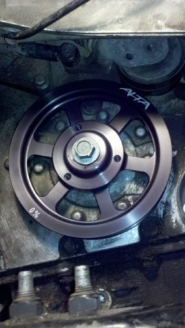

Dead giveaway mine was failing was the belt squeal at 5k rpms. Here's what mine looked like:
So I installed this:

Mine failed this summer. The car went into limp mode when I had the AC on. I ended up going with the ATI 2% with my 15% pulley. Car is back to running smooth again.

Mine went @only 45k mi. Regretted pushing back an earlier swap.

I did mine with a snap-on puller set from work. Basically it's the same as the ones you can get at autozone, just 3 times the price. Had to pick up some different sizes of bolts from ace since the ones in the puller set didn't work. All in all, had it changed out in about an hour by myself. Nice thing about the Alta crank pulley, stuck it in the oven for about 10 minutes, expanded it, and it slipped right on.

Did mine as MYT. Had long prepared a cheap chicken foot crank puller w/ 3 bolts that fitted the OEM damper. Heated the ATI on a portable electric stove for a few minutes. Installation was simple. As advised by K-huevo, check for machining burs on the opening of your new pulley. Smooth them out w/ 2k grit & thoroughly degrease before heating/installing. It's press fit so don't force it in w/o enough heat expansion. You won't want to be extracting it to reheat again. Remember to use new OEM Crank bolt. It's got Loctite & it's cheap insurance.
