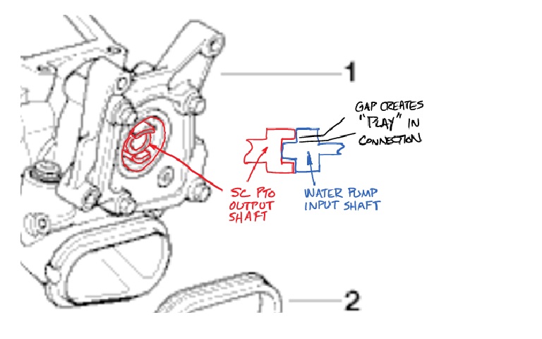

You're hearing the water pump gears, normal. If there is noise while actually rotating the SC, I would be worried.

Tora,
The noise you are hearing is normal. There is quite a bit of play (or slack) between the SC PTO output shaft and the waterpump input shaft. If you hear a grinding noise or it feels "rough" as you turn the input pully, then you may have PTO gear damage. I've attached an excerpt from RealOEM showing the PTO output shaft. Sorry for the poor resolution. I hope this helps relieve your fears!
