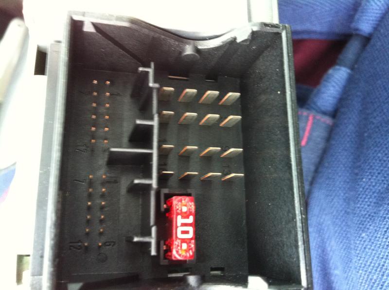

Purchased a used after market head unit from a wrecked 02 mini cooper. Looks like its plug and play, but when I connect the 2 adapters and the wire plug... I get nothing. Any ideas? See pics. Thanks
This is the original radio back
This is the new radio plug in and plug
This is the original plug in. is the white bar with 12 holes for the steering wheel controls?

No. The main connections are the ones with the flat blade pins, and the wiring for those never changed throughout the life of the 1st generation MINI. The headunits are interchangeable for all years. The newer ones just have additional features.
There is a pinout diagram in this thread: https://www.northamericanmotoring.co...nd-system.html. The white connector with 12 pins is for an optional CD Changer.

no, the radio doesnt power up at all. Im hoping its the 10amp fuse for the ACC red power wire. Gonna try to get one at the auto shop tomorrow and test it.

ok, the red accessory wire is not connected to anything. Its wired to its on 10am fuse, but the end is not connected its cut and capped off with a plastic cap. Should the red wire still connect to something inside the car?

FIXED!! The problem was the red ACC that I figured was fine since it was connected to a fuse. WRONG! So I spliced into the purple/blue acc wire to the mini harness. Easy as Pie!
