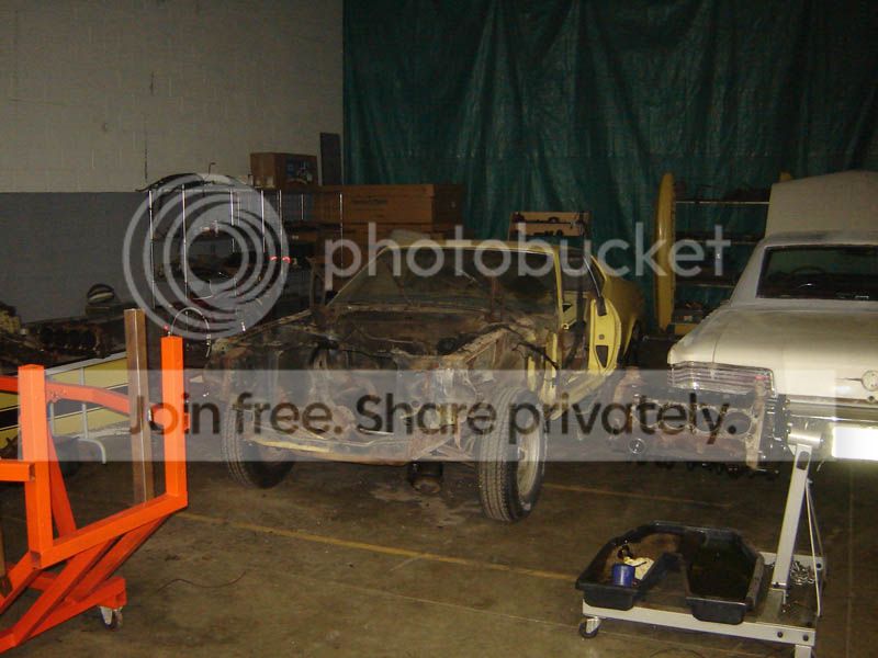

Finally got around to getting the motor in the mustang apart.
i worked for about 3 hours tonight trying to take it apart carefully, the intake was fighting me, i had to flip the motor and beat on the intake to get it to break loose.
other than that, for a 130k mile motor, it looks pretty good. i cant get the balancer off the crank, i think i need to try a gear puller tomorrow. i'm going to have my in house engine builder take a look at the short block tomorrow and see if he would recomend tearing it down further, or just going a head and doing a short block up rebuild.
well, here are a few of the many pictures i have....

Looking good! But don't use a gear puller on the balancer unless you intend to replace it--because it'll destroy it. Instead, use a harmonic balancer puller that threads into the pulley holes and pushes on the crank. Last time I took a V8 intake off I undid the bolts then used a hoist, and it lifted the entire front of the car off the ground! Good thing I hadn't pulled the engine out first.
yes, i found the proper puller in the toolbox the next day, what a royal PITA!!!
