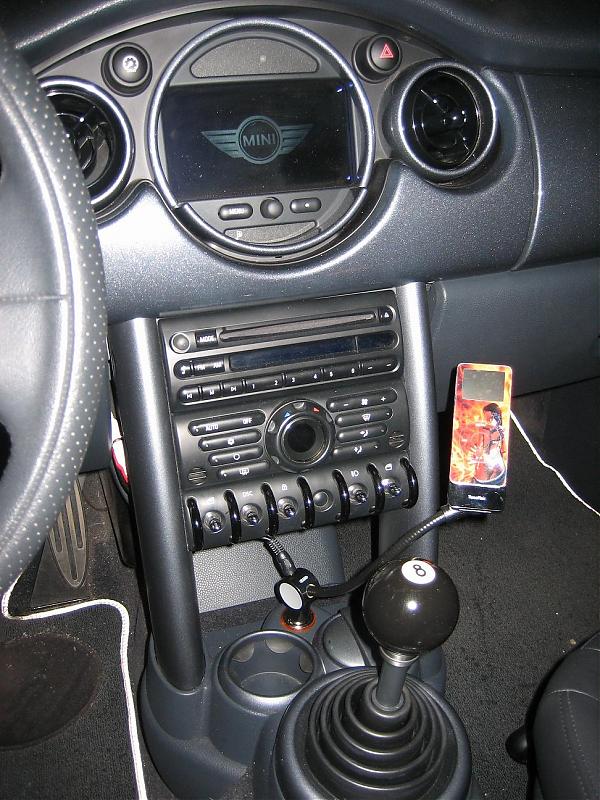

My Ipod Install with a TuneFlex
Here's a picture of my Ipod Nano (with a skin) on a TuneFlex by Griffin. Its basically a flexible neck that cradles the Nano specifically and it plugs into my cigarette lighter outlet. My DIY Aux cable connects to the 1/8 jack at the base of the TuneFlex. At first my HU didn't recognize the Ipod through the TuneFlex (bought used from eBay 14 bux shipped), but the Ipod worked when connected directly. With a suggestion from ShankRabbit, I purchased a ground-loop isolator(around 20 bux with adapters) from RadioShack and it still didn't work. The TuneFlex was still not recognized by the HU. I was pretty frustrated at this point so I returned the GLI to RS and gave up for 2 days. I ended up ordering a brand new Tuneflex from a vendor on PriceGrabber.com for around 40 bux. I plugged it up and it still didn't work, so I went back to RS and bought the darn GLI again and "PRESTO," EVERYTHING WORKED PERFECTLY!
Moral of the story is, don't buy used electronic type items from eBay just to save a few bucks and don't give up so easily.
I love this set up by the way. It's clean because you don't really see the wire next to the 12 volt adaptor. It holds and charges the Nano. Best of all its versatile. You can bend the Tuneflex anyway you want. I have it close enough to my shifter that my wrist still rests on my **** while I'm changing songs. I totally recommend the TuneFlex if you have a Nano. I probably wouldn't recommend it for non-Nano owners, because the 12-volt socket is kind of weak. Other Ipods would be kind of heavy.
Oh and yes, before anyone asks, that is the RCA cables from the GLI on the left side under my steering wheel. I got lazy because I'm going to buy a Parrot, Bluetooth soon and I'll make everything pretty then.
