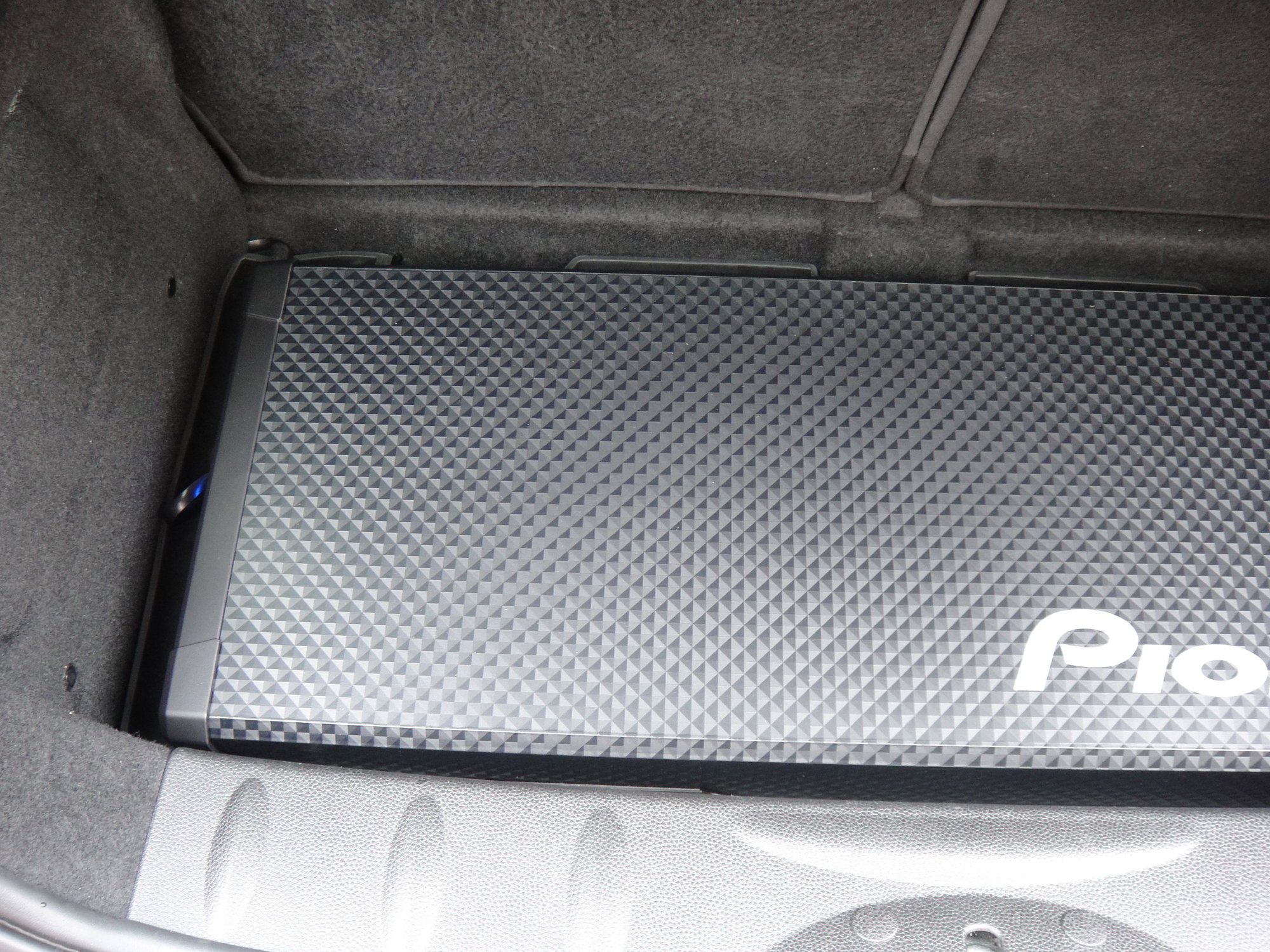

I added the pioneer TS-WX70DA active sub to my 2013 R56 JCW Mini. Admittedly, it has the Harman Kardon factory fitted. The active sub made a HUGE difference, it sounds fantastic! Fits brilliantly, too. See pictures.
Look how well it fits in the R56 boot. 'Made to measure' springs to mind!
Comes with a super handy wired remote control, too.

nice. Where did you tap the power and input from?

I took the constant 12v directly from the battery. The input can be either via RCA's or speaker level inputs. I used RCA's after purchasing one of these, from Integral Audio.
