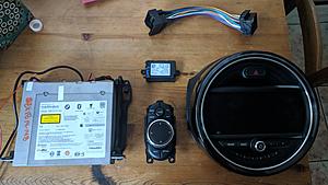

all materials arrived the other day. busy until next week so wont' start until next weekend. note the 8.8" Headunit is from a 2016 MINI. from what i understand, i'll be activating BMW apps, navi, voice control, sirius-XM, and a few other things.

few short notes:
1)if you have the base radio (non-visual 2-line display) then you CANNOT do the 6.5" or 8.8" retrofit. you will need to do 2 things to make it work
- unfortunately, the dash has 2 part numbers. one for the 2-line display radio and one for the 6.5 or 8.8" radio. the difference is that the bracket behind the display is smaller and will not allow the 6.5 or 8.8" headunit to fit w/out cutting. now if you don't care about cutting into the plastic behind the dash, have at it.
- the audio controls panel (power button, menu settings, favorites, etc...) is powered via a plug on both the 6.5" and 8.8". on the base radio, there is no plug as the screen and headunit are one unit. if retrofitting, someone will have to find a donor car and trace each of the 8 wires and figure out what their purpose is and then create that harness on your own.
2) if you want to upgrade from 6.5" to 8.8" it's 100% doable. couple parts that need to be purchased and some coding that would need to be done but it's completely doable.
3) i cannot confirm the touchscreen system, but i'm assuming that it is also doable. the challenge will be cost because obtaining the touchscreen is probably going to be costly unless we find a crashed mini.
for anyone that is interested in doing #2, feel free to reach out. i have access to affordable screens/headunits and can work with you on completing the install.
personally though, i will not be continuing with this install due to the fact that i will NOT be cutting my dash. i sold my kit to a friend and we're in the process of replacing his 6.5" system with the 8.8" system. we'll also be upgrading him to apple carplay with the updated firmware on the headunit.
i'm looking at an android headunit solution but nothing asap as the holidays are getting near and time is limited.

If someone wishes to simply upgrade the screen size from 6.5 to 8.8, you just unplug the old 6.5 screen and plug in the new 8.8 screen.
The coding required to change is:
Display_variante = breites_display
but you also need a new central instrument, blind ring, and trim that goes behind the central instrument because the diameter is larger.
i did this using mostly parts from eBay that I got for pretty cheap, relatively speaking.
