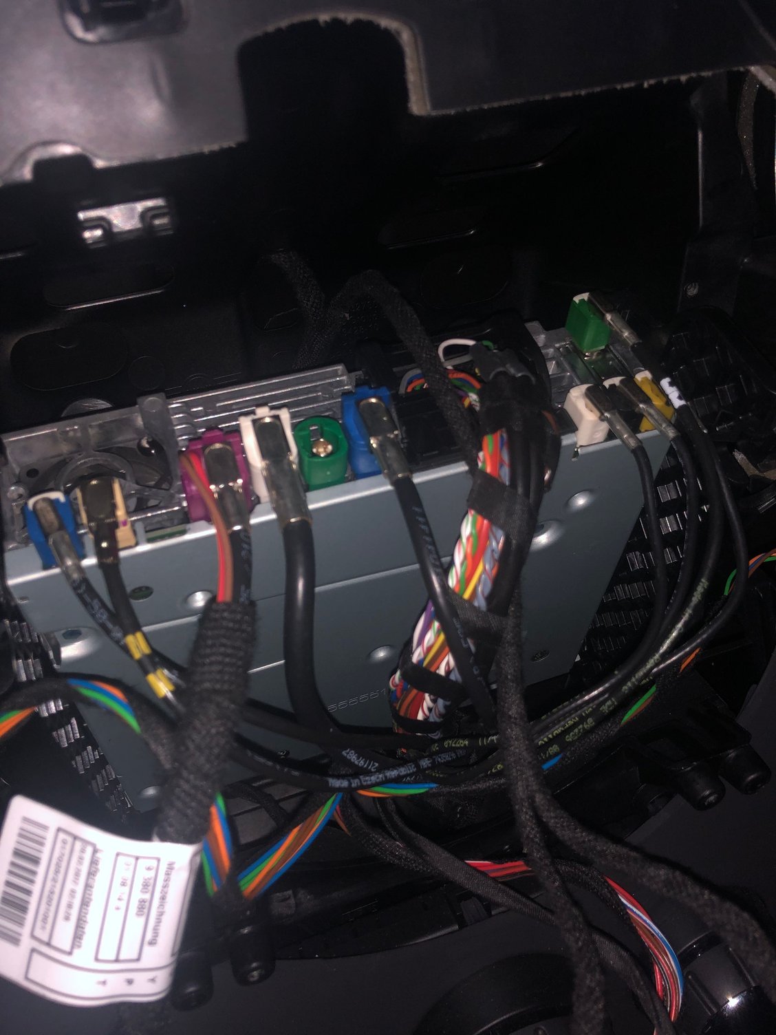

Hi Sir
I can't find "WiFi" certification logo on this head unit, so it may not be able to use Carplay.
Could you please take a picture of back panel ? I want to see all connector of this head unit.

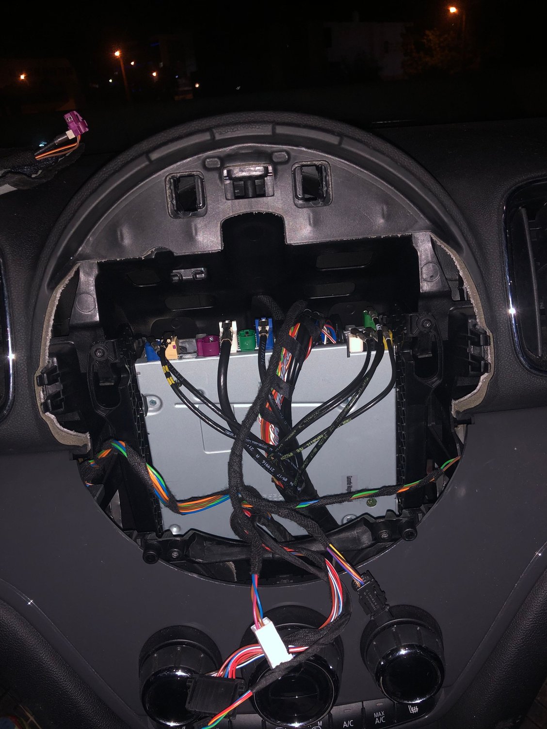

Does this help? I want to replace head unit to get carplay! Thanks very much for the help

Hi Sir
On left side, i can see GPS & BT connector. There is no WiFi Connector.
Sorry~~~

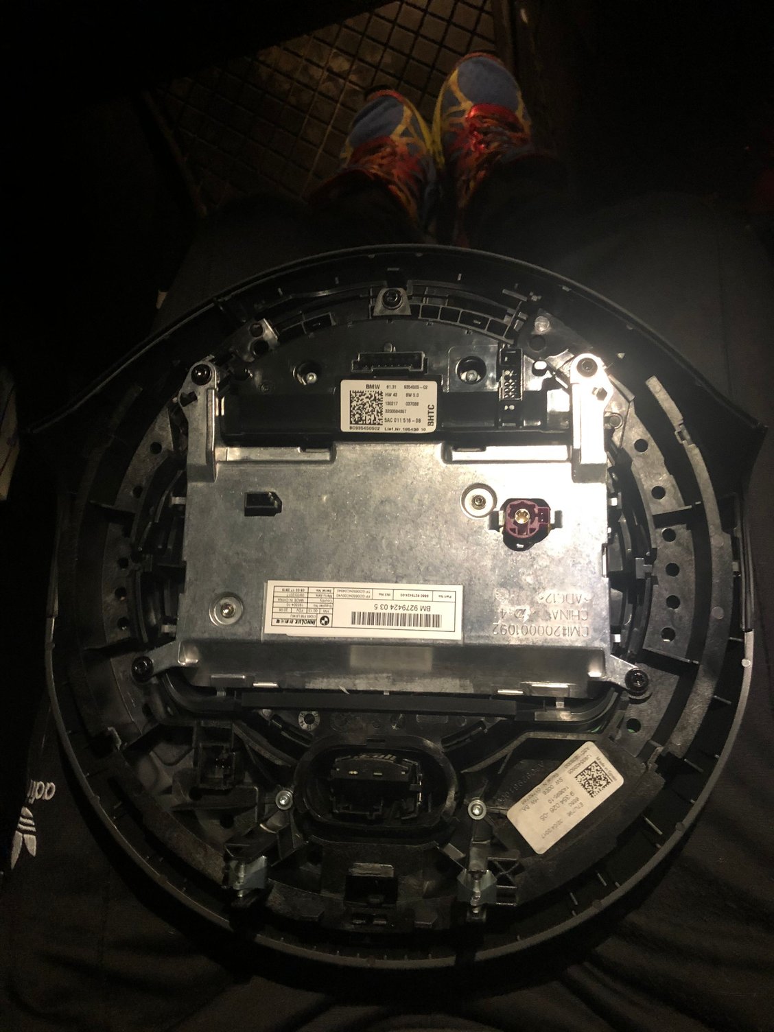

hi this is my current screen (6.5). The whole part i bought (that has the touch and central instrument iri plastic) does not seem to match to sort of clip on and screw and then to be able to insert the plastic trim. Slightly bigger based on my understanding

hi this is my current screen (6.5). The plastic frame around does not seem to match to sort of clip on and screw. Slightly bigger based on my understanding
Did you not get the CID (plastic frame) for the 8.8"? The 8.8" can't fit in the 6.5" frame.
