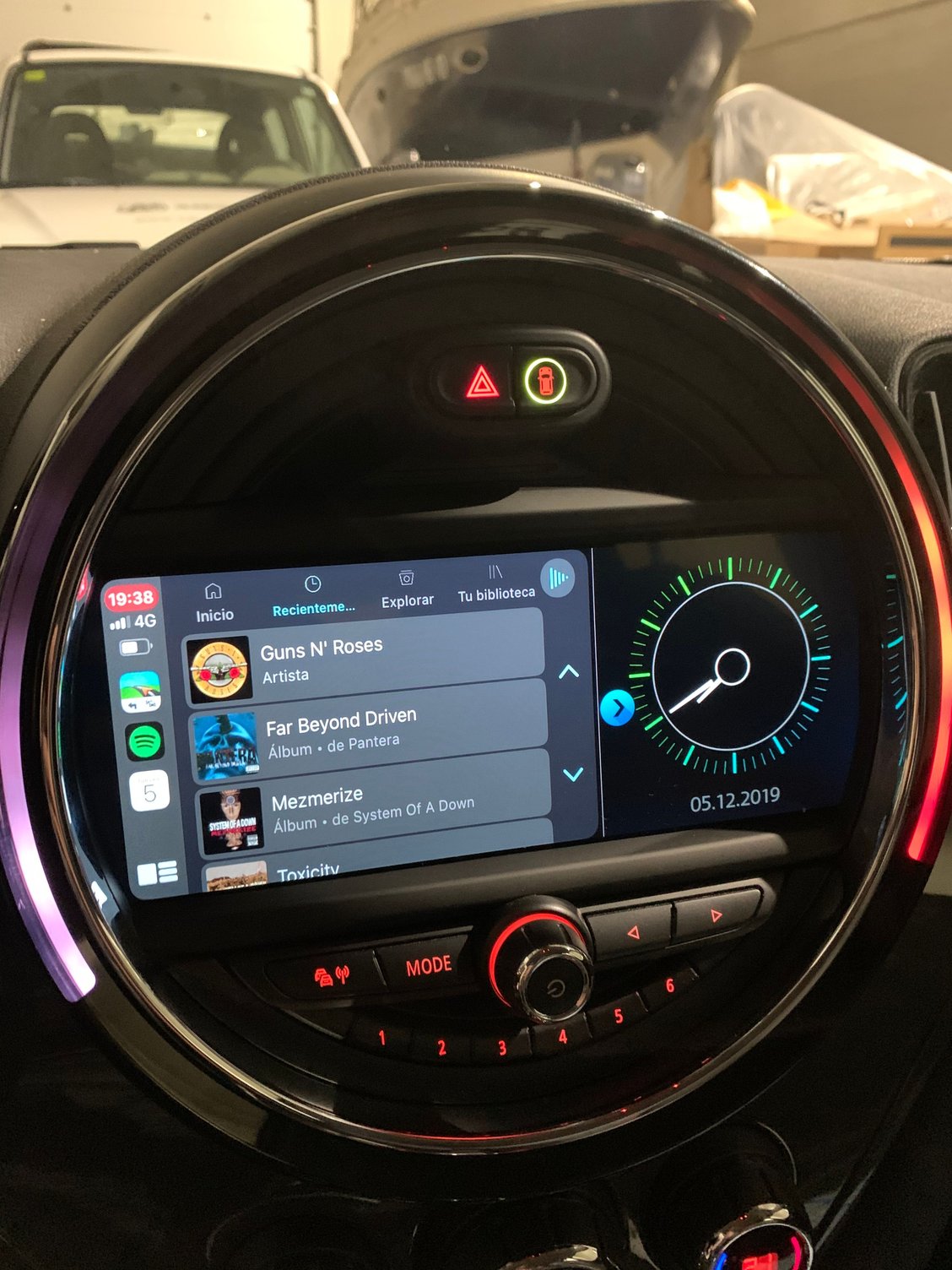

  #119
Budgett's Avatar
Budgett
Joined: Oct 2018
Posts: 21
Thanks to this post, I have updated my screen from 6.5 to 8.8 inches, everything has gone perfect, my car a countryman f60. Thank you !
Old Dec 10, 2019 | 02:04 PM
  #120
varma1986's Avatar
varma1986
Joined: Jun 2019
Posts: 195
Likes: 20
Thanks.
Can u give me a step wise walk through regarding coding.
Did U have to change the head unit as well to get the car play?.What coding does that need?.
I use an aftermarket Car play kit ti get Android connected-Wired & Apple Car Play wireless-Joye Auto Tech kit.

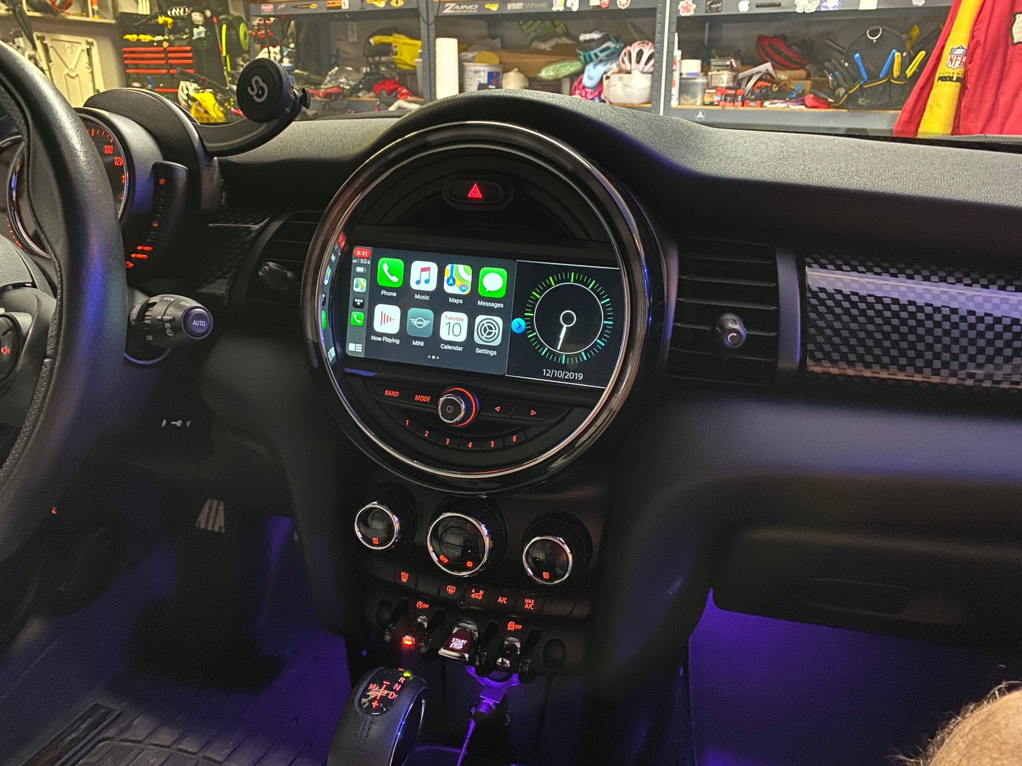

Got my daughters 2016 f56 cooper s retrofitted done. Thanks to a very nice forum member here who helped me source the parts and coding. Install was a breeze. And to the guy up a couple post asking why we are asking the same questions over and over again, if your not here to help than just don’t post anything. For some reading part numbers and trying to understand all the different nvt units is a daunting task.
