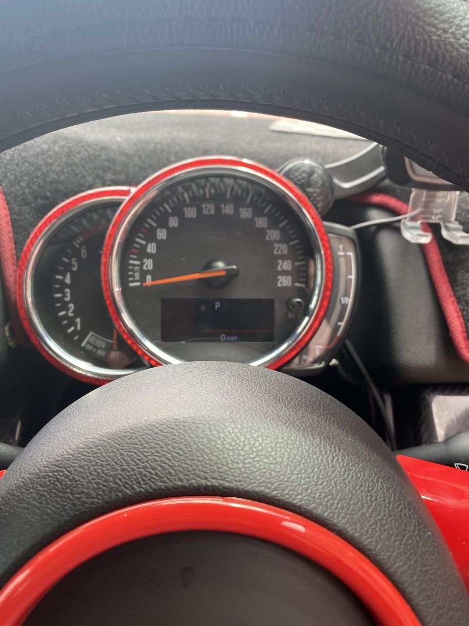

I have opened up my speedometer on my MINI cooper F60 and changed the faceplate from miles to a fancy one with kms/hr.
Everything works well, except the speedometer needle which keeps resetting to a point below the zero kms/hr label.
I have tried placing the needle at different point but each time i connect, it resets to its home point which is a few notches below the zero.
What can be done solve this problem?.
Can anyone help?.Thanks.

Can you gently pull the needle off? If so, let it go to the home point it wants, remove it, and then reattach pointing to the zero.

Thank You.That was helpful.

This looks like an idea, i will try.Thanks.
I plugged it in, when the zero fell below zero, i raised the needle to zero and it worked>i switch off and switch on the engine and the needle was back at below zero!.
I also enclosed a small video clip.
A BMW technician says, that the machine need to be coded and re calibrated using ista.
Old May 14, 2020 | 09:10 AM
  #168
varma1986's Avatar
varma1986
Joined: Jun 2019
Posts: 195
Likes: 20
Hey!. I got through!!.
Steps for disassembly for a Speedometer/Instrument cluster Mini Cooper F60.
#1-Notice 2 rubber stoppers covering the torx screws on either side of the speedometer.Remove them & unscrew the 2 torx & slide out the clock.Remove the ECU cable at the back.
#2-Three screw holding the back plate & 6 screws holding the bottom plate and both of them will come out.But the back plate has a tiny cable for the speaker connecting to the board.Unplug the speaker cable from the board, unscrew(1 screw) the board from the back plate.Both the back & bottom plastic cover will now come off.The screws are of different sizes and must remember the sequence.The threading is easy to damage due to repeated screw & unscrew.
#3-The board should now be free from the plates.The board has 2 ribbon cables connecting it to the cluster.If you can be careful you should be able to leave them alone and work your way.If you doubt, unplug the 2 ribbon cables & be safe.Both the cables are different mechanisms of being held to the board.I was able to flip the black plastic tab & remove one of the ribbon cable, did not bother with the other.
#4-There are metal clips holding the front case to the cluster.Insert guitar picks into the space of each metal clip around the cluster as you pull them back, so that they do not snap back.The front casing should pop off.
#5-The plastic clear case is held by plastic tabs around the cluster.Push down each tab and the case pops out.The display cover of the fuel gauge should also fall off.There is a black case around the gauges and that should be a easy to remove.Nothing holds the fuel guage and black casing.After removing the case use a air duster to clear the space of any particles.
#6-Do not touch/clean the speedometer faceplate with any kind of alchohol as it will remove & damage the paint on the face plate.
#7-Remove the needle by holding it gently and pulling it upward.Remove the old face plate and replace it with your new fancy plate.At this moment gently push back the needle 1/4 way into the internal spindle, do not snap it.Carry the mechanism with the ribbon cables connected to the car and plug the ECU.The ECU will reset the needle to below zero.unplug & replug to make sure the ecu reset the needle.Now gently remove the needle and place it at zero, unplug and replug the ECU cable to make sure the needle does not drop to zero.Once you are sure that the ECU understands the needle to be at Zero>remove the ECU cable.Snap the needle firmly into the clock spindle.
#8-Now recheck the position of the needle by plugging in the ECU cable.During these steps it is sufficient that the ECU cable makes a gently contact with the pins, need not snap all the way inside.Be careful that you are not damaging the ribbon cables holding the cluster to the board.You may see error messages of "Drive Terrian error" & "Outside Temp" & "Bonnet Open" during this process of adjusting the needle and you should not be worried.
#9-Now reverse back all the steps.Black casing>Fuel guage in place>snap back clear case>snap back plastic case of front>put back rear cover>connect the speaker cable to board>screw back the board to back cover>put back the bottom cover>screw everything back to normal.
#10-This is a time consuming and delicate process and one must take time.
#11-Plug back the ECU & screw it into place & put back the rubber stoppers & the project is done.The machine will ask you to reset date & time and you should be good.
Hope this helps.
