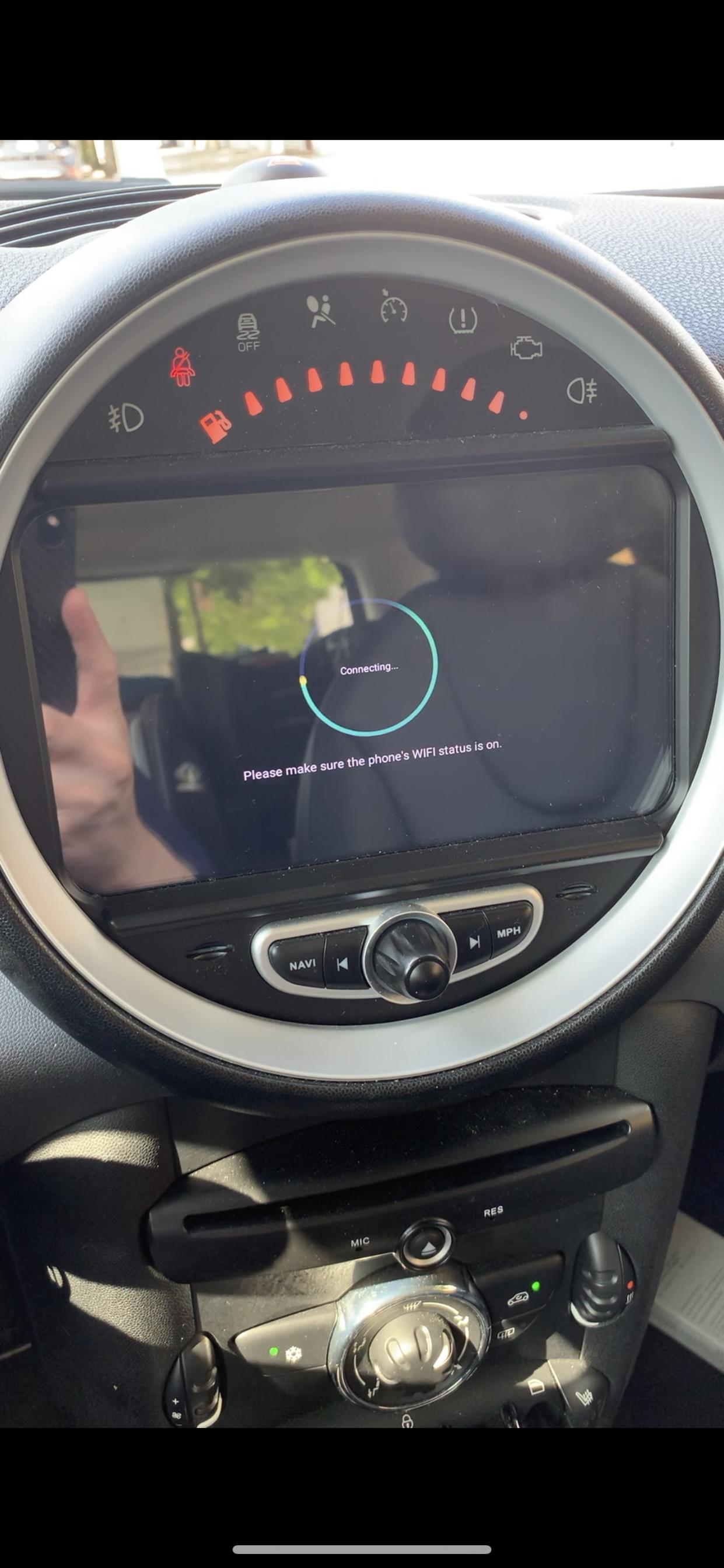

Wireless CarPlay!
Wireless Apple CarPlay!
Attached Thumbnails Aftermarket infotainment Options-585022cc-a884-43f9-9ce3-cc7c87b56b4c.png

That looks awesome howiestt! Now if only I can find that same display (without ODO around it) for the gray non-LCI radio. All the displays I have found like that are for black, LCI models. The gray non-LCI options I have found all have the ODO ring in kmph with a smaller screen. If anyone can find the larger display with the gray non-LCI setup that would be info a lot of us 2nd gen guys would cherish!
