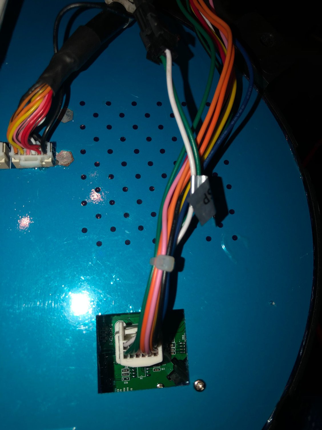

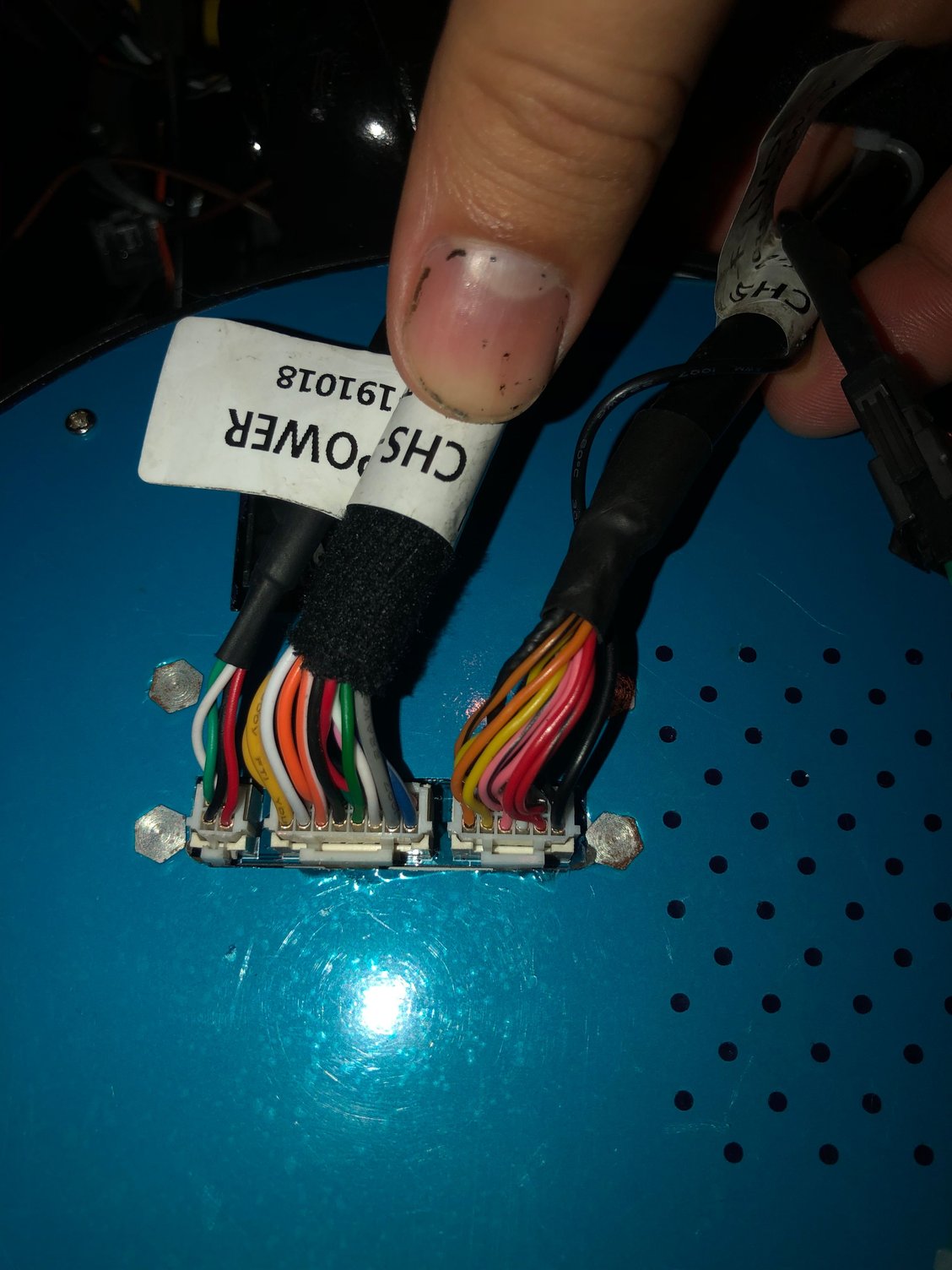

Mine has it, I belive its a blue cable becasue it says amp con I am going to add fotos, if it was it for the amplifier where should I connect it ? I've been searching but nothing comes arround

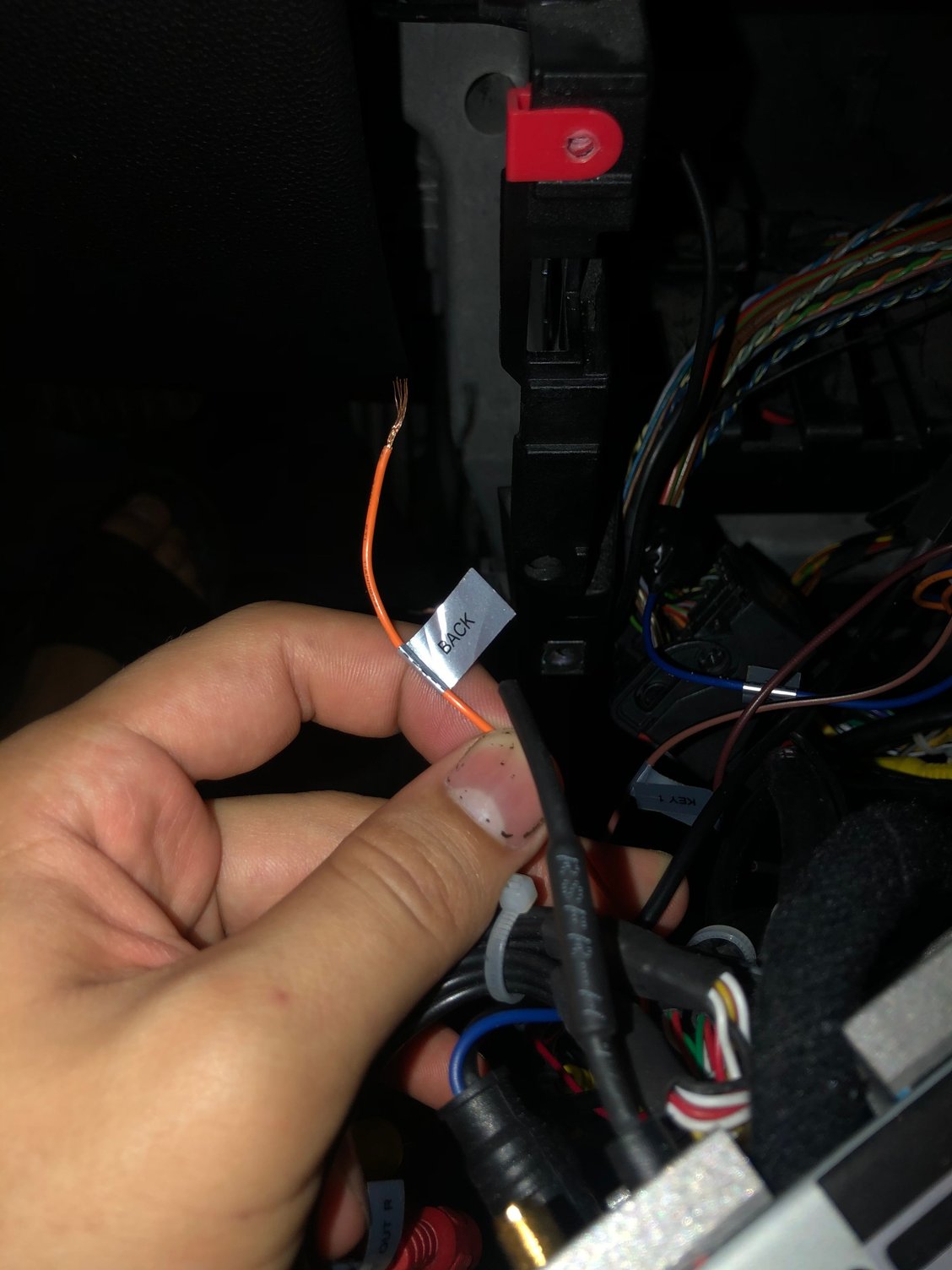

I finally managed to find the 12v signal that triggers the amp but I got new problem guys don't know what it is. When im in any gear except Reverse the screen pop some kind of danger sing, if somebody knows what is happening please let me know I would be grateful, this is the only thong that stops from putting everything together.

Something is backwards. It thinks you are in reverse and is trying to activate the backup camera. Poke around in the menus and see if you can find a setting to disable the backup camera. FWIW, I ***think*** it is an orange wire that goes from the CD player/head unit to the screen that triggers the switch to the backup camera. The head unit is supposed to detect when the car is in reverse from CANBUS and then puts 12v on the orange wire. If you have to, you can cut that wire and the splice the piece that goes to the screen to the reverse light wire on the footwell module, or if you don't have a backup camera just leave it disconnected.

I was going to cut the orange wire you are telling me but found out there where 7 of them and one is disconnected and its labeled : BACK, im posting some pics and a video about my issue sorry for bothering but this is driving me crazy and Im so grateful for your help.
Is the loose end going to the CD player? Try just grounding it and see if that helps.

thanks alot for saving me all this trouble. screen is workin fine
