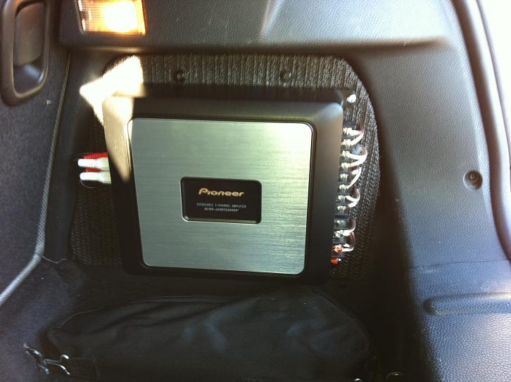

What amplifier do you have? In this case size does matter, the smaller the better. Check out my gallery pics.

yeah im afraid thats too big...too long. my pioneer is 8-7/8"L x 7-7/8"W x 2-1/4"H and my genesis is [FONT=Arial]7-1/2"L x [/FONT]10-1/4"W x 2-1/2"H and they both barely fit and still have enough room to change any blown out taillights. the boot floor is a good place or maybe underneath a seat since the amp is 1.4" thin.

I made an aluminum plate that hooks over the edge of the lip in the opening to the right side cubby thing. It screws into a bracket I made near the top and is very solid and rattle free. My amp bolts to that. Good air circulation, easy to get at if needed. AND you can still change light bulbs.
