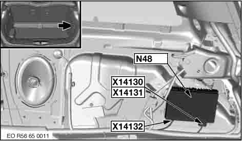

Did anyone get your R56 with the HD radio installed? Can it be installed later?
If anyone has pics of the tuner unit I would be grateful!

The HD tuner is N48 in this diagram. I don't know if a retrofit is available. It uses the same headunit as without HD.

The part number can be found here: http://www.realoem.com/bmw/showparts...69&hg=65&fg=05
However, it probably involves more work than just the tuner. The antenna and wiring might be different. The tuner connects to the MOST bus, and the harness for it may not be there from the factory. You may need programming from the dealer.

I went ahead to order the parts and did the install myself. The parts can be ordered for about $800 or so from Morristown MINI in NJ. Install is really easy and everything bolts up as it should. One thing to watch out for is to make sure you have the correct rear carpeted panel. The one to accomodate the HD tuner is the flat panel. If yours has a cubby space, then you need to swap it out. I just need to find a dealer that will program it so I can hook it up. All wiring is present. Damagi, was that Northwest MINI that quoted you $1600 for the retrofit? Were they confident that they could do the software programming?
