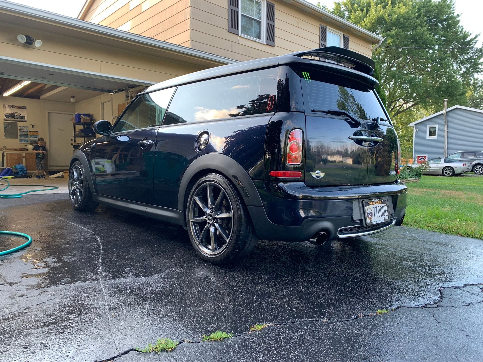

I've been asked about a build thread for my car, so here it is. I've had the car for about 4 years, so this will start as an update in her current condition.
The car is a 2012 Cooper S Clubman Hampton Edition. Here she is the day I picked her up (December 2016):
Since then, I've done the following to make her my own...
Exterior:
- Removed side "H" Hampton badges
- 30% Window tint on rear windows and sun roof
- Blackline trim around grill and headlights
- Outmotoring matte black belt line kit (removed)
- Cooper LCI side scuttles
- OEM Mini LED fog lights eBay LED Halo Fog Lights
- Cravenspeed Stubby antenna
- Smoke LED side turn signal repeaters
- Smoke LED side fender markers
- Euro LCI rear tail lights with amber turn signals
- NC3 Miata front bumper winglets
- Add-on rear spoiler extension
- LED front turn signal bulbs
- Full replacement LED tail light assembly bulbs
- "S" JCW Tuning kit grill badges
- GP2 front under tray
- Red Carbon gas lid cover
- LED D1S plug-in bulbs

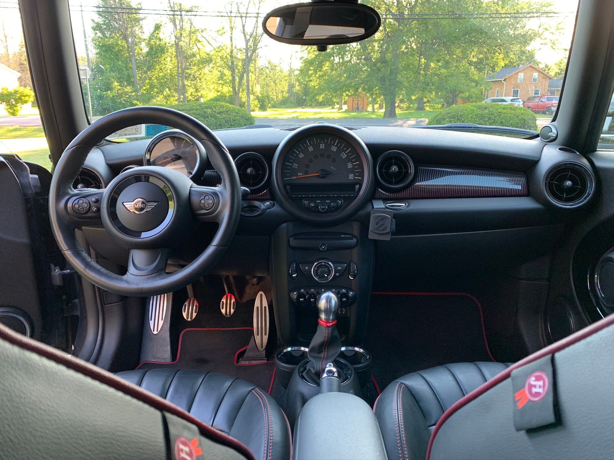

Interior:
- JCW dealer accessory steering wheel
- Proclip dashboard phone mount
- Autometer ES mechanical boost/vacuum gauge in Alta MiniCooper 3D gauge mount
- Raceseng Contour Signature shift **** with shift boot trim ring
- GP2 Shift Boot and ****
- R56 side triangle cargo nets

If picture look correct you have the S clubby spoiler instead of the JCW clubby spoiler right? If so, how did you get it adhered? Auto adhesive paste or bolted?
Old Aug 3, 2020 | 01:57 PM
njaremka's Avatar
njaremka
Alliance Member
Community Builder
Community Influencer
Joined: Jul 2016
Posts: 7,555
Likes: 2,511
From: WNY
Yes, it has the smaller Clubman rear spoiler. It was factory installed, so its bolted on.
