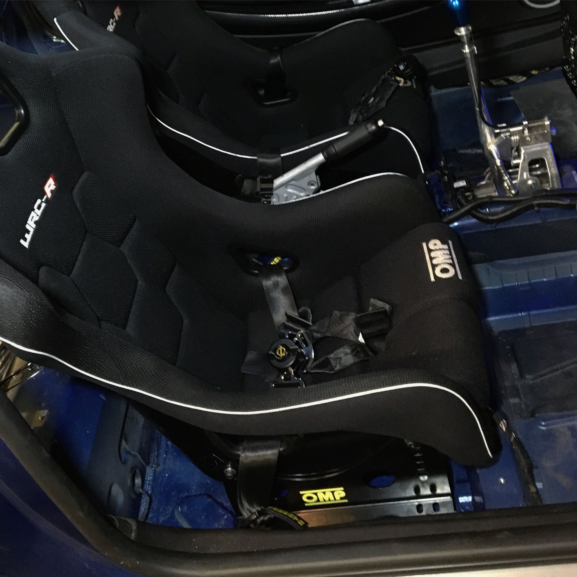

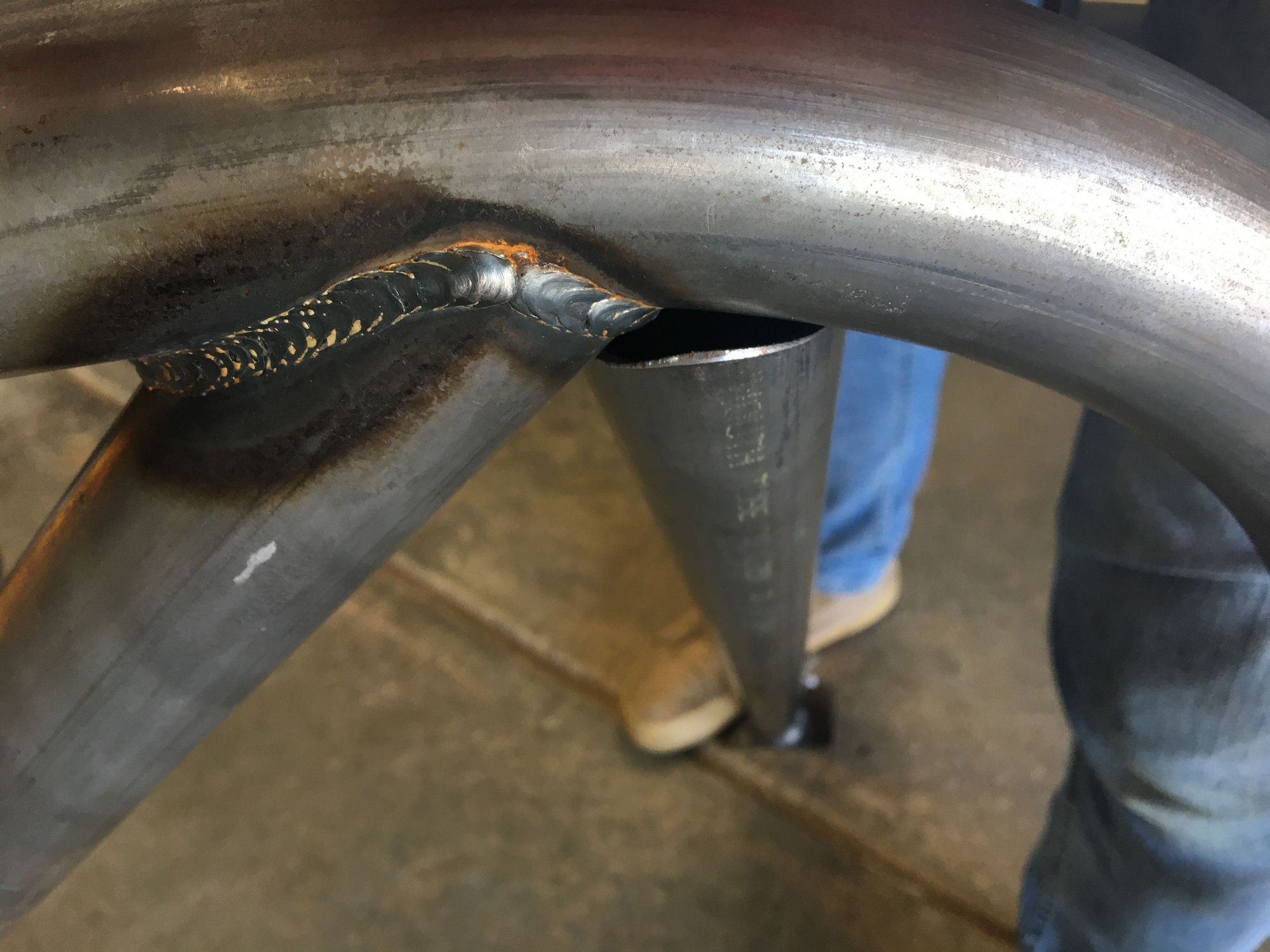

Minor update. I DIY'd some seat mounts. This is my first time welding, so I'm happy with the result.
Not bad for a new guy.
The seats are in and the anti-sub belt and lap belts are anchored. With my helmet on,I have about 3" of head room. Now I'm just waiting on the roll bar from Sneed Speed. [rant] I placed my order on the 21st. Before ordering I called to get an estimate on when the roll bar would be shipped. I was told probably Friday, but Monday at the latest. Well, It's Wednesday. I called again today and was again told "Friday, but Monday at the latest." I'm a less than a "Friday, but Monday at the latest" away from cancelling the order. I don't even want to talk about what a pain in the *** it has been to even get someone over there to answer a phone. Or the ignored email when I requested measurements to ensure the shoulder harness would be at the correct angle. When I expressed concern that the the shoulder harness would be above horizontal, it was brushed off with "we've never had a problem, if it doesn't fit, you can send it back." [/rant]
Well,
1. I'm not going to ship a 4 point roll cage back because you could not be bothered to take a measurement or adjust the harness bar height to work in my application.
2. I'm pretty sure these seats are mounted 3" lower than of your other customers.
I should have just ordered one through Bethania Garage or rollcagecomponents.com. Lesson learned.

Was that stick welding?
It looks good from the top. Did you do a test run and cut it in half to see the penetration you got?
Sorry to hear about Sneed. If they do send it, and the harness bar is too high, do your own mod. As long as the bar in general fits, that would be minor fix. Do you have a “Metal Supermarket” near you? They have what you would use. Likely there are bends in the harness bar that Sneed sends you. Carefully grind out the welds of the bar and likely you can just move it without any added metal. But if not, that would be the place to get a piece of tube.
If I remember, you got the G-lock pads. Have you bedded them in yet?

I cut one of the practice pieces and felt pretty good about it.
