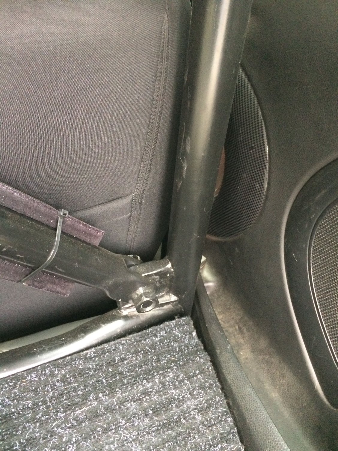

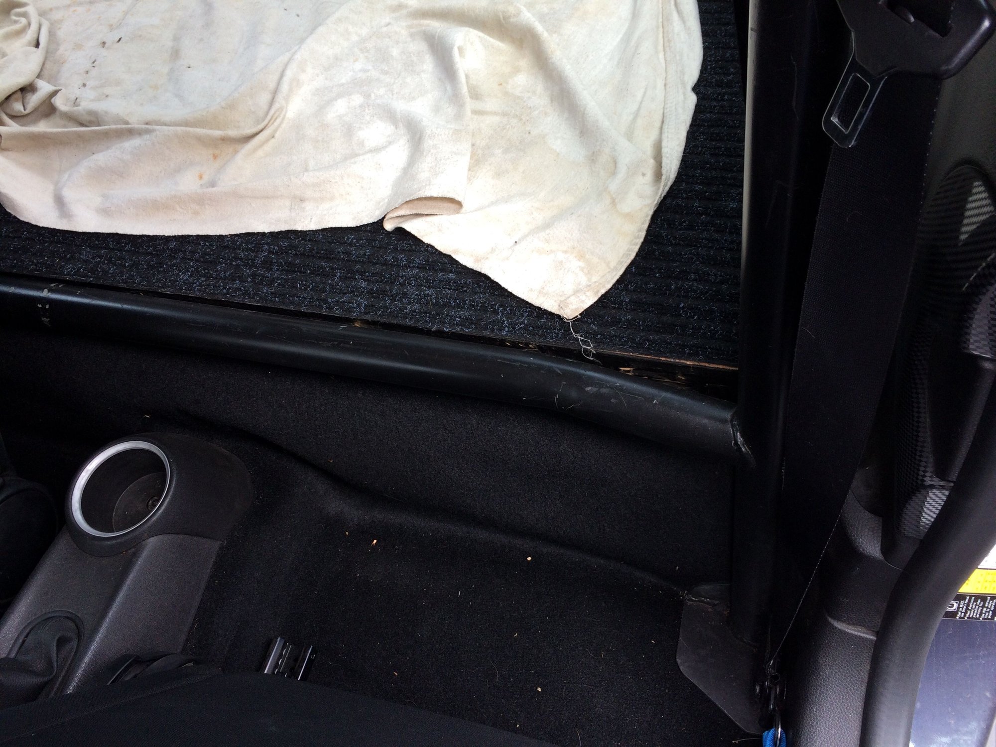

R56 MCS Removable Roll Bar

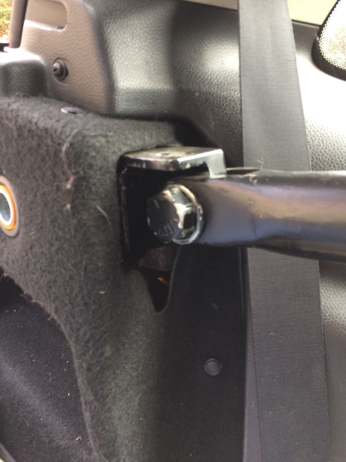

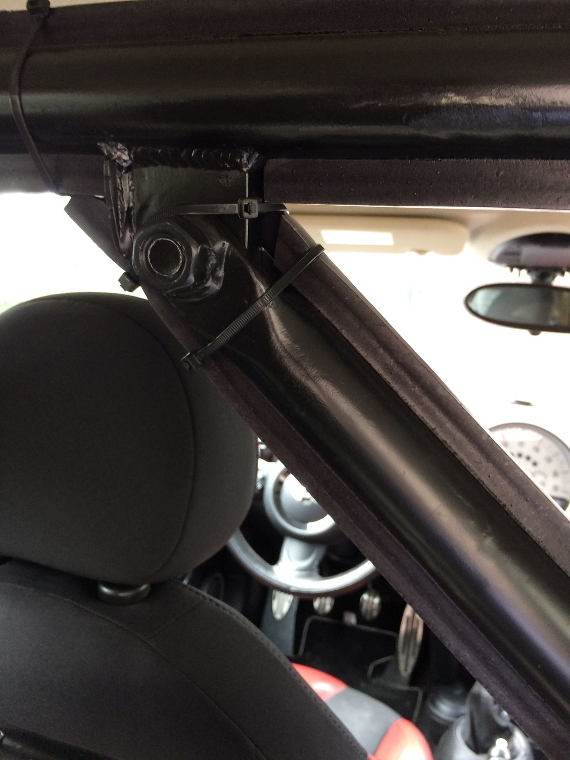

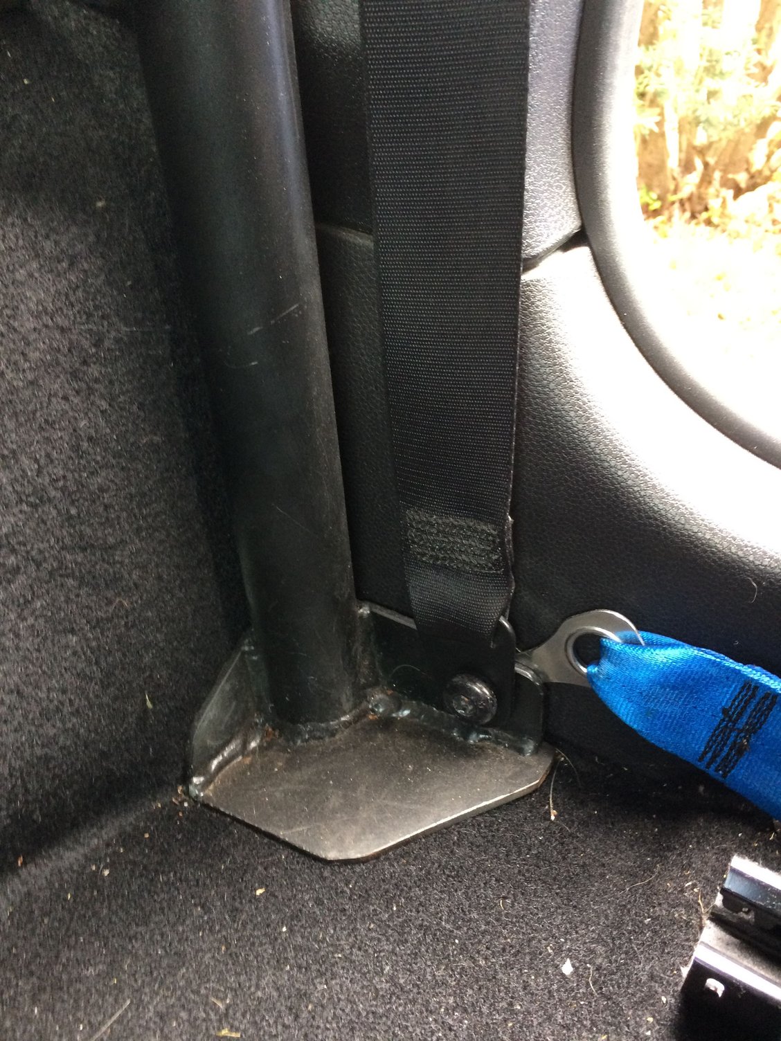

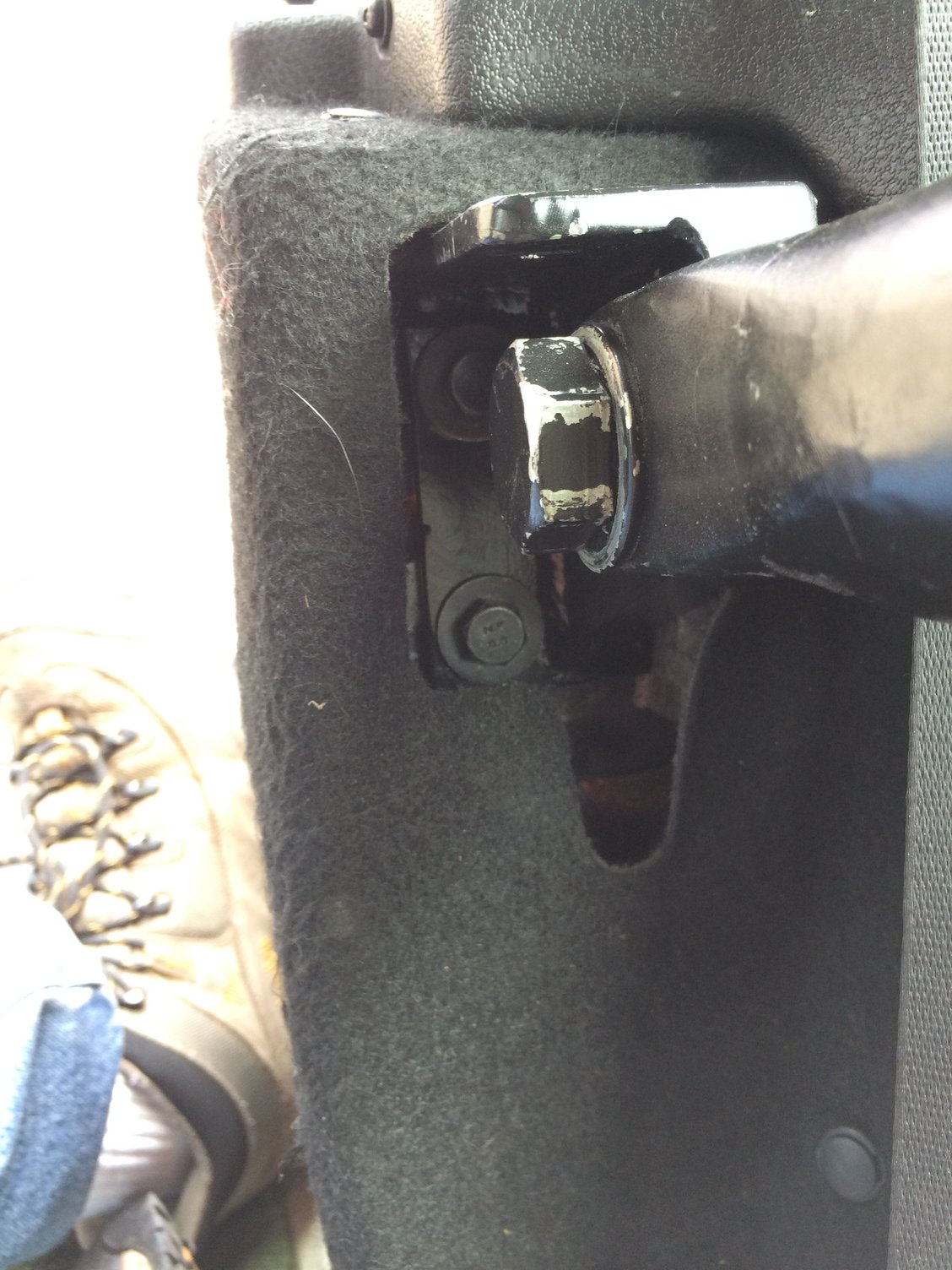

Here you go. A friend and I designed this and his cousin (who builds and races modifieds) actually built it. This can be fully disassemble in about 20 min and removed. There are no extra holes put into the car. I think it can be easily adapted to R50/53. The bolted connections are all 1/2” clevis (not sure if I spelled that correctly) joints that accept 1/2” steel plate and I think all of the bolts are 5/8” grade 8s. The “U” shaped clevis piece can be bought on line (sorry, don’t remember where). Also note that the upper part of the roll bar is covered in roll bar padding. That is what gives it the overly thick look.
The overall roll bar:
Roll bar installed. Note all of the clevis joints.
Diagonal bar upper mount
Diagonal bar lower mount on passenger side at the joint between the roll bar and lower cross bar
Lower cross bar, driver’s side.
Rear brace, roll bar mount and harness bar mount, passenger side
The fore/aft brace bars mount to the rear seat latch locations. Note the extra hole in the top of the mount. This is for a cross brace to stiffen the car further. The roll bar actually stiffens the car a lot.
Rear brace, wheel wheel, backseat mount
Closeup of the rear seat mount and Rear brace
Lower mount for the roll bar. Uses the seat belt mount to retain it in place. The hole in the roll bar plate is large enough to allow the carpet to compress in a rollover and not shear off the seat belt bolt.
This is where the design would need to be modified for a R50/53. On the R56 the seat belt is mounted to the car’s side rail, whereas in the R50/53 the seatbelt mount is into the floor. You will need to figure out how to use that. I think just make that bottom plate larger, so it can be captured by the seatbelt bolt. Make it even larger so you can also capture it with the seat bolt.
Also note that the lower end of the roll bar is made to fit snuggly in that pocket. It uses the car side rail in that location to brace it for side loading as the car rolls. This is also the main reason for having that lower support bar, which would not be in a regular roll bar mounting.

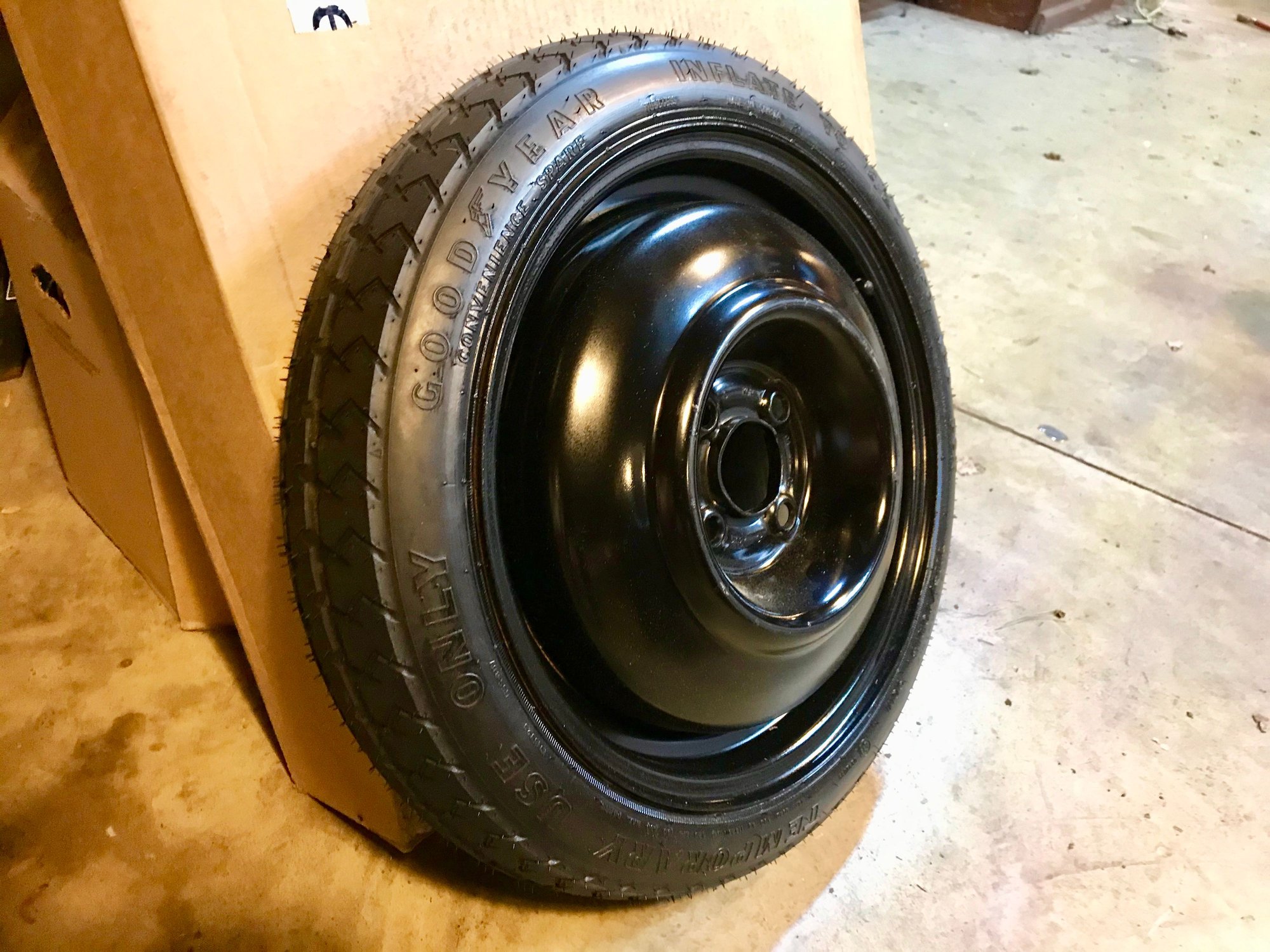

So in a "Covid Moment", I ordered the "Auto Power Street Roll Bar". I got the Mini spare and holding it up into place I'm pretty sure it's doable.
There's not a snowballs chance in hell I'll be racing "Blue Car" so the street bar will look cool and be a good mount for the spare. That's about it.
I "think" If I get a flat on the front, a rear tire will need to be moved the the front and the spare used on the rear only, so to accomplish that, a jack stand will need to be added to the kit.

No jack stand really needed, Rob. Just change the spare onto the rear first, then the good rear on in place of the flat front. Honestly the donut will work fine on the front as long as it's properly inflated and you don't drive like a moron.

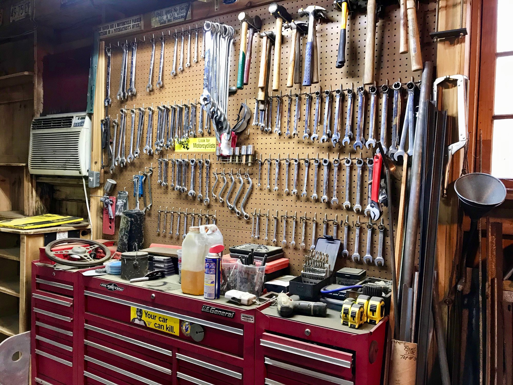

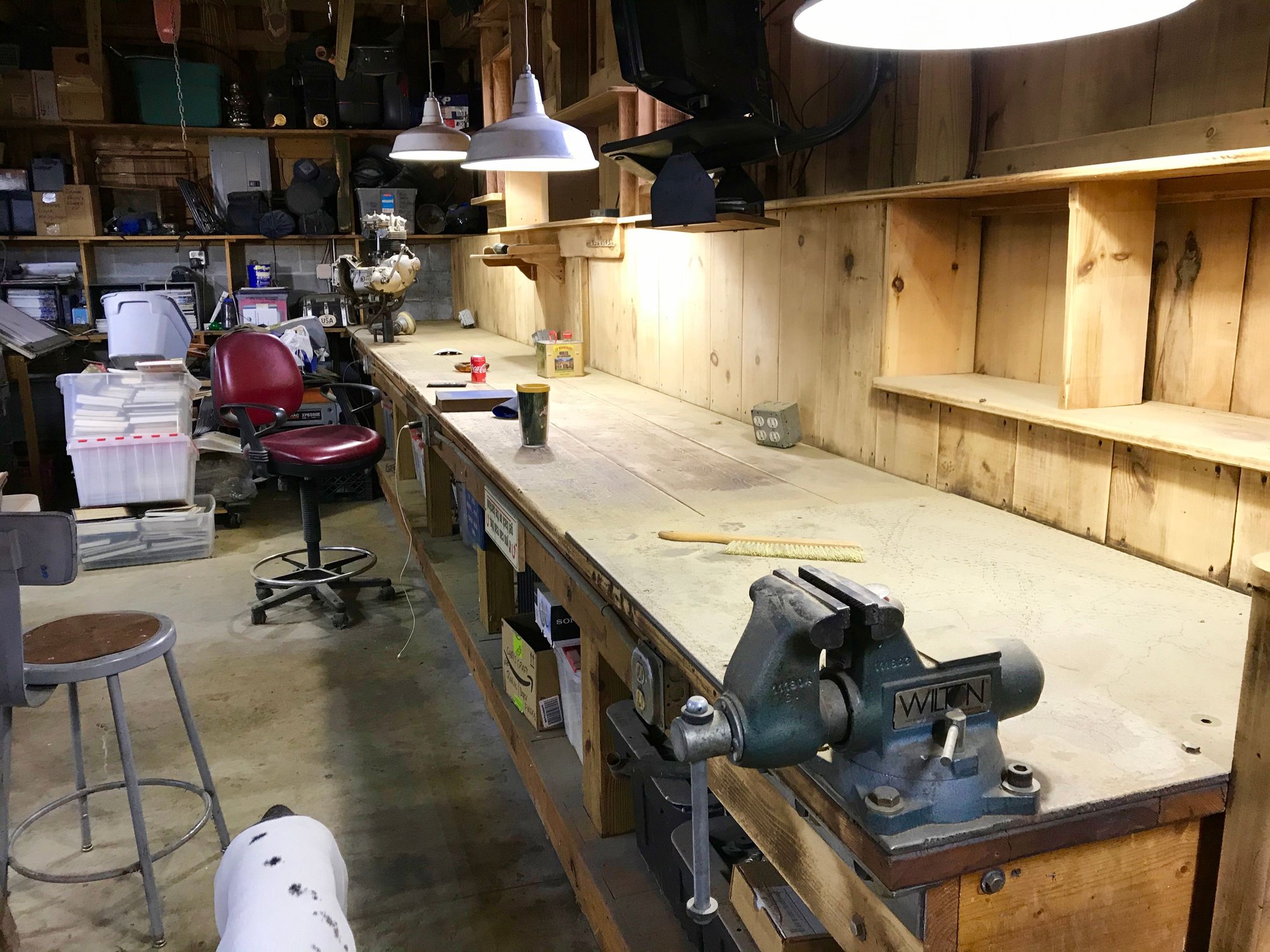

Apologies to my vast audience [Ha!] for the lack of Mini posts. When the general shutdown was announced in Maryland I moved all my tools from the Boatshed back to the shop at the house. The problem was the shop at the house had been pretty much ignored for the past 2 years while working on the boat. [The Mini was "supposed" to be a brief diversion from the boat, another Ha!]
The shop was already filled with 30 years of "stuff". Some good, some not so much, along with various projects, some done [few] some "works in progress, [many]. Mostly motorcycles [around 8] and Jeep stuff [2].
So I really bit the bullet and decided to clean things out. Easier said than done. The general rule was, "If I haven't touched it in 10 years it goes".
So far I've filled a dumpster and have quite a pile of metal a buddy is going to scrap. Along with 2-3 good sized fires for any wood stuff.
Even with all of that I'm maybe 1/3 done. My kids should be thanking me.
Not Mini related but some photos of my task.
Full dumpster and a growing pile of scrap. The dumpster is coming back for a second round.
Tractor shed somewhat organized. Still more to go. Who knew you could actually get a tractor inside a tractor shed?
Waaaay TMS!
Yep, there's more.
Engines. VW, SBC, SBF. '77 Triumph under the blue cover. Plus not one but two 6 cylinder. Jeep engines.
Everything off the workbench. Top of bench and the wall behind sanded and ready for varnish. [When I built it I never coated it and it was really scuzzy]
Various shop manuals that were on the shelves. Thinned the books out by about 3 storage boxes worth.
Tools a little more organized but a ways to go.
Looking better. Ran out of varnish, [Linseed Oil Varnish] Top of the bench needs another coat. Remaining shop manuals organized.
Rebuilt engine that's "supposed' to be in the Triumph...
Before sanding shot of the best "shop dog" ever.
Sleeping on the workbench while I was sanding it. Nothing fazes her!
Making old furniture no one wanted disappear...
So that's what I've been doing instead of having fun working on the Mini. As for the projects, I thought I would be retired a few years ago and would have some chance of getting "caught-up". Now I'm going to need to live to be a 100!
