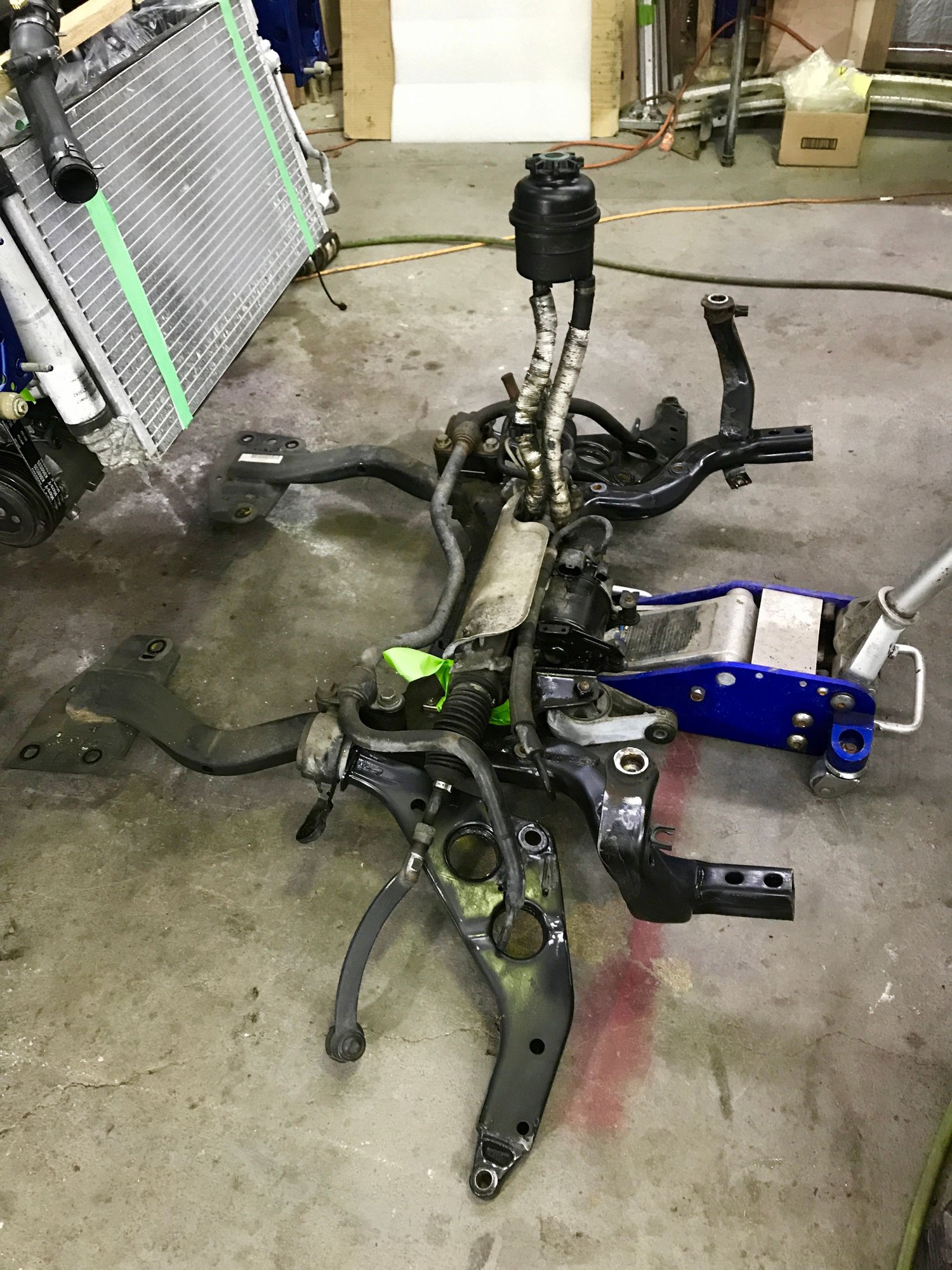

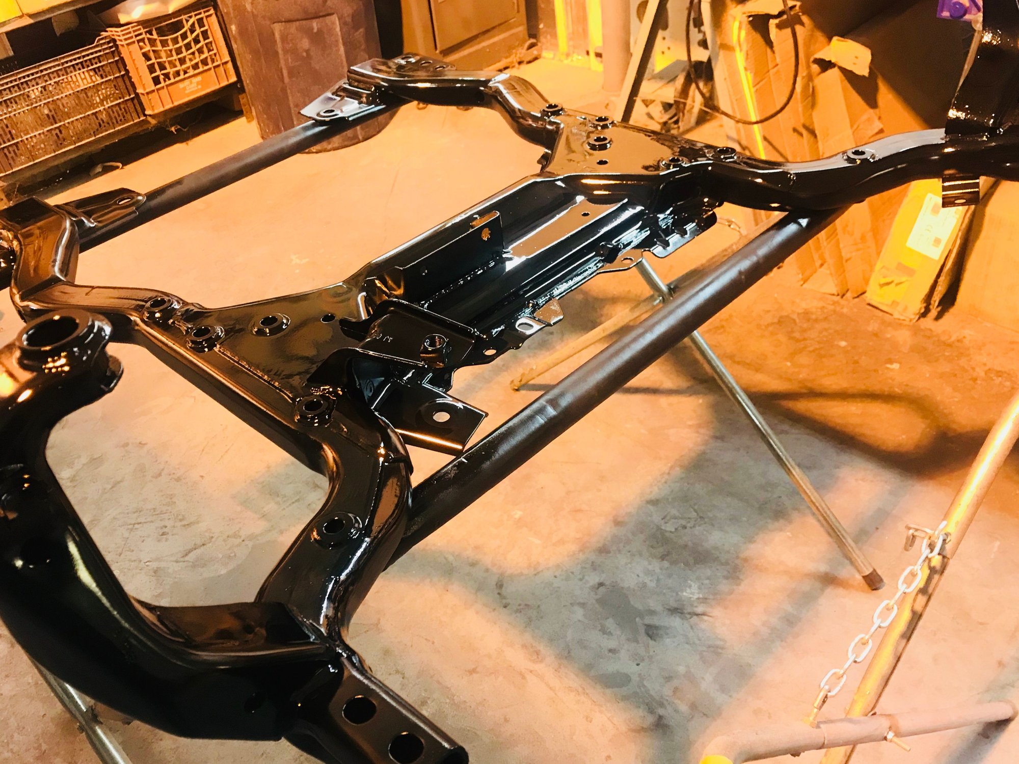

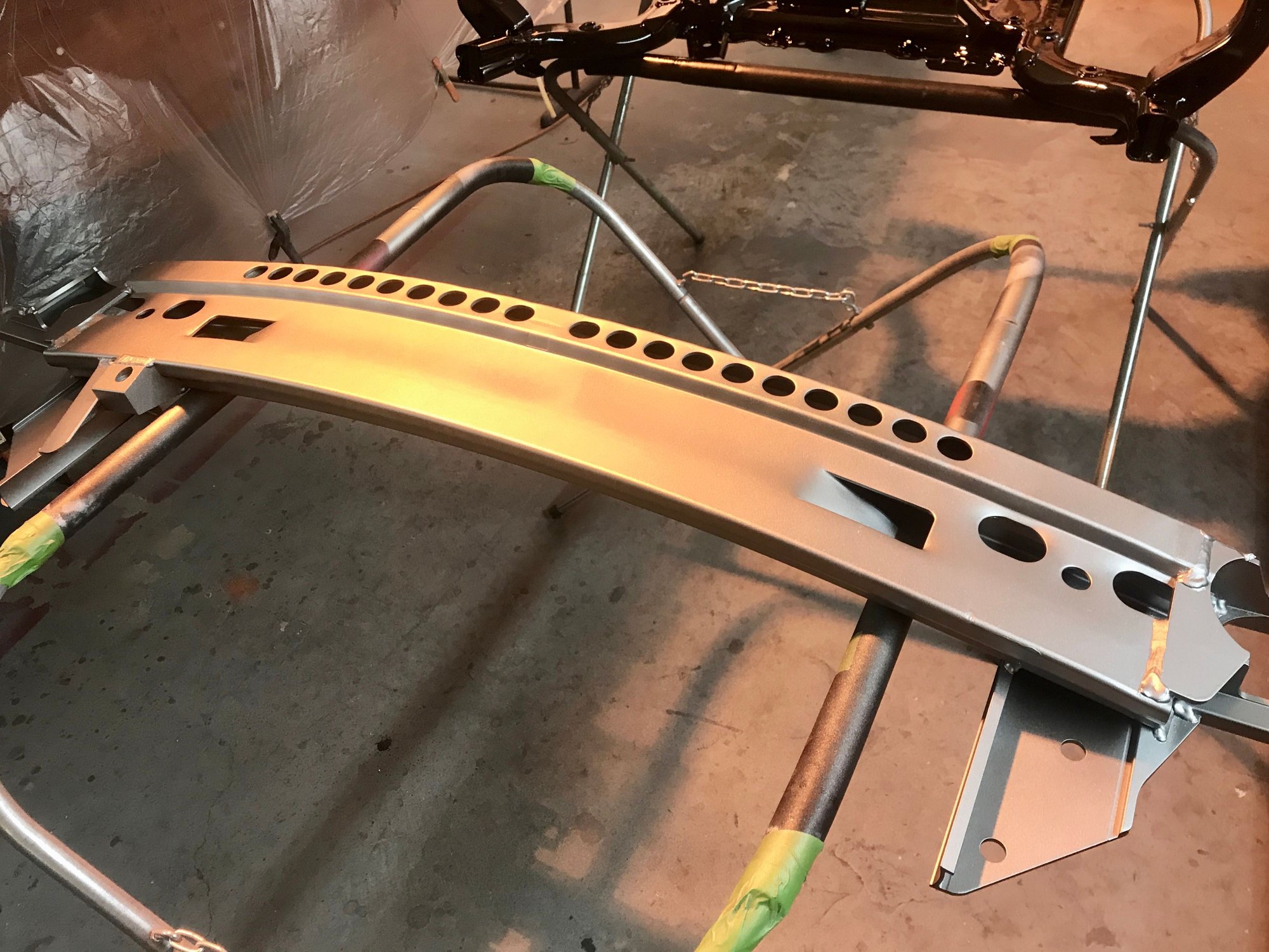

Subframe and Bumper Carrier
While the subframe was out, what the heck, I've cleaned and painted everything that would stand still long enough, so why not?
Plus my buddy was going to sandblast it for two 30 packs.
And as the Bumper Carrier was just sitting there looking scuzzy, AND jealous, that got it too. After sandblasting the first step was, just say "NO" to weld splatter. When are these robots going back to trade school to learn how to weld properly?
I think the subframe is going to have to harden up for 2-3 days, but I've got the second LCA to get back together and the struts to paint and assemble, and the hoses to go on the rack and pinion so there's a few things to keep me busy.
Subframe, Eastwood Chassis Black
Bumper Carrier, Por-15 Stainless Detail Paint
Robj
Just say "No" to weld splatter. [I mean it was right there...]
All Shiny! The guy I run over will appreciate my work I'm sure.
Because everyone will see this right?

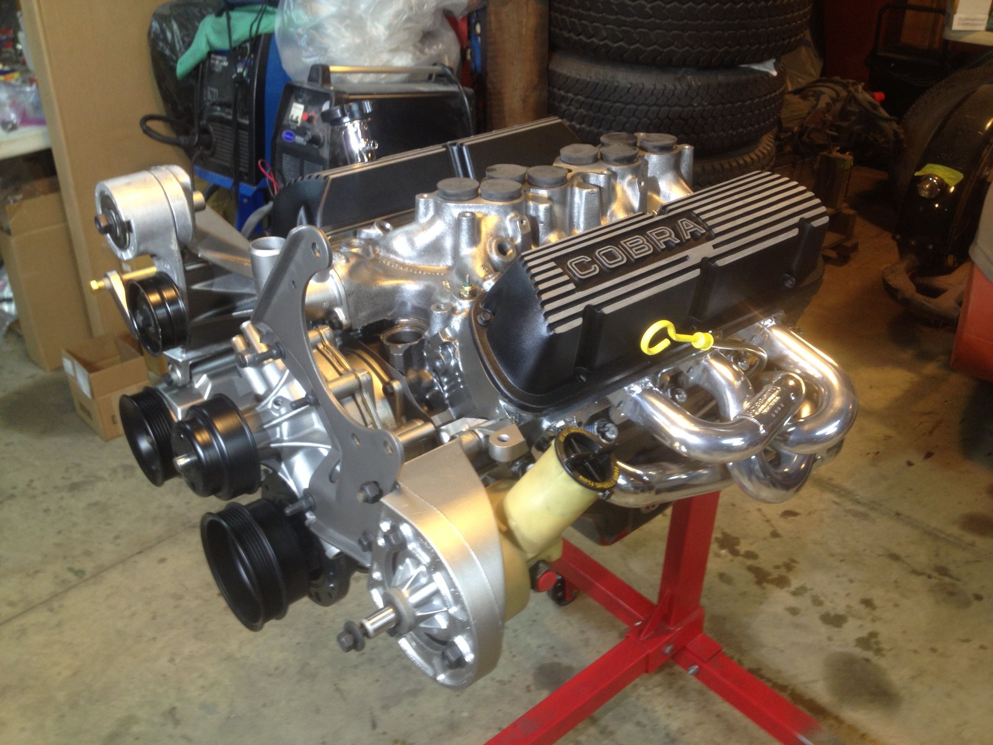

Husky,
As a Mustang guy you might like this, 93 Cobra engine out cleaned up and waiting on getting the engine bay painted. It was my daily driver for about 10 years.
Another project in waiting.

Originally Posted by robj
Husky,
robj
Very nice--and CLEAN!
I'll have to post some pics of my 5.0 some day. Not quite as clean as yours though. For some reason the site won't let me right now...

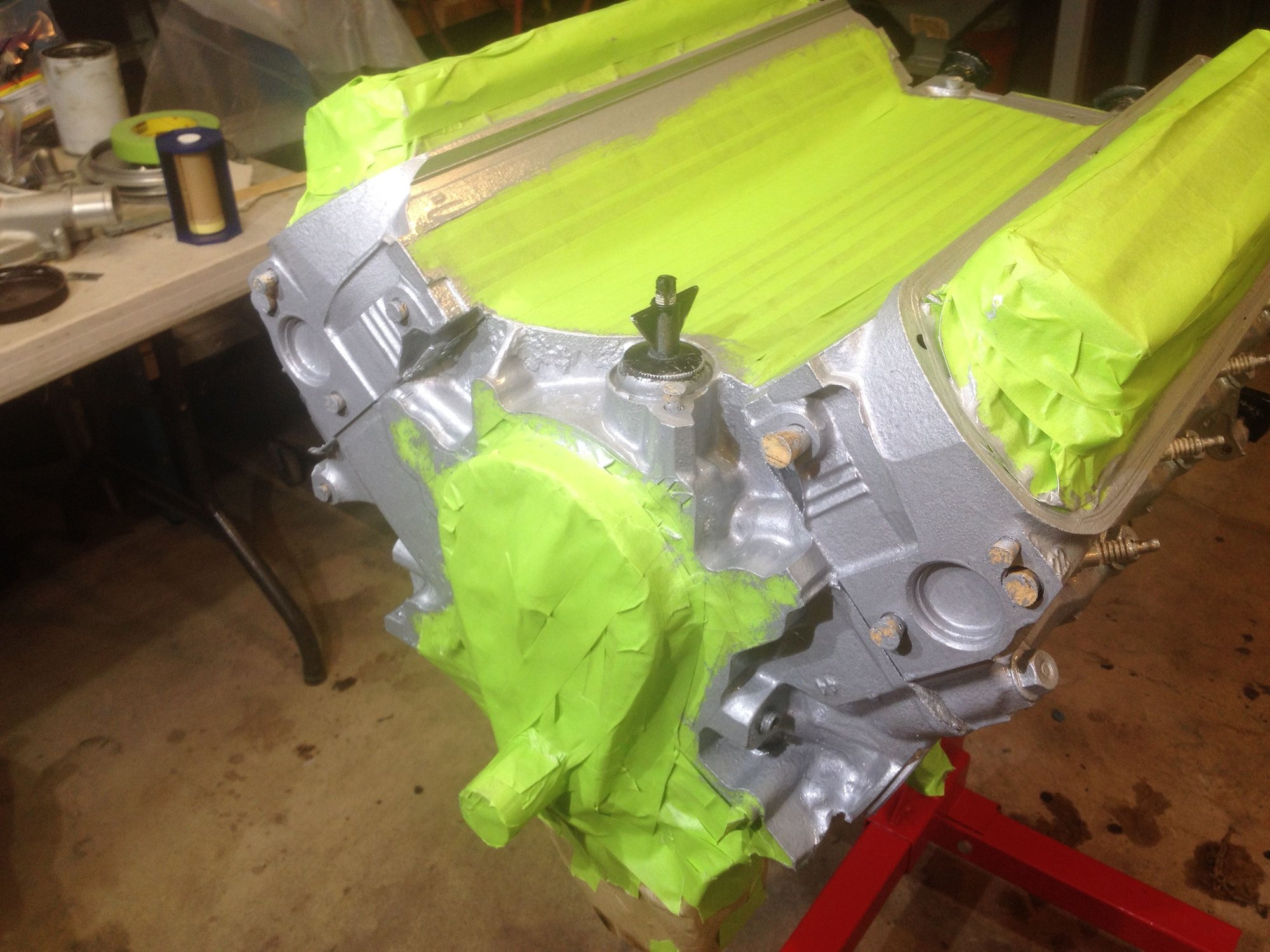

That all started as it was a daily driver for 10years and the engine compartment got really scuzzy. I pulled the motor to repaint that then realized the motor looked just as scuzzy.
In that era they didn't paint the engine blocks, just left them cast iron which of course rusted.
I ended up stripping it down and treating the block then painted it with "cast iron look" paint. [photo is the Por-15 before the cast iron paint.
A guy said "that's not original it should be rusty". I gave him my best "bite me" look...

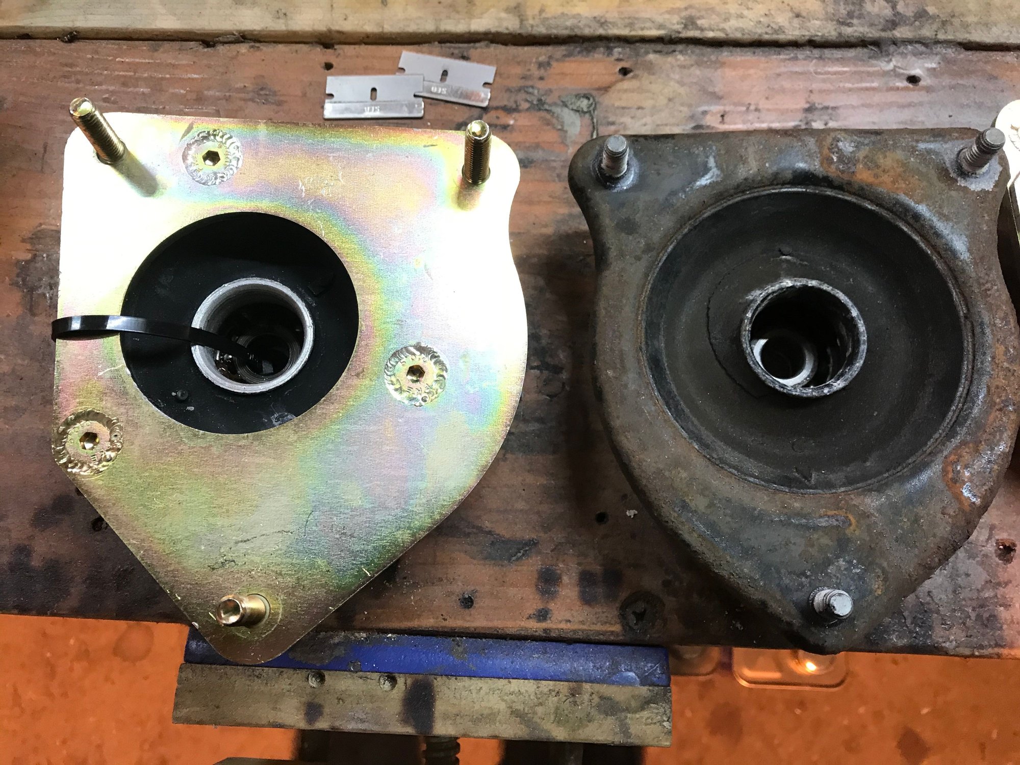

Husky,
Thanks so much for the tip regarding the "Ireland Engineering" plates. Pelican parts did take the return for the OEM parts and the Ireland Engineering parts appear much more robust. And were maybe only $25 more than OEM!
Hard to believe a problem area such as this didn't show up in pre-production testing. Or maybe it did and they said "so what".
Anyway, thanks again.
robj

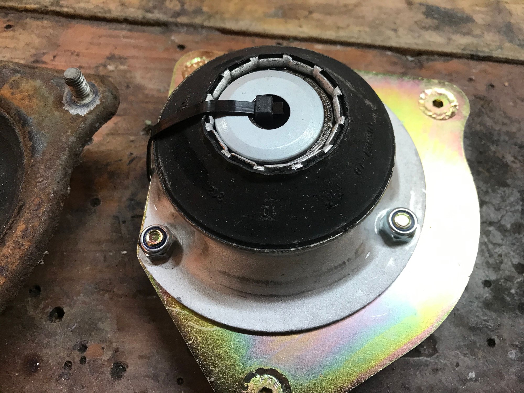

Strut ****
Turned out nice if I have to say so myself. I do have to go back to my friends shop and pop one back in the spring compressor as one of the lower cushions shifted a little.
Oh well.
rj
Oh well.
rj
Glad I could help with the camber plates. Don't forget you'll need a new alignment!

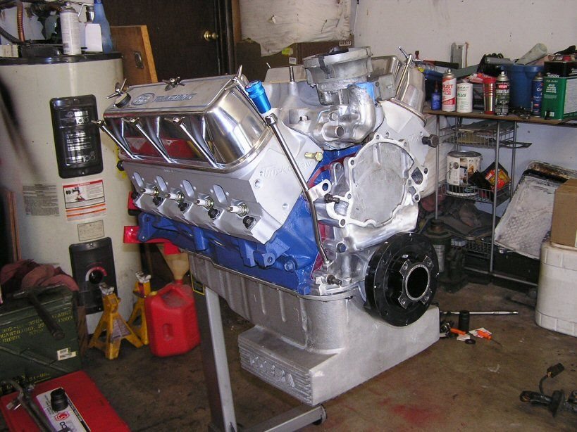

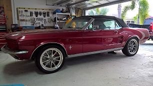

Here's pics of my Mustang motor. This was after we first rebuilt it. Since it's going in a 67, I painted the block Ford Blue. Shouldn't have done that--it looks funny once installed, but didn't realize it until much later in the game.
Here it is in its new engine bay. Definitely not as clean as your work, but most of the time the hood will be hiding it.
Here's a pic of the car. Putting EFI in a 67 is easier than it used to be, but it's still not for the faint of heart. This is what I'm supposed to be working on instead of working on the Mini. Your posts have been inspiring me to get back out in the garage and get to work!

Well that there is one serious looking piece of gear! I wouldn't worry too much about the fine points of detailing there, all anyone will see is taillights!
Nice to see I'm not the only one with more than project going!

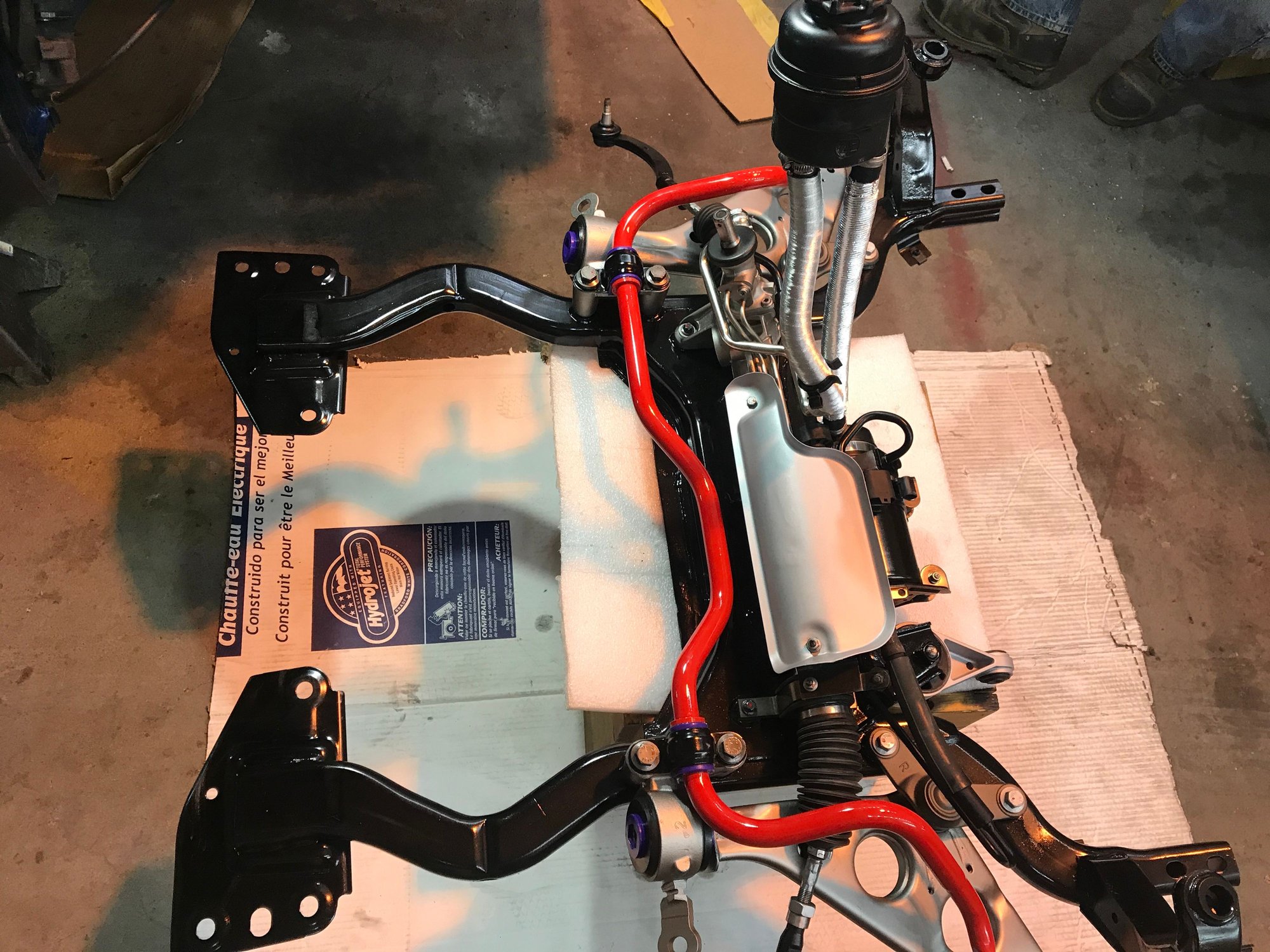

Sub-Frame; Before and After
Getting closer...
Before, Pretty Crusty...
Much better...
Another view of "Purdy"...

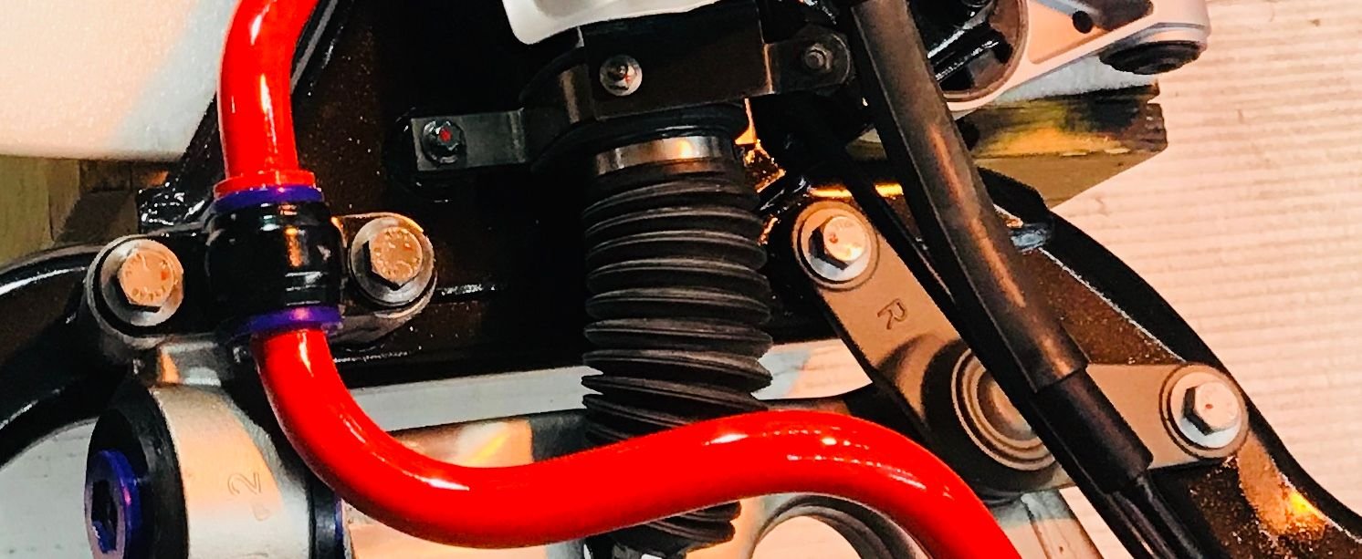

Build Hint - Torque
It might be a little hard to see but I've gotten into the habit of putting a dot of paint, [color immaterial] on every fastener after it's been torqued to the correct value. I do it right away after bolting each item on so I don't have to recheck it later.
You can then tell at a glance that it's been done and keeps you from missing things. [I use a toothpick]
It's a little hard to see but there's a tiny red dot on each fastener that's been torqued.
