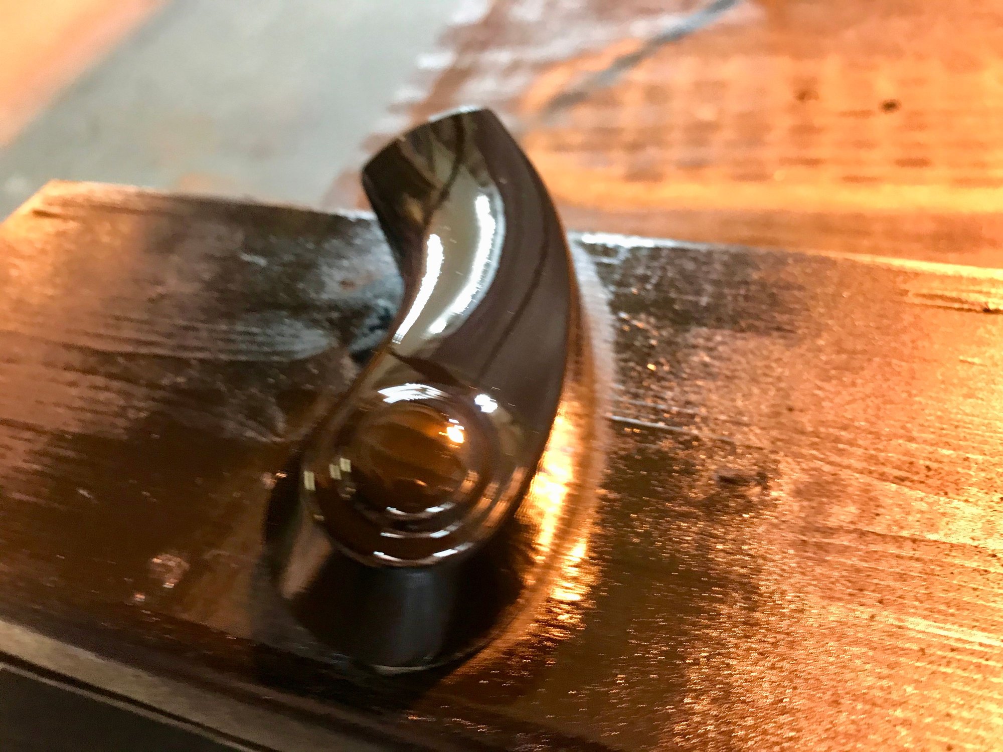

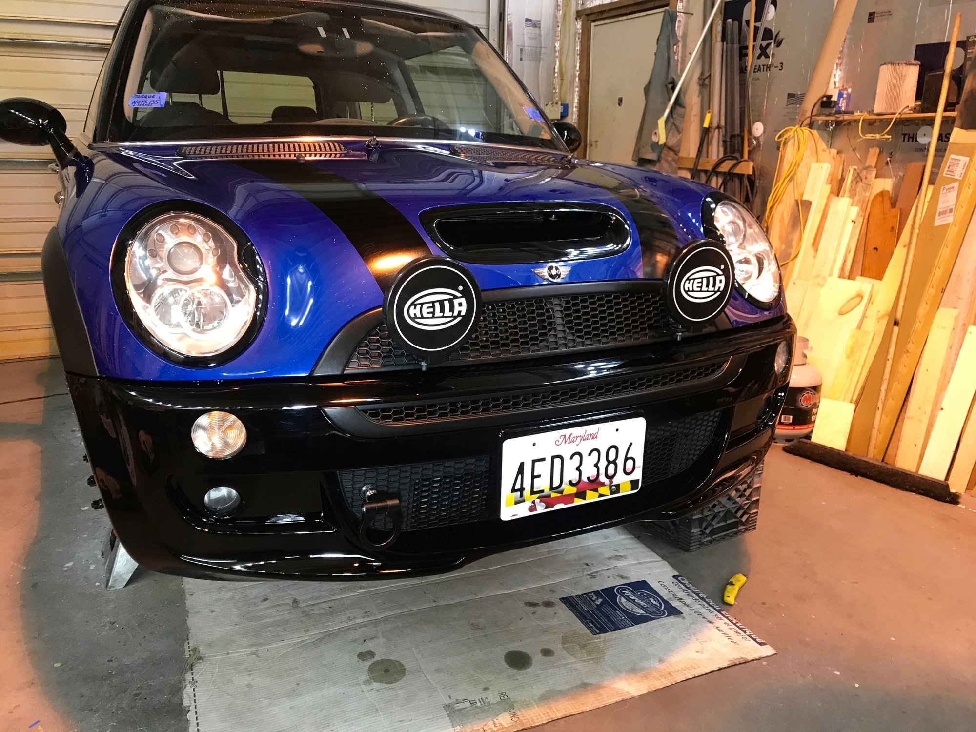

So, I almost never subject my self to deadlines. and if it's a quickie deadline, like an appointment, I leave really early so I'm not rushed.
I'm at the stage of life where this isn't terribly difficult. Kids are grown, have kids of their own, decent jobs, etc...To be honest, at 68, I'm in the very best part of life. [believe it or not- what is it? Youth is wasted on the young?
So of course I'm breaking my own rule. My brother-in-law that owns a small body shop where he does most of the actual work himself is having his 70th birthday party on Saturday, One of the hardest working guys I know.
For some reason that I can't fully explain, I find it important to be able to drive the Mini to his house for his birthday. Probably as he's "been there, done that and will appreciate the work involved.
So, progress.
Got the bumper cover on and it looks ok. Gaps are "decent". Not perfect but decent. plus or minus 1/16". Close enough.
Got the hood scoop and the inner part on, [after a bit of fiddling]
Got the plastic mesh, [or whatever] at the base of the W/S installed.
Sanded and painted the wiper blades, [gloss black-why not?] It may take 2-3 days to get really hard] Also painted the little plastic covers at the base. I used the "plastic adhesion promoter" first so we'll see how that turns out.
[the mirror covers, brackets and headlight trim ring could probably use some compound and polish, but that probably needs to Harden for a week or so. From 5' they look great.]
I did get the rear wheel arches on despite one missing clip on the passenger side. At the rear there's a "different" black clip but I cut the end off one of the gray clips, pushed it in and it worked fine.
First thing tomorrow is the rockers, then I'm referring to my "punch out list'. It's going to be busy, and close...
Notice one thing crossed off already. Didn't leave the shop until 2a
Glossy black wipers arms. Don't see that much.
We'll see how the "adhesion promotor" works. Plastic is tough to paint on a good day...
Looks decent. All shined up. Ignore the saggy headliner. It's on the list.
Robj

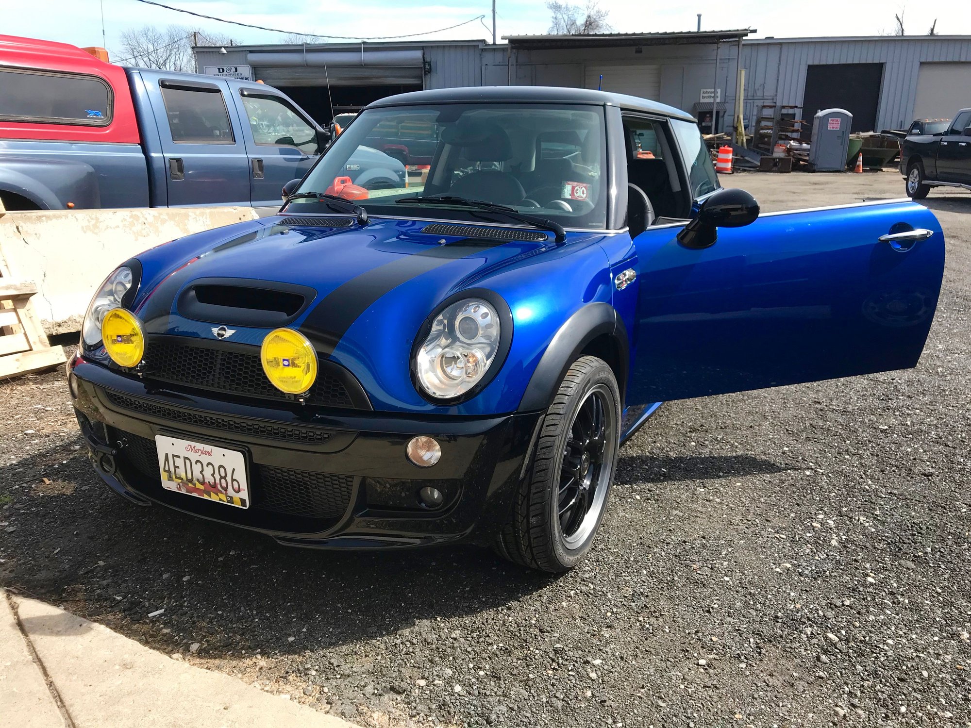

Originally Posted by Aindrid
And don't forget a tally of the cost! I wanna know how much this '$500' mini cost you.
Ha! I'm not sure I actually want to add that up. I'm guessing 4-5K. A rough guess but probably not far off. I've saved all the receipts so I could have a full accounting. Basically I fixed everything that was currently wrong, and with 165K miles it was not a short list. Plus I fixed everything that wasn't wrong yet but would/could go wrong.
Like, It's all apart, why not, right? And I probably went a little over the top with the detailing part so the added some cost, but it keeps me out of the bars right?
So after Andy's visit, I got a little more done that night, then got off work at 2p Friday and put in a 13 hour day, and to be honest It kicked my a**.
My. garage buddies showed up about 730-8p Friday, and I had been busting butt until then. While they were there I kept working but at a slower pace. They usually give me sh*t for working while they're there but at least igot the roof taped off.
They left about 1230-1a and I said F-it.
I had taped off the body to cut down the mess when sanding and compounding the roof.
When they were gone I sanded the roof with 3000, then 5000 then compound. By that time it was about 3am and I was done! 13 hours kicked this old guys a**.
I was back this morning by 10am, finished polish 1 and 2 on the roof, took all the plastic down, cleaned the roof and the spots on the body from splatter. then waxed the roof, cleaned the windows, Vac'ed the floors, wiped the dash and the interior/seats down, and started it up.
Ran fine but a EML light was on and I was worried as I didn't hear the fan coming on. Eventually the fan came on, I guess It just wasn't hot enough. On the second start, no EML light. [came on again later but the engine is running strong and sounds great!
Loaded up some polish stuff and a bag of tools. I figured if I took them I wouldn't need them.
Drove home about 10-12 miles.
THIS IS THE FUNNEST EFFING CAR EVER! The exhaust sounds just PERFECT and the supercharger whine is just the icing on the cake,
It ran PERFECT, didn't miss a beat and sounds like a million bucks! [did I mention how great the exhaust sounds? I cannot recommend the Borla "aggressive" highly enough!!! Steered straight, no funny noises, brakes worked, all around a perfect outing,
With a 15% pulley, the Borla and the cold air intake it makes noises that are just so right, I can't express it in words. Throttle response, and the sh*t and git factor just makes my shorts tight. Feels like I'm 21 again!!!!
Tomorrow is 5 months exactly since I started. Pretty much 7 days a week so about 600 hours plus or minus.
AND IT WAS WORTH EVERY MINUTE!!!!
I drove it about 50 miles, parked it an hour ago and I'm still smiling!
Some additional things to do, including rear sear delete but tomorrow I'm going to do my best to use up a tank of 1.5 year old gas.
Too effing cool!!!!!
I'm hooked!
robj
First glimpse of the light of day!
Had to re-arrange the truck to get the Mini out ot the shop.Clhoe is like WTF do you think you're going? Not without me! Her eyes were on me!

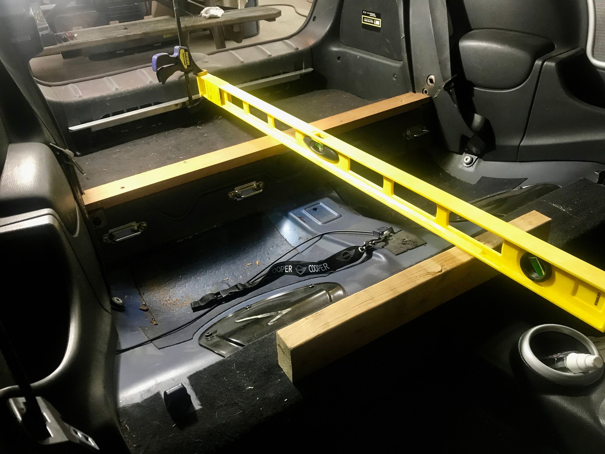

As you can see, Blue car hit the road yesterday. And it was pretty trouble free. Only issue it the EML light came on, then went away then later came on again, but the car is running fine, no limp mode etc... So I'm going to ignore it until it decides if it really wants to be on of off.
So today is exactly 5 months, [Oct.15] since I started on Blue Car. And it was a pretty solid 7 days a week. Well, evenings during the week and weekends during the day, [and into the evening].
So I figure an average of 4-5 hours a day. So 22 weeks x 7 days x 5 hours, about 750 hours or so. Even considering beer time. But I was and am having fun.
The antenna is blue. It's from Amazon and seems to work ok. I'm undecided as I think it might look a little hokey so I might get a black one. I went with the Mini Madness cold air intake along with the rear panel with the hole in it. The same one they detailed the installation on Pelican Motors. [and I LOVE the supercharger whine!]
I did succumb to the silver "track mats". They have a clutch foot rest and they just look "all business". With them being silver I think it'll tie in with the silver door trim so that will stay.
Ah, Headliner. I do have to do something with that. Wonder how big a PIA it is to take down? As to what to cover it with? Not sure there either, Checker board sounds a little busy. Was thinking a perforated leather look like Mercedes and older VW's had. And If I had to guess right now I'm thinking black. I assume all the old foam needs to come off the board as that's what's failing.
I did order a new rear wiper motor. The nut for the blade was really stuck. After 2-3 days of BP Blaster that came off but the metal insert from the blade is stuck worse and I messed up the shaft working on that. I would have got a delete plug but I had already bought the new blade and arm. And, that's actually useful unlike the stupid headlight washers.
And speaking of delete, what's the easiest way to deactivate the headlight washers? Pull fuse #15?, [I think that's what it was...]
I'm also going to build a rear seat delete with left and right hatches in the front and a full width hatch in the rear. Aluminum trim and probably ribbed rubber covering.
That might be the first thing I start on, after cleaning up the shop which is a real mess after the marathon of the last 3 days. My truck is still parked there so after I'm convinced the mini is somewhat issue free, I need to retrieve that.
I need to do quite a bit of running around to use up a full tank of year old plus gas.

I did start on the "Rear Seat Delete" some and worked on it tonight as well. It's one of those "engineer as you go " sort of things but now I think I have at least a plan.
I'll save the pic's on that until it taking a little more shape.

Ok, if you insist, one pic..
Some carpentry skills getting the board on the mid-brace cut at the correct angle to lay flat. Screwed down with construction adhesive. 1" Aluminum angle riveted across the back.
More to come. Pretty much level but I have it tilted ever so slightly toward the rear to keep things from sliding forward, a degree or 3. The front 2x4 is just a spacer.
