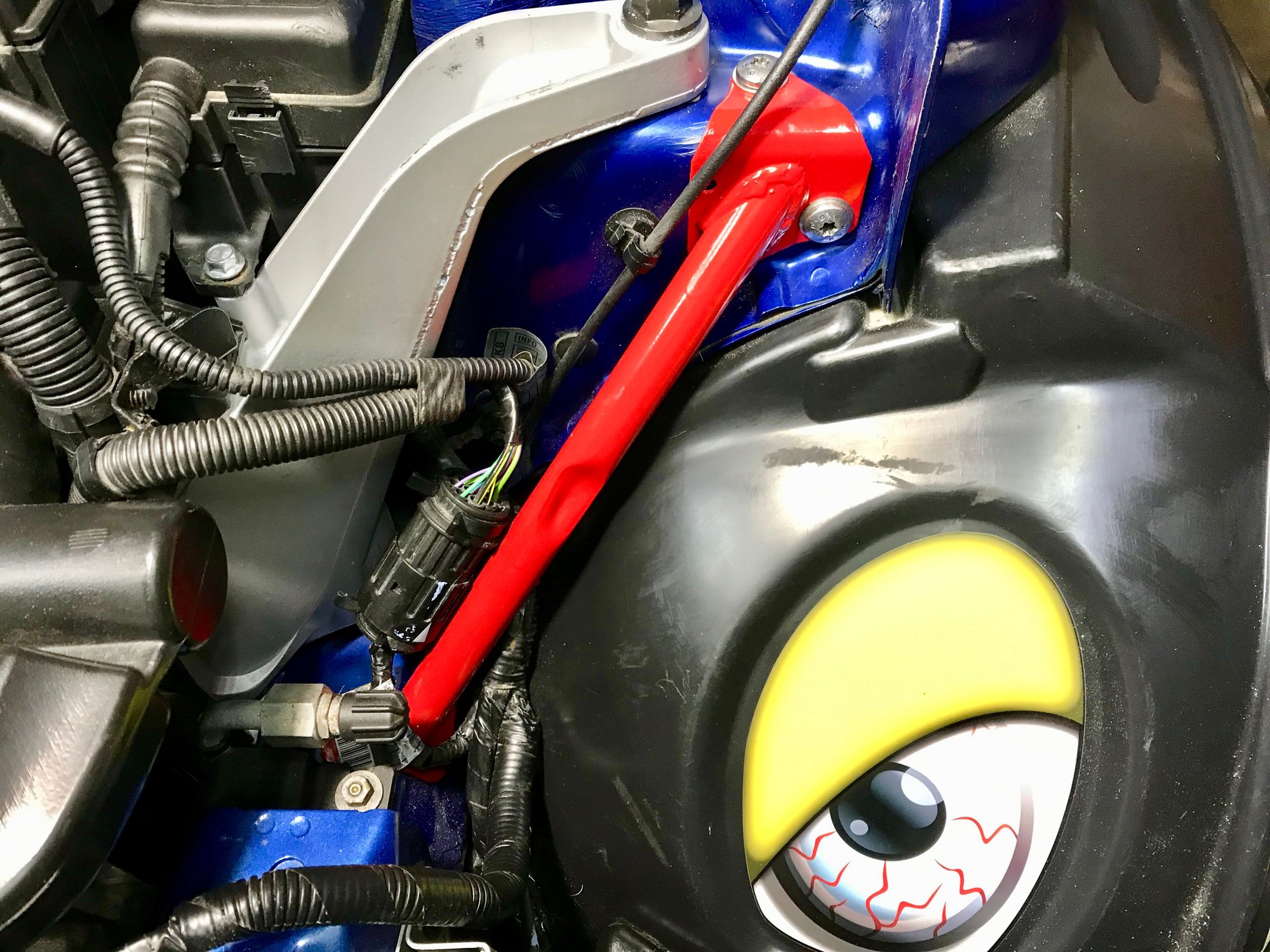

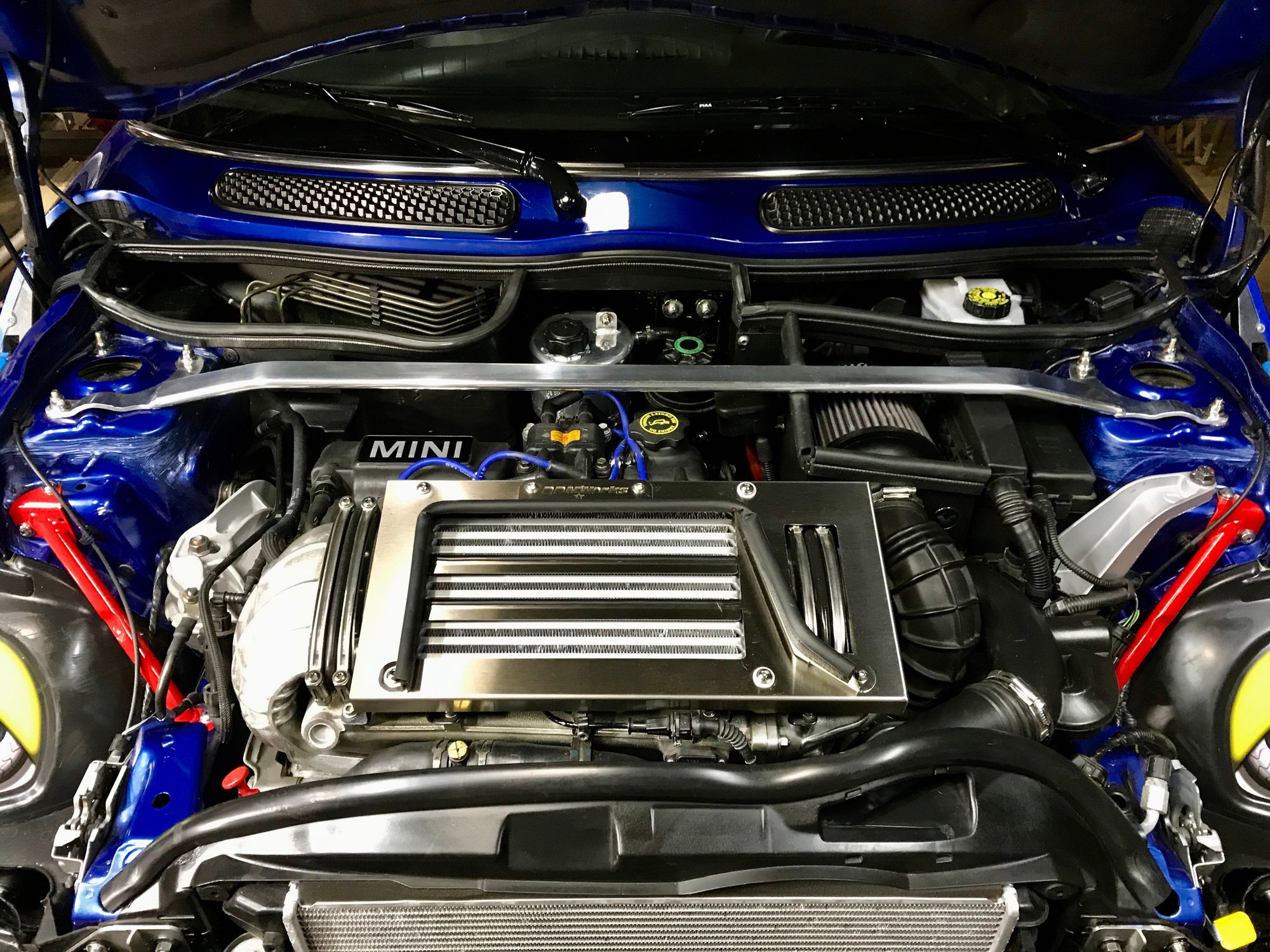

The barn clean-up continues but despite moving probably 2.5 tons of "stuff" from the barn and the tractor shed, not done yet.

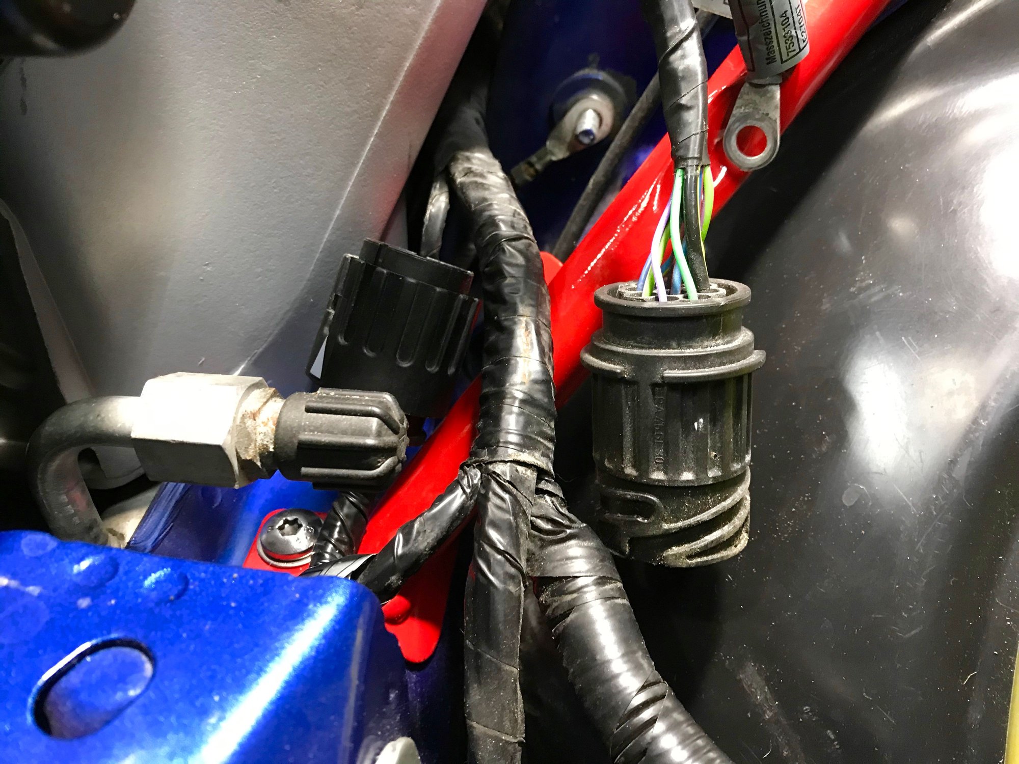

But I needed a little break to do something fun like work on the Mini. I had been running without the intercooler cover as the OEM looked like it blocked a lot of airflow. But without it you're sucking in heat off the engine unless traveling "at speed". My original plan was adding foam to have it take up the gap but I saw the DDMWorks Intercooler Diverter which has the maximum amount of opening and a really good seal to under the scoop. Plus being stainless it looks nice. I bought it from Way Motor Works and at $165, not cheap but it's quite the quality product. It came about 2 weeks ago and I was dying to install so it went on.

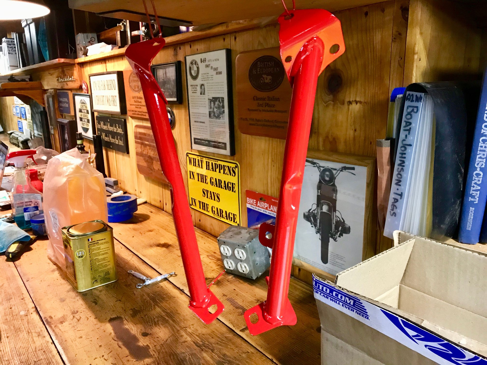

I also bought 2 Cabrio tower supports from another NAM member, 2amAn, [aka Simon] and they were nice pieces and he shipped them really fast. Still can't believe BMW/Mini went from $20-25 each to $110 each. I guess they figured out they were selling more of them than the total number of convertibles produced.
So they got bead blasted and painted, [red]. Why red you ask? Well, the springs and swaybar are red, [unseen of course] but the roll bar, whenever that arrives, and after the mods to mount the spare will be red as well. I thought a dash of color would be nice. I polished and clear coated the OEM torx screws and I probably would have skipped that and used some SS Allen head bolts I have but I had left them at the boat shed. The holes in the brackets were a little large and I didn't have any washers that I liked so I had to drill out the holes in some smaller SS fender washers I had to fit the torx bolts.
The brace went on sort-of smoothly. The drivers side took about 2 hours and the passenger side took about 20 minutes. On the drivers side there's a bracket for an electrical connection which moves from the cars frame to a tab on the new bracket. There's not a lot of room to work on that side and the bottom bolt I had to hold with long pliers to get started, otherwise the inner fender panel would need to come off and I wanted to avoid that.
To add insult to injury when I got that side bolted up I figured out the main wiring harness needed to be on the other side of the new bracket so it had to come back off again. Oh well, at least I wasn't carrying junk from the barn.
Next up really needs to be the airbag warning light fix. I concluded it was probably the clock spring so I did get a new one. I've read various things regarding it's installation including "re-programing". Really? For a clock spring? If anyone has any hints on this I'm all ears.
rob

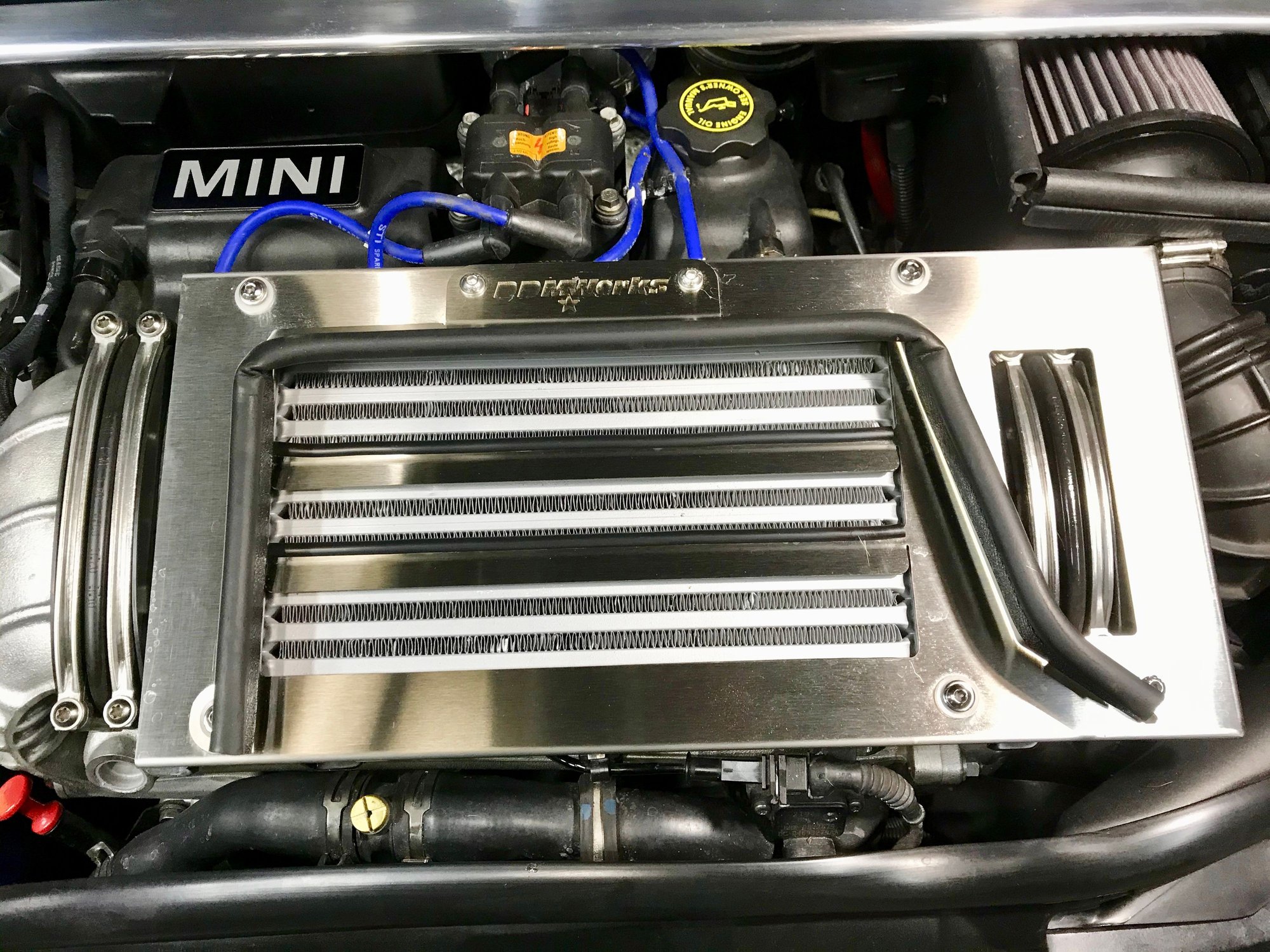

A nice product, looks good and fits well. Louvers are supposed to be designed for optimum air flow.
Painted up. I let them sit for 3 days so the paint was good and hard.

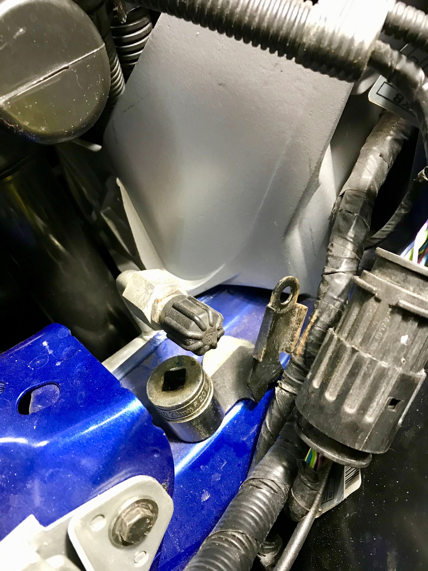

The fiddly side. The original bracket is in the way of the new brace and is discarded, The clip for the wire goes on the tab on the new brace.
Main harness needs to go on the other side of the new bracket. Take it back off and try again. Don't forget to reattach the ground strap!
Correct orientation and harness clipped to tab.
The PIA side.
The "easy" 20 minute side.
All done. Will it make a difference? Logically it should. Will it be noticeable? Probably not but we'll see.

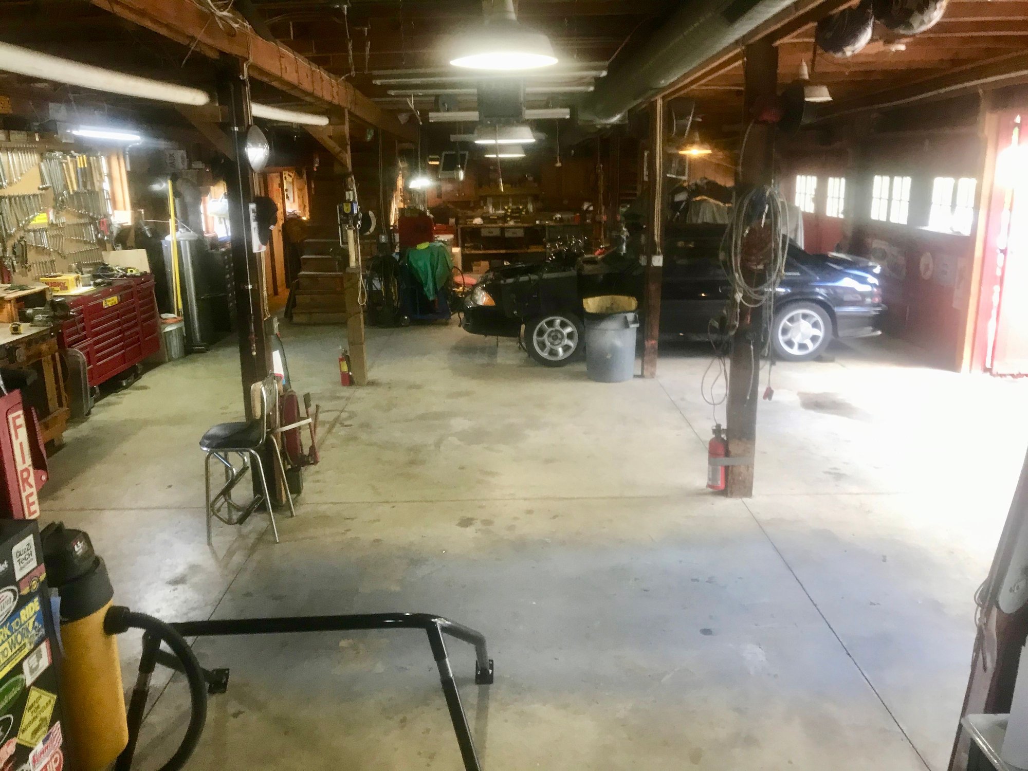

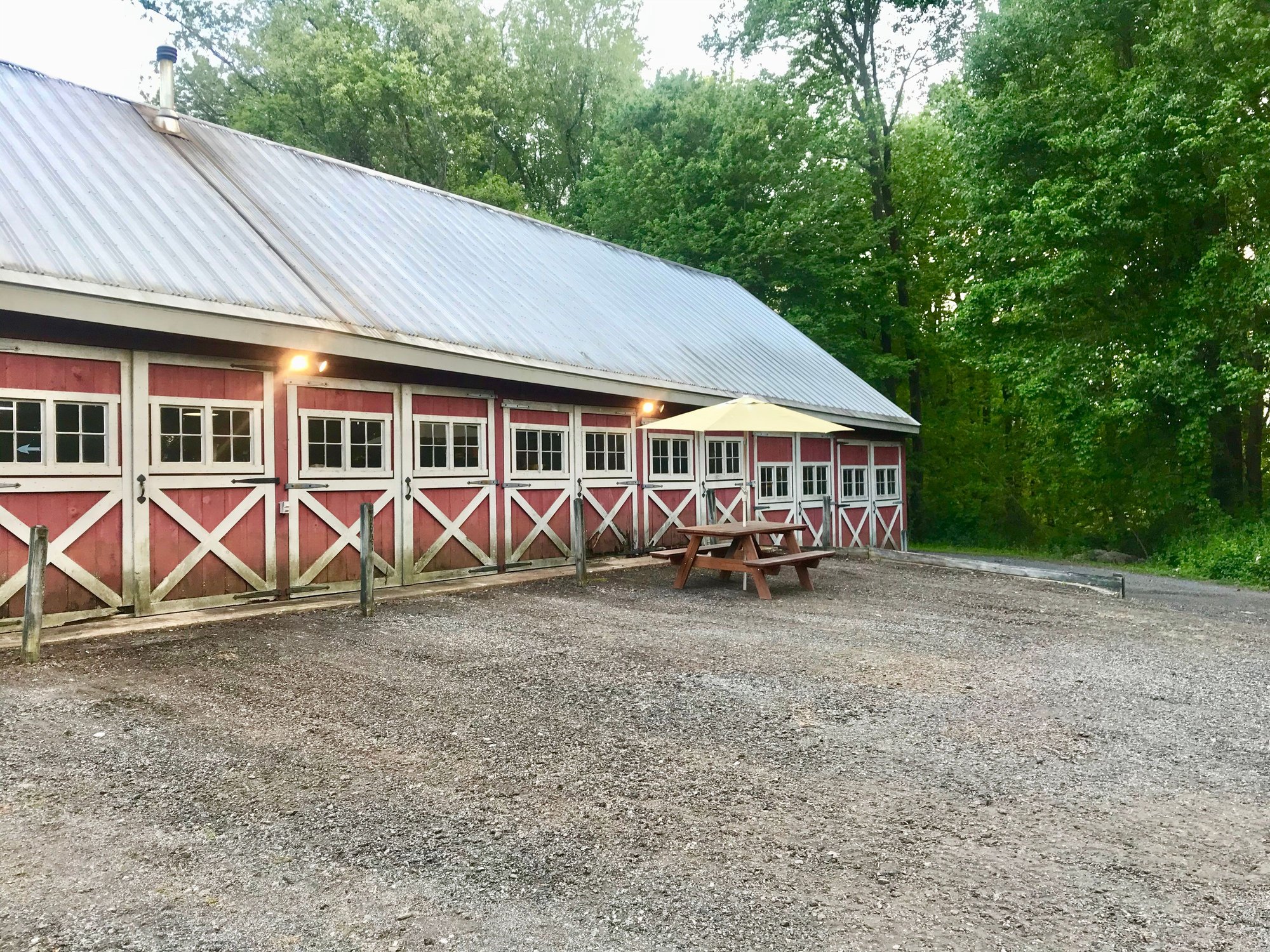

Thanks CB. My first shop was an alley behind my house where in H.S. I put 2 different engines in my '57 Chevy. [wish I had that one back!]. second "shop" at my first house was a driveway with no garage. Second house had a Model T sized garage where once my tools were in, no room for anything but my Triumph M.C. I switched from cars to mostly working on and restoring motorcycles for about 20 -25 years.
Current house has a 1.5 car attached garage but there was a 30 x 80 horse barn. Once we were done with horses, [thank god] I dug out the barn to level it, added a block retaining wall, all new sides and a cement floor. But being a pole barn there's a post every 10' which is a little inconvenient.
And somehow over the years I've collected too many projects and TMS. Hence the current major clean-up. I'm slowly moving toward a shed type addition, 20'x40' using 2 40' sea containers, one on top the other with a shed roof to the existing barn roof so I can move the Chris-Craft I'm working from the boat shed to the shop at the house. plus adding more than enough storage.
Also I'm going to need to live to be 100, to get my projects done, but it's good motivation right?

Barn Photos. I really don't know how to act. Floor Real Estate I haven't seen for years!
robj
Two parts Cherokees moved to the tractor shed and graded the lot.
Two empty bays!
