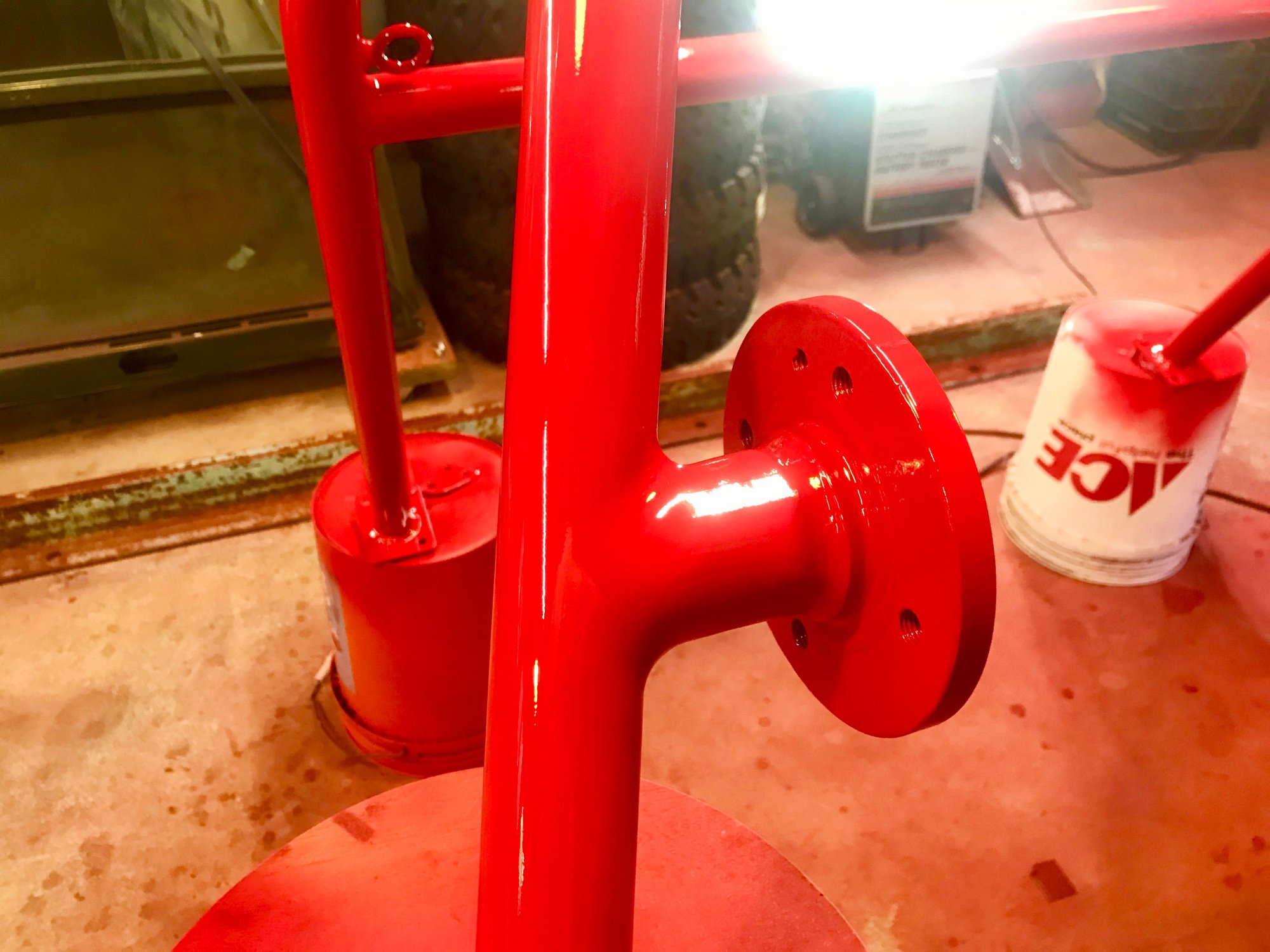

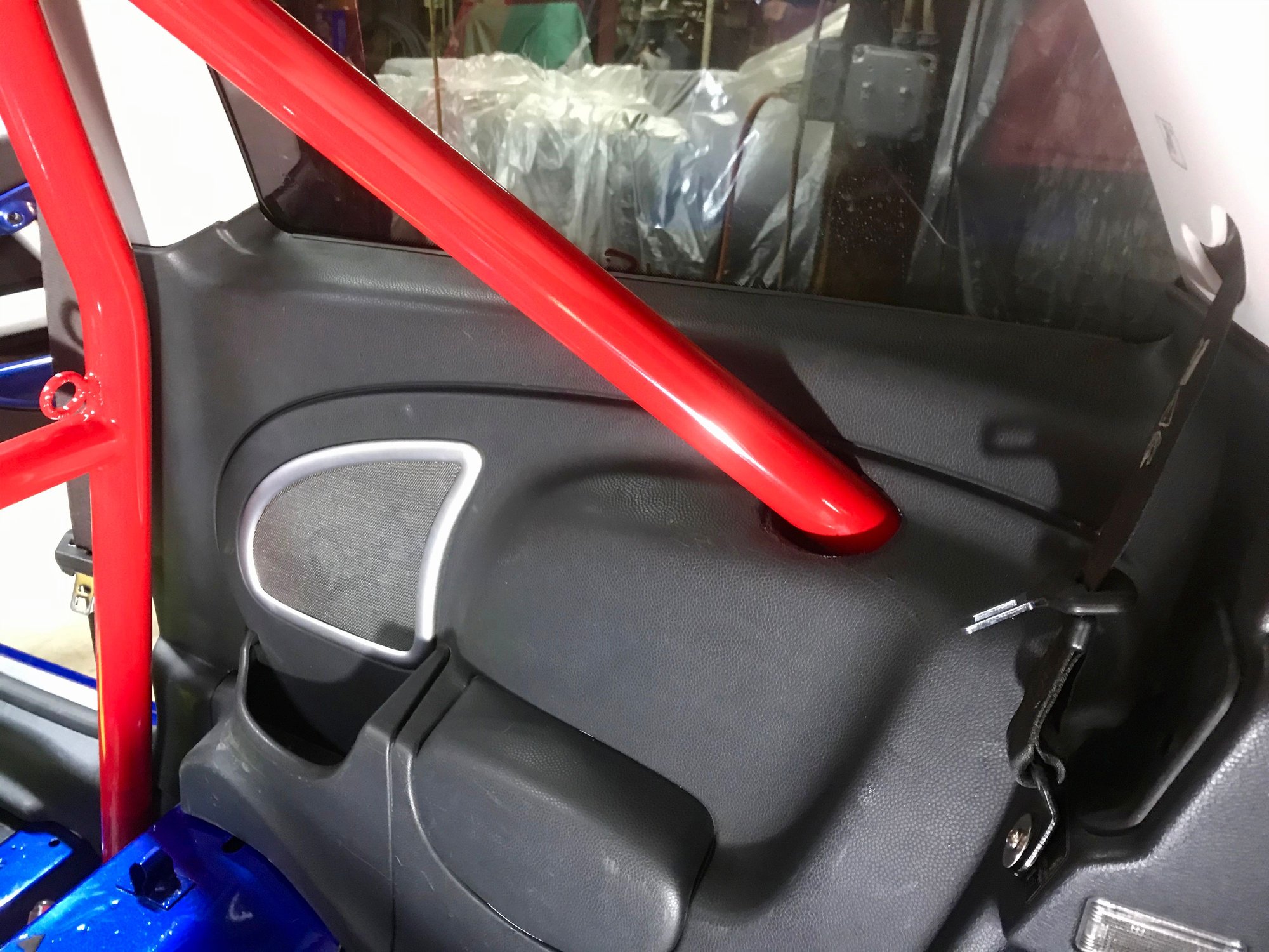

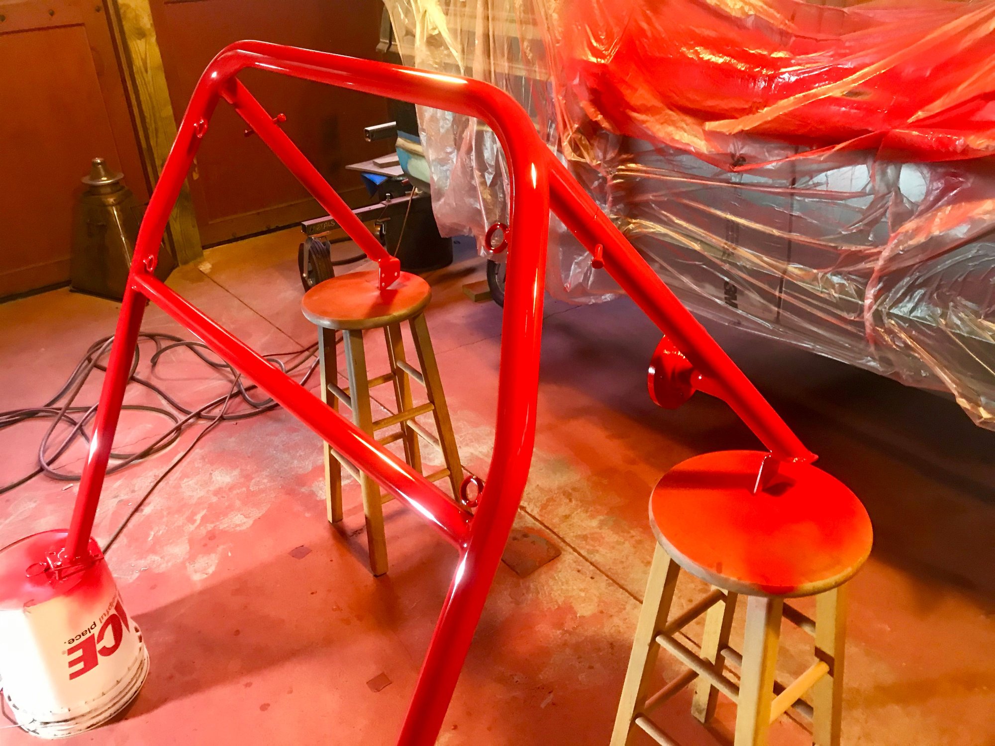

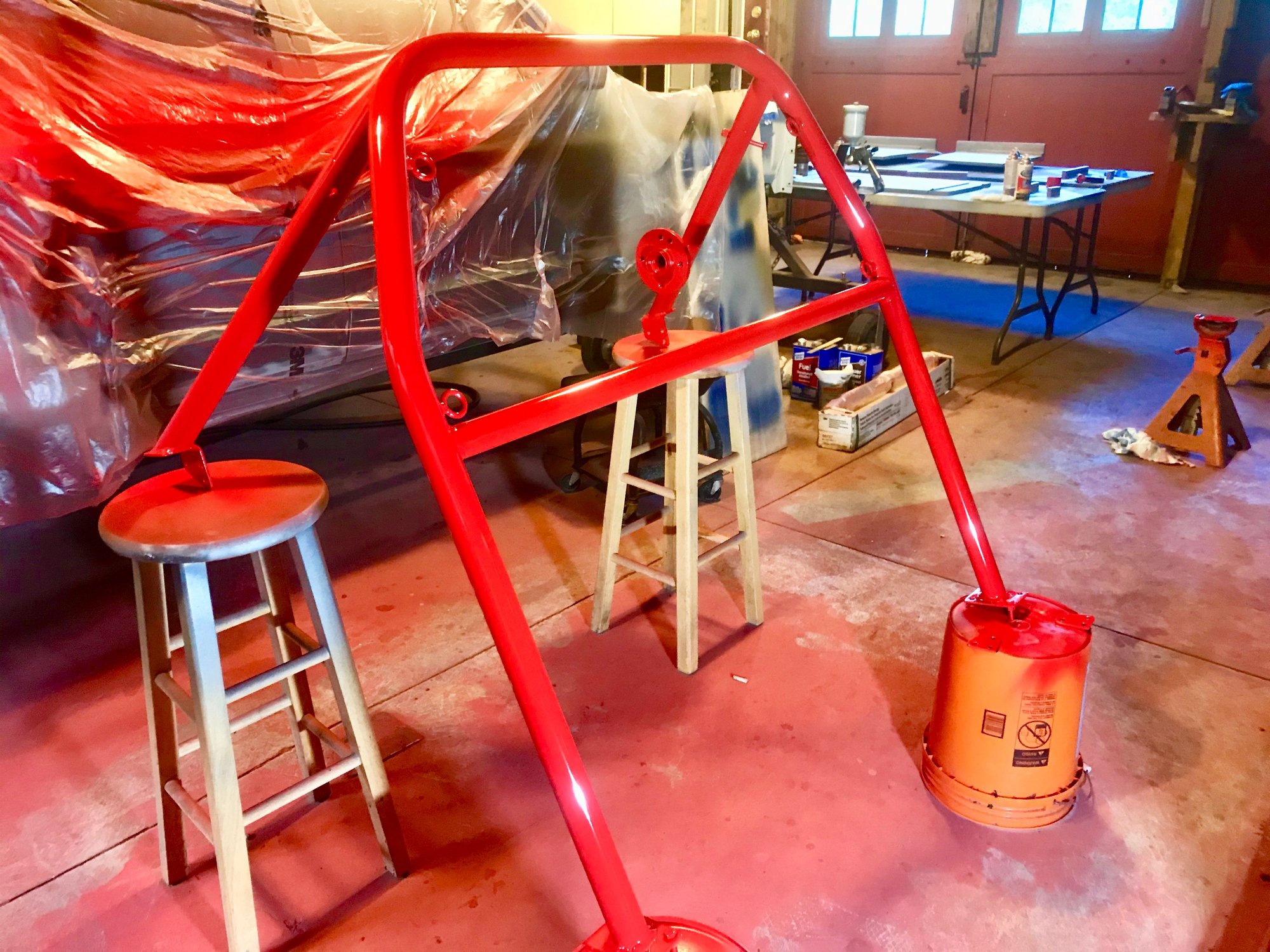

After having to re-do the paint on the RSD, I thought I would do something where I have more confidence in my ability.
Rattle Can!
I've got the RSD primed and letting it sit a day before sanding so I switched to painting the roll bar [in between fitting the carpet delete track mats].
Turned out good, all flowed together and best part, no runs. Maybe I should stick to rattle cans!
Now let that sit a few days, [good excuse to hold off on painting the RSD] and fit the drivers side track mat.
rj
Sure is red...
And shiny. At least it flowed out good.
4 cans with a tiny bit left over. 2-3 pretty wet coats.
Old Jul 15, 2020 | 10:45 PM
  #405
Husky44's Avatar
Husky44
Joined: Dec 2018
Posts: 697
Likes: 247
From: Vashon, WA
So you decided to go for more of a stealthy race car theme, huh? 🤣
Old Jul 15, 2020 | 10:53 PM
  #406
robj's Avatar
robj
Joined: Oct 2019
Posts: 587
Likes: 294
From: Maryland
Ha!!! Thanks for noticing!
I figured if you're going to go through the aggravation of installing a roll bar it might as well show up! Plus it matches the springs, sway bar and the Cabrio frame horn supports. There's some method to my madness...
​​​​​​​robj
Old Jul 16, 2020 | 07:12 AM
  #407
Eddie07S's Avatar
Eddie07S
Joined: May 2010
Posts: 7,894
Likes: 1,458
From: Upstate NY
I went with the more stealthy look for my roll bar...
Rattle cans have gotten to be pretty good and that bar of yours looks good. The red will blend in well with the blue interior....
But, I am not sure the MINI needs a roll bar. There is strong evidence that even stupidity can’t crush the roof of one of these things. This showed up on another thread I am following:
Enjoy!

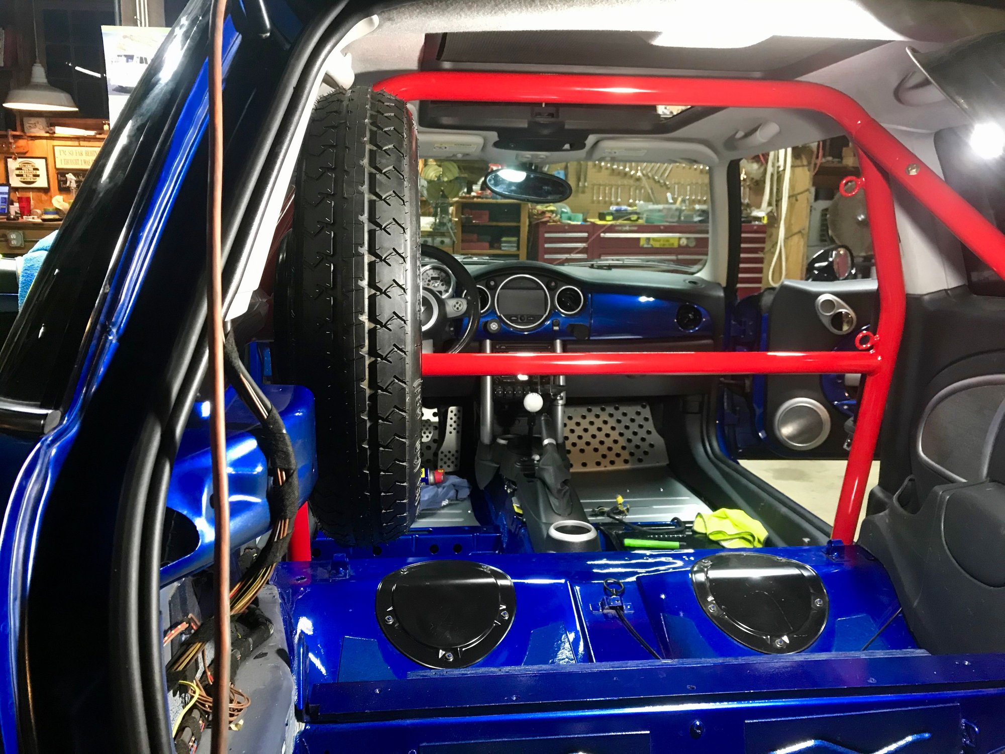

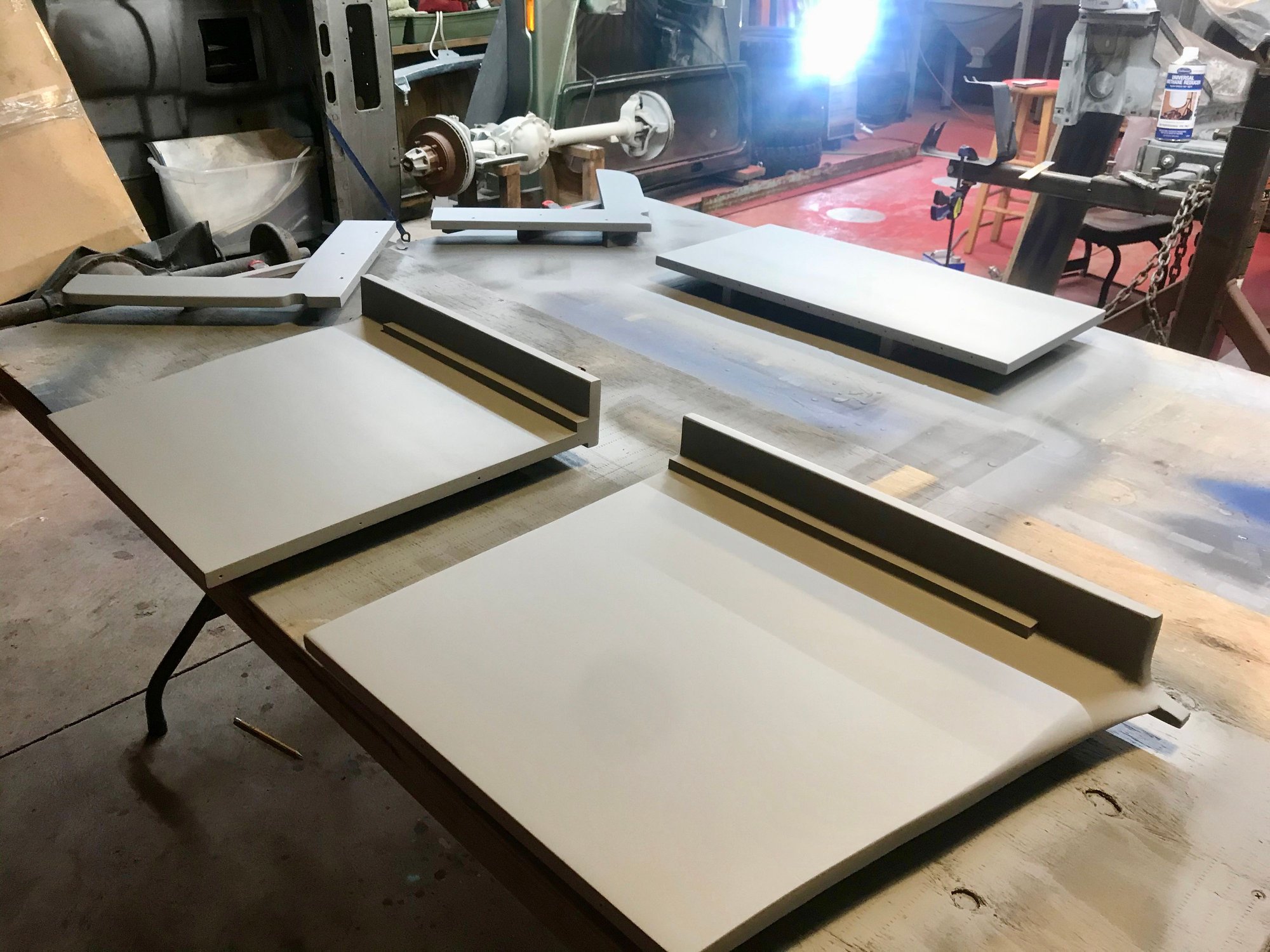

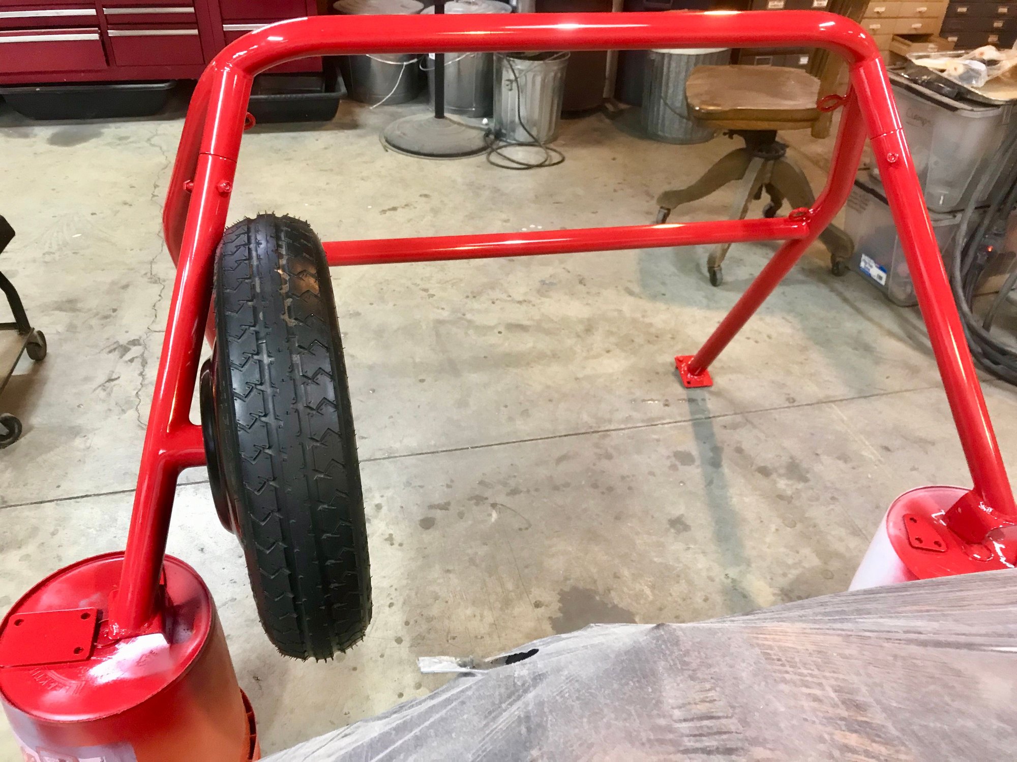

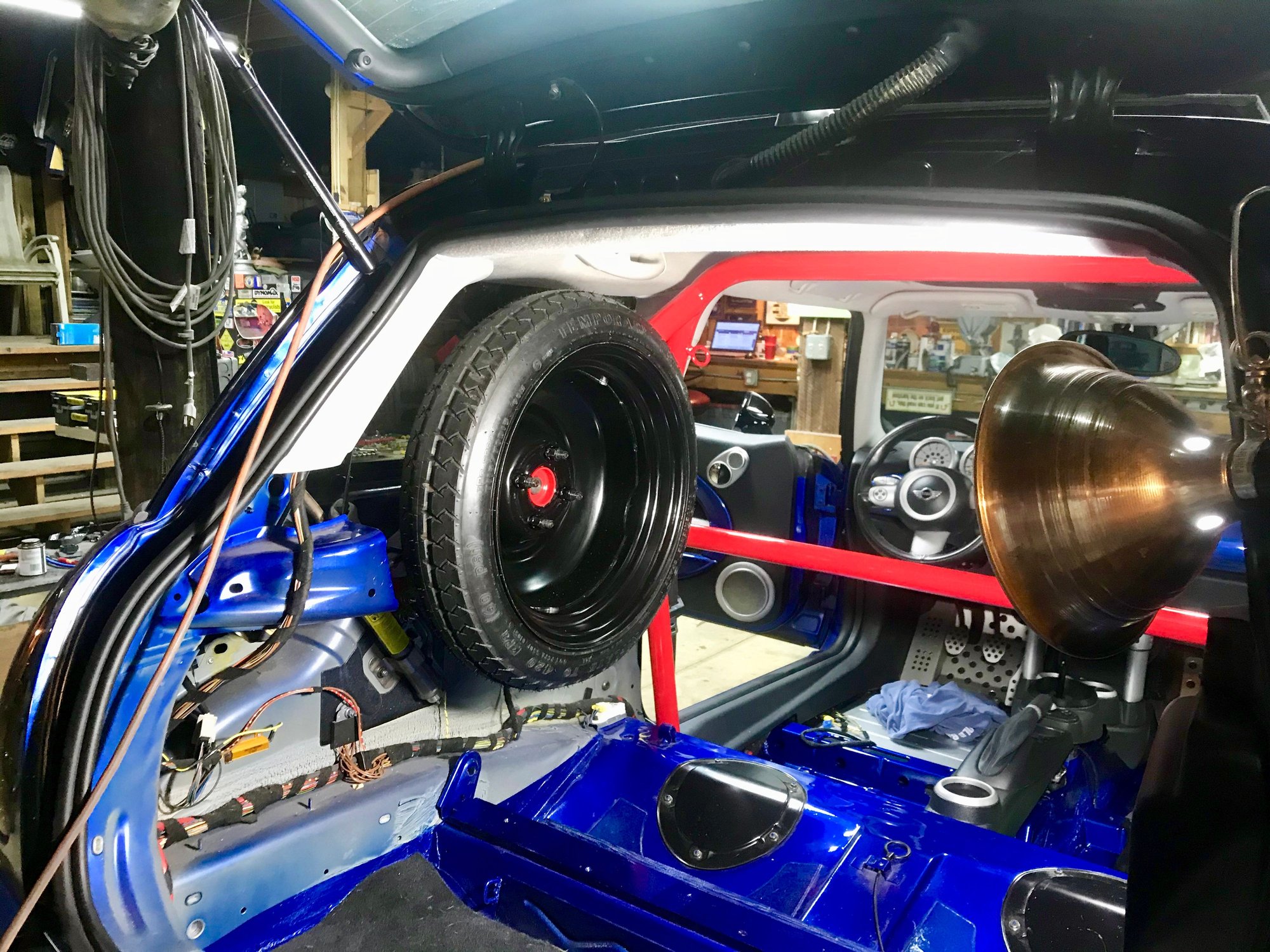

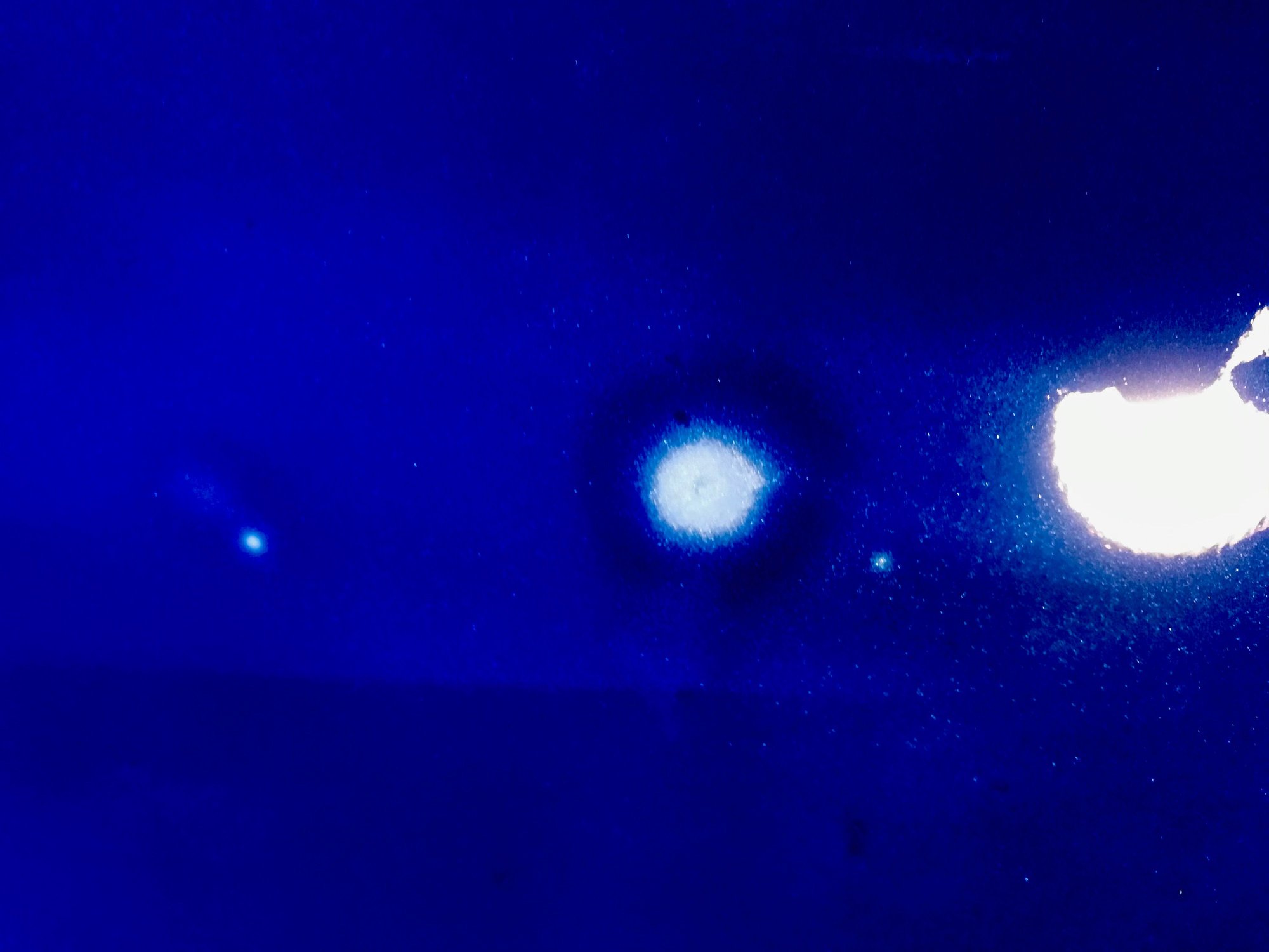

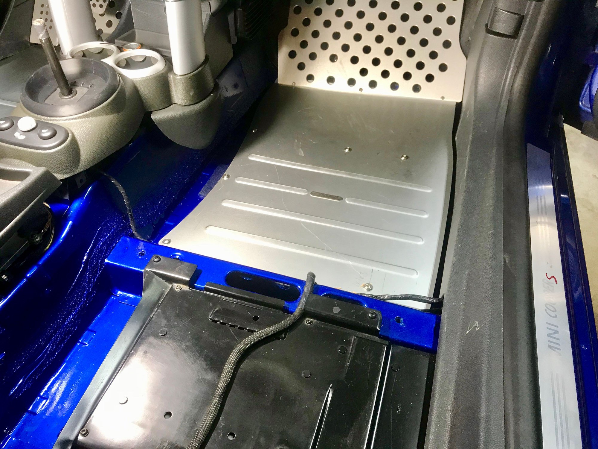

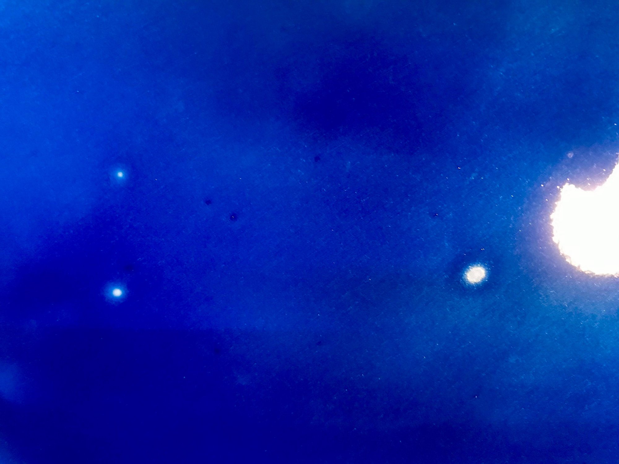

Moving along, slowly but surely.
The RSD paint job fail was due to some really big fisheyes from some sort of contamination. I post the good and the bad, pic's below. The RSD has since been sanded and 2 wet coats of primer. Maybe paint tomorrow, but the schedule of paint is gong to be a little tricky, top, bottom, base coat , clear coat. I haven't quite figured out the order that's going to happen.

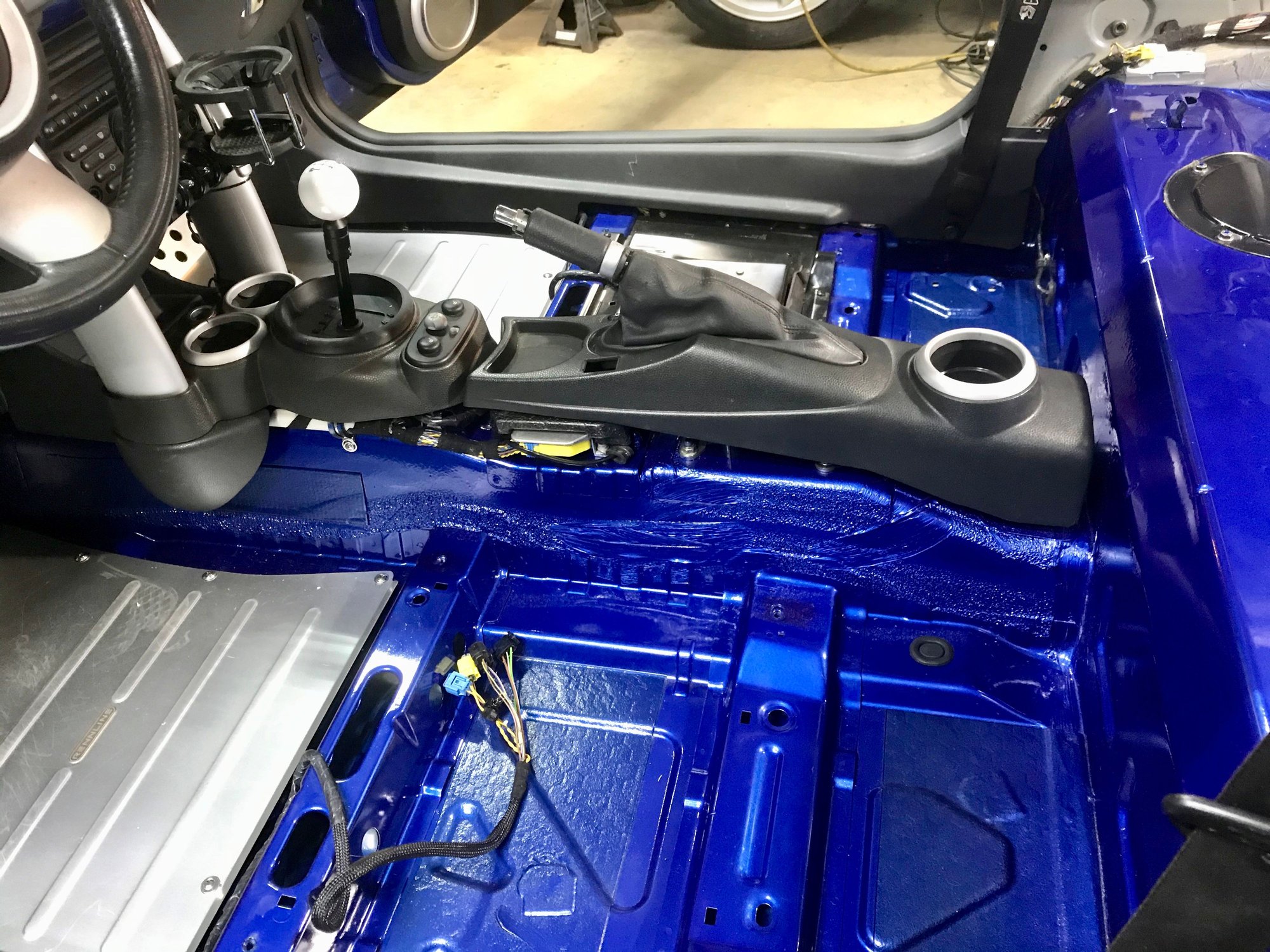

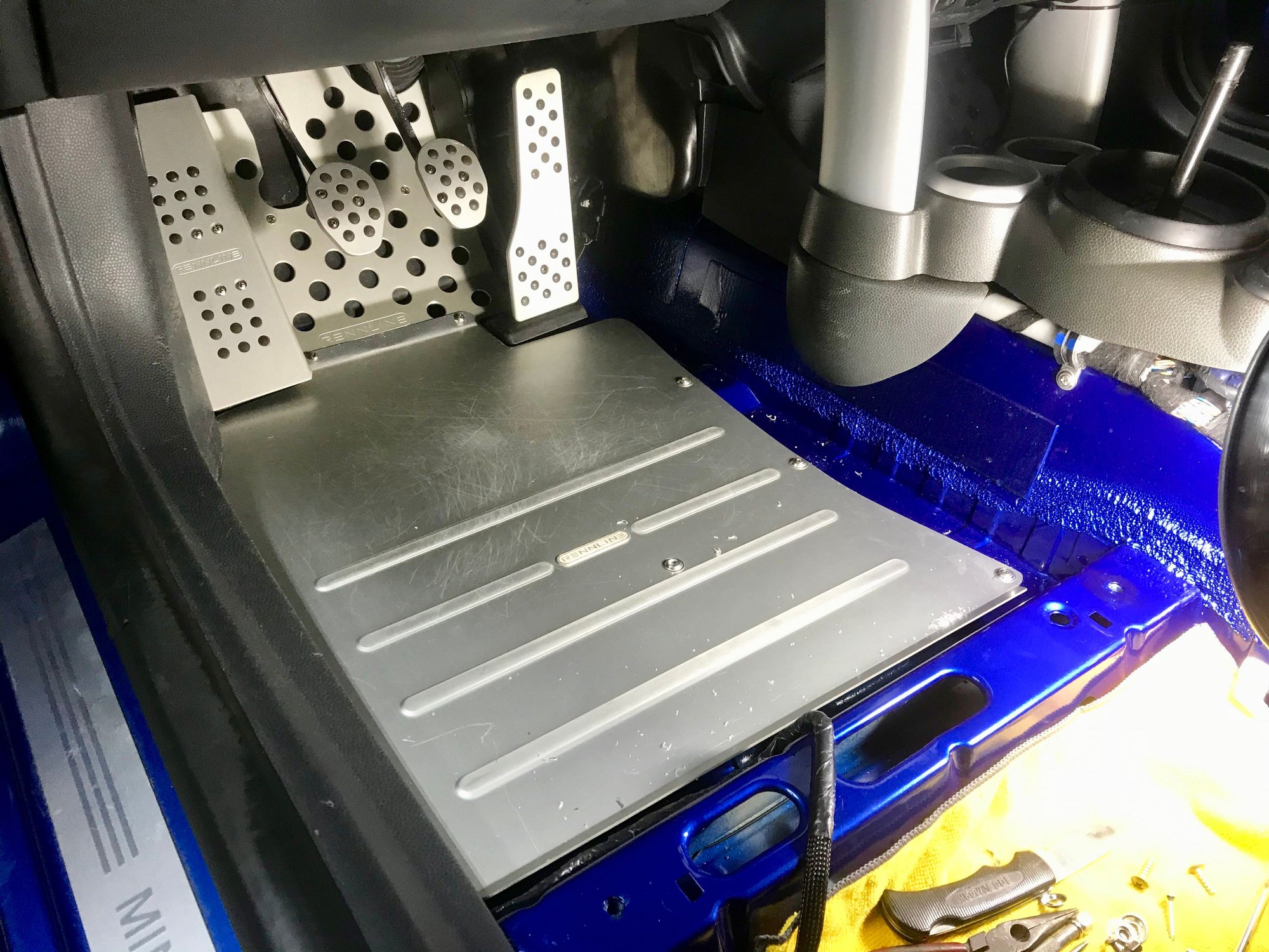

The track mats for the floor. That's going pretty well but lots of figuring as I go. I was originally planning bolts through the floor, nuts holding them on, then another nut and washer higher then an acorn nut and washer on top to make removing and cleaning under the track mats easier. Well that didn't work due to frame stiffeners and the sub-frame mounting points, There were too few places to put the bolts.
Ended up using sheetmetal screws to mount to raised portions of the floor pan.

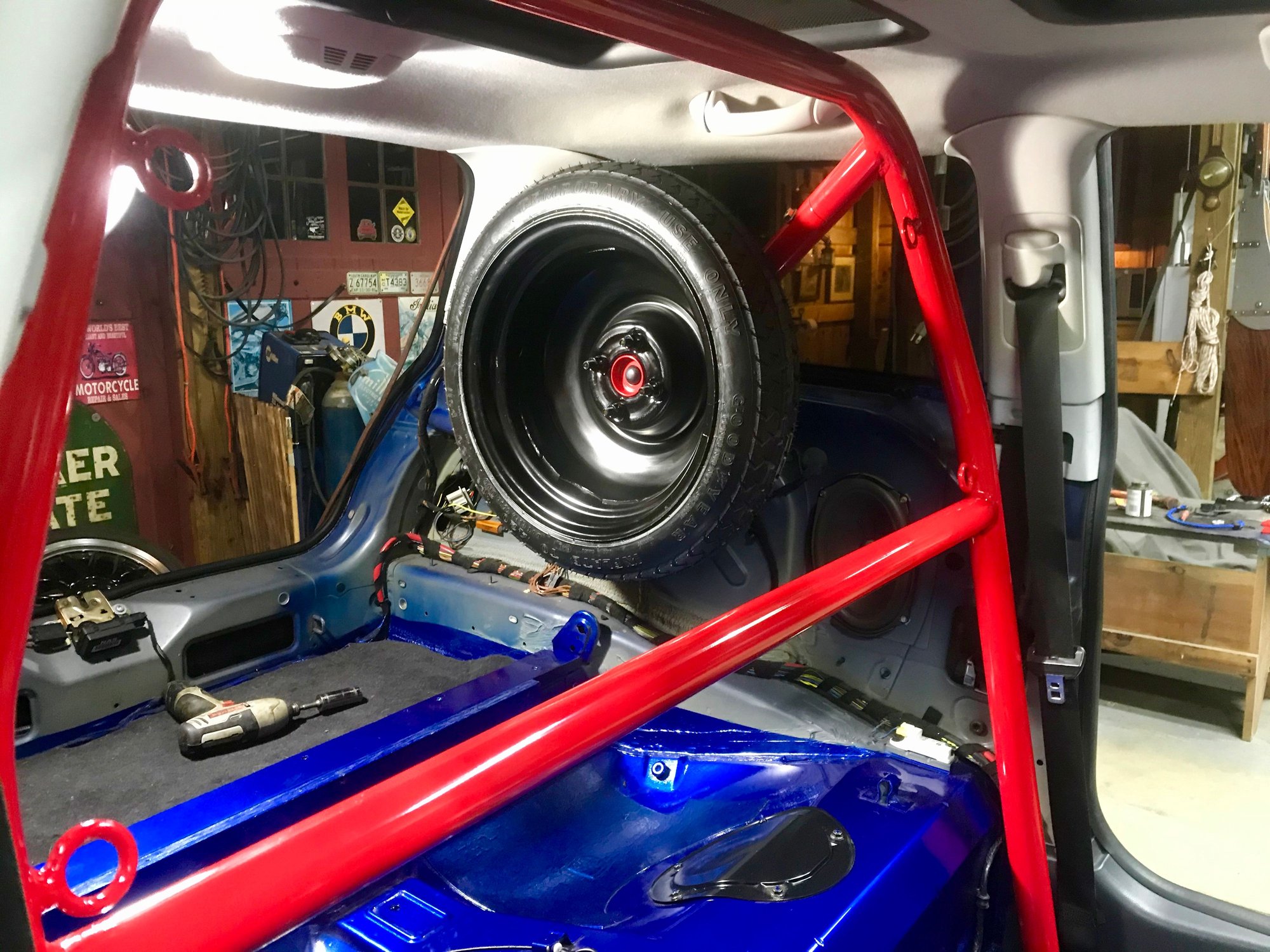

On the rear outside corner of the pass. side I needed a block. I cut a chunk of mahogany, base coat /clear coat then used double sided Gorilla tape to stick it to the floor. Worked out well. No pics but I still need blocks for the drivers side.

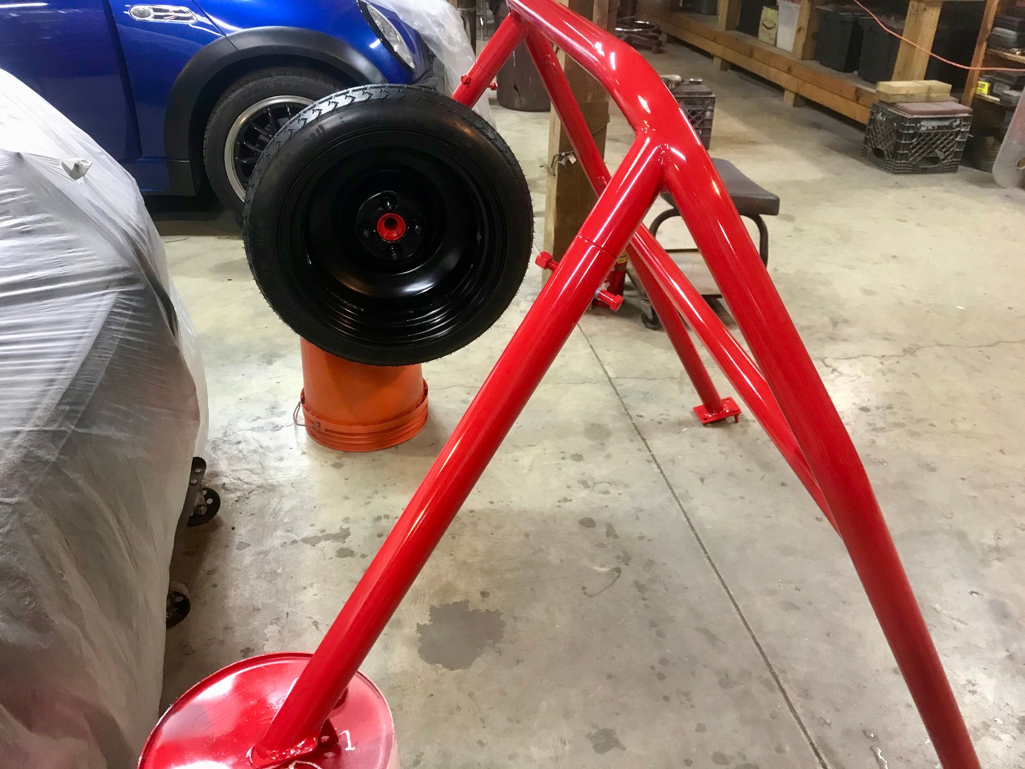

As the main point of this exercise was to mount a spare, I couldn't wait to see what it looked like and how it fit.
Need to finish up the track mat on the drivers side, finish the install on the RSD, [as long as the paint goes well] install the headliner then wrestle the roll bar and the side panels into place.
Slowly but surely...
Pics Below.
RSD paint fail. Really big fish-eyes...On the right was a light reflection, left is the fisheye. You can see where the blue just ran away.
Little ones...
RSD ready for sanding and another try. Hoping this goes better.
Passenger Carpet delete track mat installed. I like it, and the dog hair will blow out with an air hose.
Drivers side. I need to make 2 blocks for this, one next to the gas pedal and one in the left rear. I also added a Sprint Power Booster for increased throttle response. I'll be interested to see how that works out. Read lots of pros and cons.
The reason for all this. I couldn't wait.
Another view.

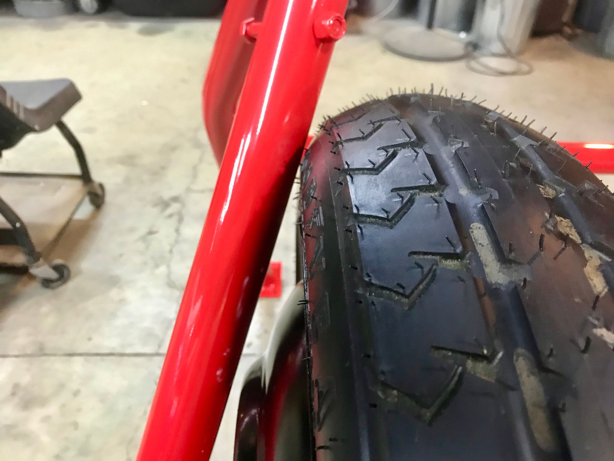

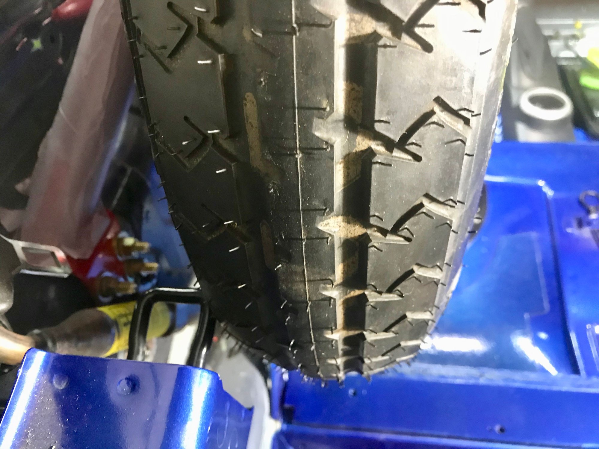

Plumb and square. Looks a little wonky in the photo but not in person. [It's actually a little hard to tell how it will sit once inside the car. If it's a little "off" visually I'l just put a washer under one of the studs as a spacer. That's why I oriented the studs up and down.]
Cut that a little close! About 1/8" between the tire and the bar.
Wide view.
So far so good. Took a little longer than I hoped but that happens with engineer as you go..
I think it works.
robj

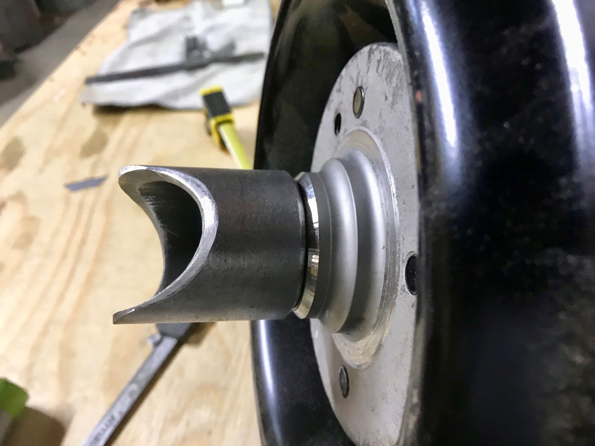

[QUOTE=smschriefer;4545361]Rob, things are looking great and I've enjoyed following along on your build. If it were me, I'd install a small block of foam between the tire and the roll bar. Just something that would need a bit of compression. My thought is it would help prevent any vibrations caused by the wheel flexing under stress."
I have though about doing "something" along those lines. To be honest, the weld is very substantial [3 passes] and the short piece of tubing is really thick wall, like a little over 1/4" thick- almost 3/8", I'll measure as to be honest I forget.
In addition the hub was turned down to fit into the tubing so no loss of tubing material there either. It's pretty robust. I had thought about a gusset from the roll bar to the thick wall but after welding it up and realizing the weak point was the roll bar tubing itself, the gussets really wouldn't have helped. I did trade the grade 5 bolts with grade 8 mostly as I like the gold zinc color, Ha!
If there is a weak point, it's probably with the original roll bar tubing as it's thinner so I'm not sure that's actually a weak point or not.
But in the rear the tire is right where the top seat latches bolt into the body. If I do anything I was going to put a threaded metal/rubber pad in one of those holes and adjust it until it presses on the tire. I'm thinking the further out a steadying point is the more effect it will have.
I did find a rubber plug in my collection of "stuff" that fits in the hole in the hub where the axle went, so that was a fun tidbit to finish things off.

SM,
You got me thinking. I'd rather be safe than sorry and found this. I'll have to retap the hole to SAE, but I think it will work.

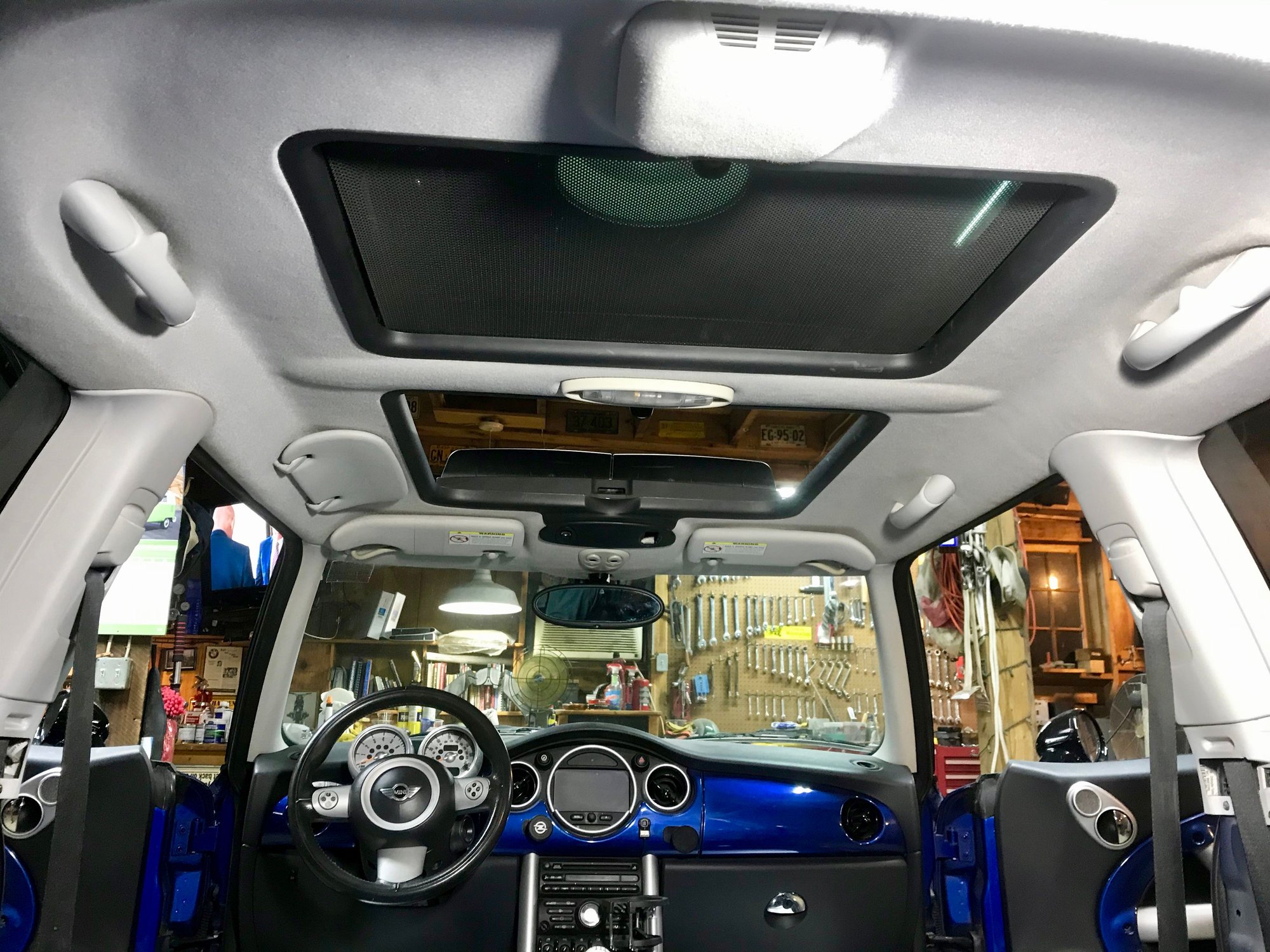

So I had a few beers around dinner time and felt a nap coming on. Ended up 2 hours instead of a quickie, so back to the Mini and quitting time was just now, 5am.
But I got the track mats done and the rest of the plastic bits on, [with the exception of the 2 back panels which go on with the roll bar].
And, I got the new headliner installed.
[and I don't care about what Husky says, it was a fiddly POS to install!]
But after 5-6 hours it's in and done. F'ing plastic clips...
I got a notice from my former friends at Amazon saying the start capacitors for the air compressor that were supposed to come tomorrow, [today] won't be here until Tuesday, so painting the RSD is again postponed.
So whenever I get started tomorrow the next thing is roll bar installation. Might be a challenge. But it doesn't look like it'll interfere with installing the RSD, so roll bar it is.
rj
Track mats, check.
Plastic bits. Check.
New headliner. It will be nice not to have drooping sh*t flapping in the breeze and foam bits dropping on the dash. A PIA but worth it.

[QUOTE=Eddie07S;4545507]The cloth on my has pulled away, like the glue was no good and failed over time. And it is only a small section.
If it's like mine you'll find part of the foam still glued to the press-board and it's actually the foam backing on the cloth that's failed. I think the spray adhesive will work for a while but you're in effect gluing failing foam to failing foam. [sorry, don't shoot the messenger,]
Don't forget to spray the adhesive to both surfaces, the cloth and the press-board, [as best you can] then wait 2-3 minutes before pressing it into place, [if using rubber cement type adhesive]
rob

With the help of my son-in-law, Christian, we got the roll bar in place and I have to say it was a bit of a struggle.
Big credit to the other NAM member that cut the ovals in the side panels for the down tubes as opposed to just a big slot. The ovals were a real pain to get the panels and the downtimes installed. To be honest, as particular as I am, I'm don't think I would do it that way again. It was a real struggle.
The issue is, you have the main hoop loosely installed, then have to slide the downtime up through the side cover, get it to slide into the tube on the main hoop then get under and in back of the side cover to install the bolts for the down tube bracket. At the same time the side cover is very restricted in movement at the front as it's behind the main hoop. Hard to explain and even harder to do!
So big credit to the other member that did both sides this way!
I couldn't do this on the drivers side as the spare tire bracket prevents the downtime from sliding up through the hole so I cut a slot and I'm hoping it will move enough to get the side panel on with the tube in place.
Doing it again I would just cut the slot in both sides. So the hard side is done, hoping the DS goes easier.
But I was lucky as the bracket for the top of the rear seat, [the latch] presses perfectly on the tire as an anti-vibration device! And it's even slightly adjustable so I can have more or less pressure as desired.
Holding off on mounting the main hoop. I forgot to order the grade 8 Nyloc nuts so they'll be here tomorrow. There's a flat plate that goes under the car and when I install that I'm going to put 2 layers of butyl tape between that and the floor. It never gets hard and excess will squeeze out leave a waterproof seal. I use it all the time on deck hardware on boats. Great stuff.
Air compressor is still out of commission so the RSD will be mid-week.
So, the second side panel and the inner fender liners can go back together, Then the main hoop mounts tomorrow.
Pics below.
rob j
All in all I think it looks good and was worth the effort. Just as I envisioned.
Rear view. Hoping the panel on that side goes on easier...
The lucky part. Built in anti-vibration. [the black loop thing]
The hateful side. Trying to get up under there for the bolts, then breaking 4 clips at the front of the panel getting it on. I don't think I would do it this way again.
Hopefully this slot will make the DS easier. I would do both sides this way to be honest. I have dark grey HD duct tape that will cover the slot. Plus it's behind the spare.
Square and plumb. No washers needed. Calling it a win...

Very nice work!!!
I've found myself in the position more than once where the elegant solution I envisioned before I started didn't seem nearly as beautiful once I was several hours and fully committed to doing it.
My only helpful input would be to put something in the slot to try to minimize noise from the plastic rubbing/vibrating together.
