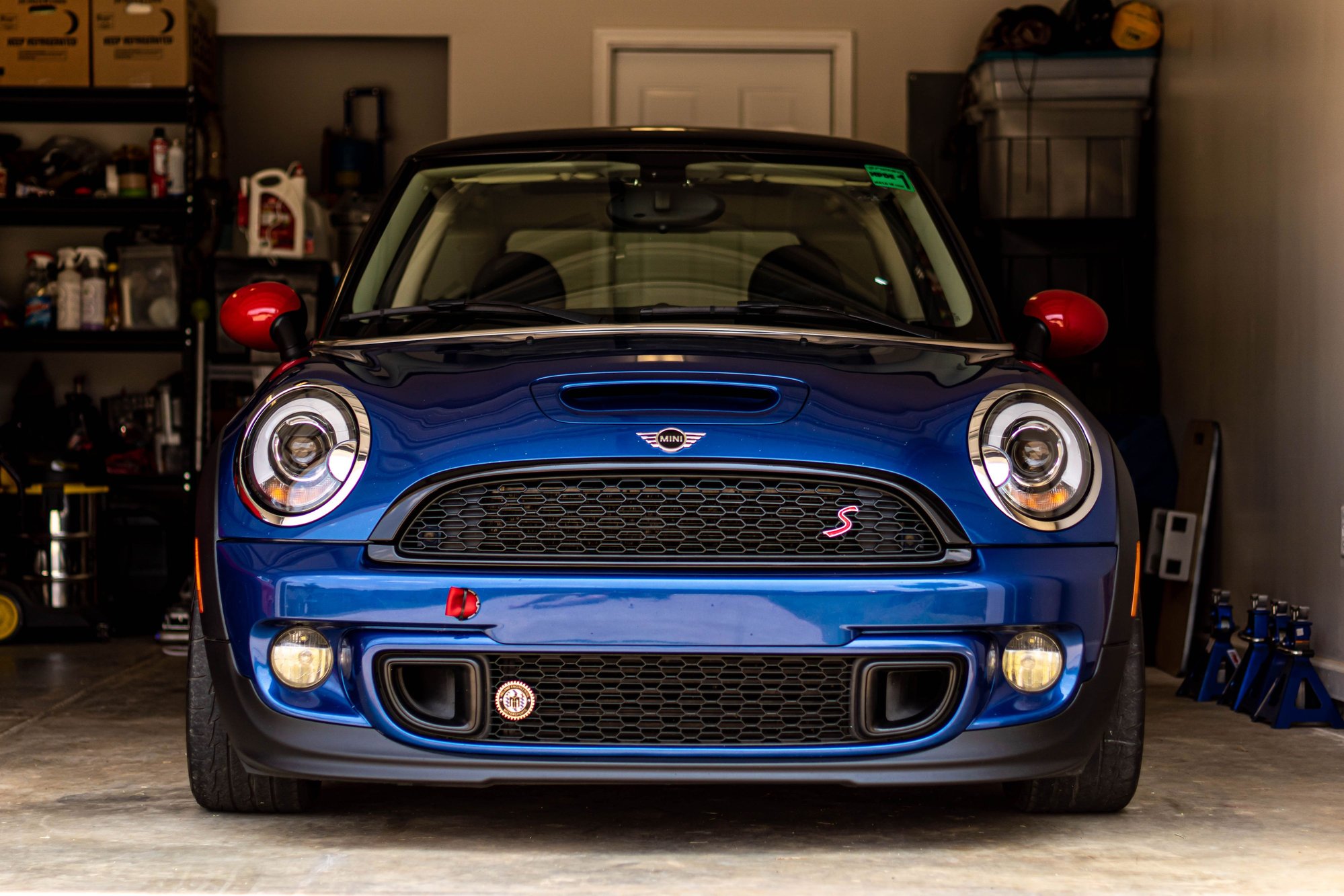

When she was new:

June of 2019:

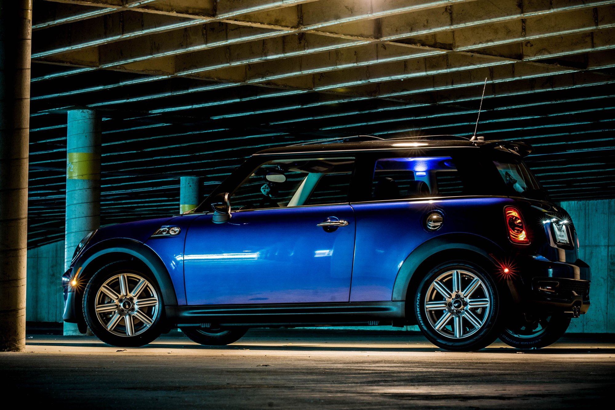

June 2020:

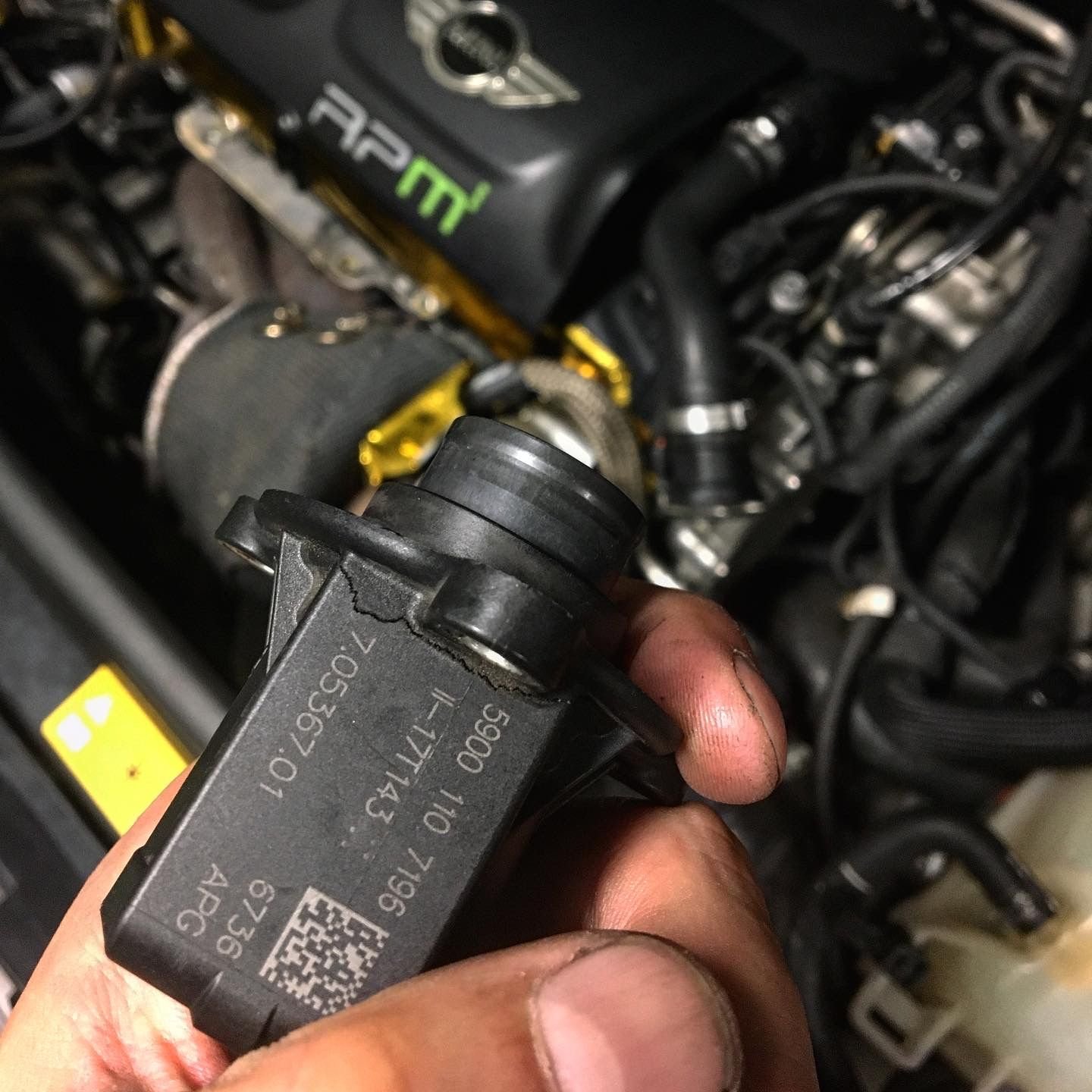

So last weekend at Road Atlanta went pretty well. However, on Sunday I noticed some irregularities in boost pressure. This week I tracked it down to a cracked diverter valve. Since this is the second time I’ve cracked a DV, I figured it was time to upgrade. I ordered a Forge recirc valve through WMW and had it in hand about 72 hours later. Not bad. Install was pretty straight forward with minor trimming required on the forge supplied electrical connector.
The next fun thing was the auxiliary water pump. This is the second time I have had to replace this part. The best I can guess is that I spilled a little too much oil on it last week when I did an oil and filter change prior to going to RA. I’ve learned a lesson here: place some sort of absorbent pad underneath the filter prior to removal. At least this didn’t cost me anything. The first time I replaced it I ordered an OEM unit through FCP Euro. FCP Euro has a life time replacement policy, so all I had to do was order a new one. I’ll send the old one back on Monday and receive a full refund for the new part. You can’t really beat that. Pretty much anything MINI OEM that I buy comes from there. This works out really good with the TTY one time use bolts for the motor mount. Any how, enough with the sales pitch.
The Forge unit is working pretty good so far, but boost is building a little slow and not hitting 22lbs. I probably need to make some wastegate adjustments since I had the downpipe and wastegate rod off to troubleshoot the turbo. And yes, I noticed the cracked DV after I took everything apart. Luckily Mario was right there to walk me through the troubleshooting process. He said it was probably the DV and he was right.
Another thing I’ve learned: for every twenty minutes on track, you are going to spend a minimum of two hours either the week before or the week after doing maintenance. Definitely a trade I’m willing to make.
Apparently 22lbs is too much.
So this is twice now. Not fun.
