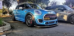

I have two sets of 17x7.5 that fit.Team Dynamics Pro Race 1.2, 17x7.5 +45
Sparco Podio, same setup. Both fit over the Brembos no problem.
Attached Thumbnails Anyone found a 17x8 that will clear the Brembos? [5x112.4, 66.5 bore, 40 mm offset]-img_20170618_192512-01.jpeg   Anyone found a 17x8 that will clear the Brembos? [5x112.4, 66.5 bore, 40 mm offset]-sparco1.jpg

17x8 NM Engineering RSe05, plus machining, is a game changer
My thanks to NM Engineering (RSe05 wheels), Supreme Engineering (Custom machining of center bores, and assembly), and of course Bridgestone for the RE71 tires. We're good to go for 2019. This is certified by the Mini of Peabody Pit Crew. Joel Decoff Crew Chief.
They fit,

Wow thats close. Talk about tucked.
Old Dec 21, 2018 | 04:01 PM
cmt52663's Avatar
cmt52663
Posts: 4,166
Likes: 402
The pictures are inadequate, as the wheel has more clearance over the calipers than the stock one does, and the same rim & tire to strut clearance (which is about 3mm).
Not too close actually.
I am so pleased, as the car is traction limited and has very low gearing, and this solution will help both of these concerns.
