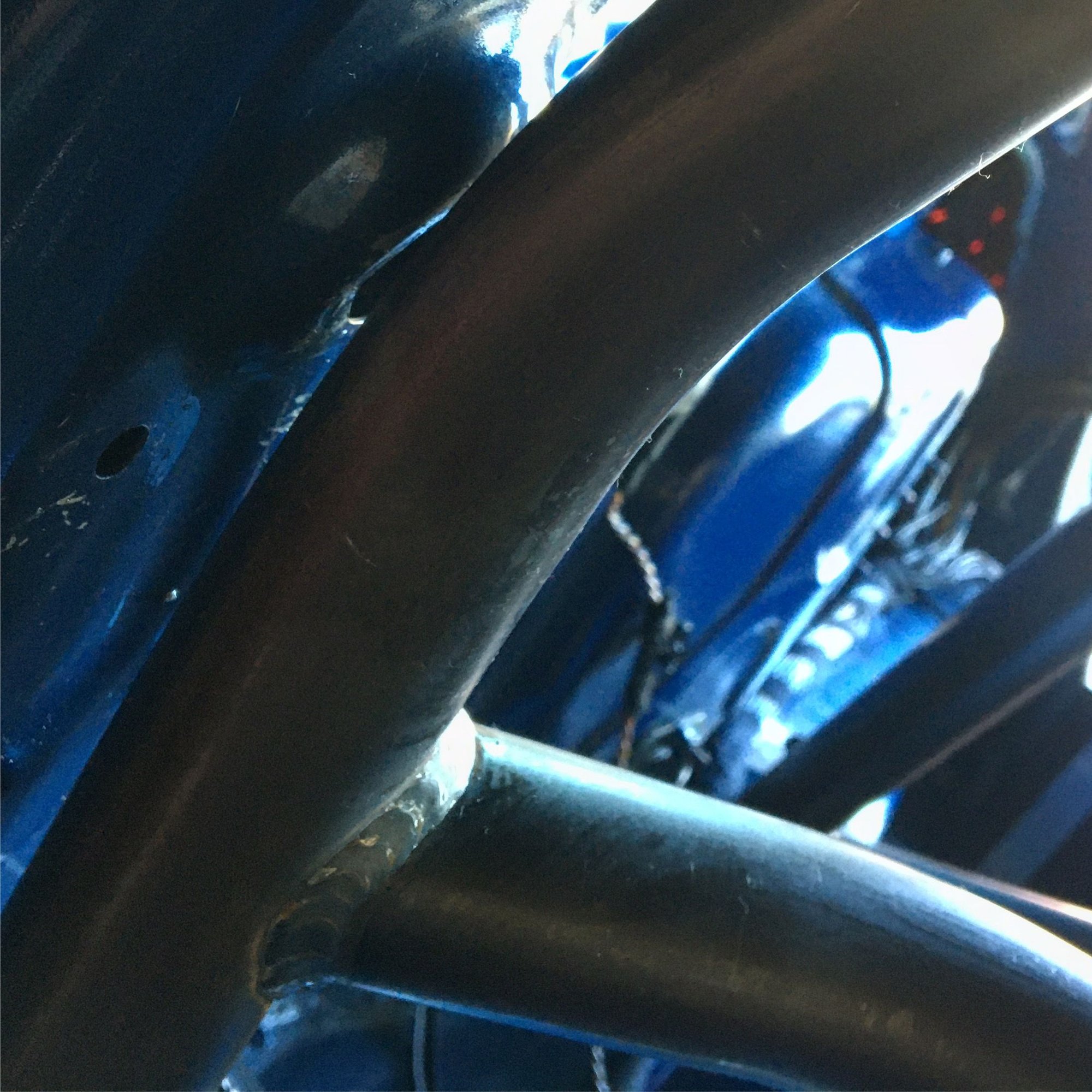

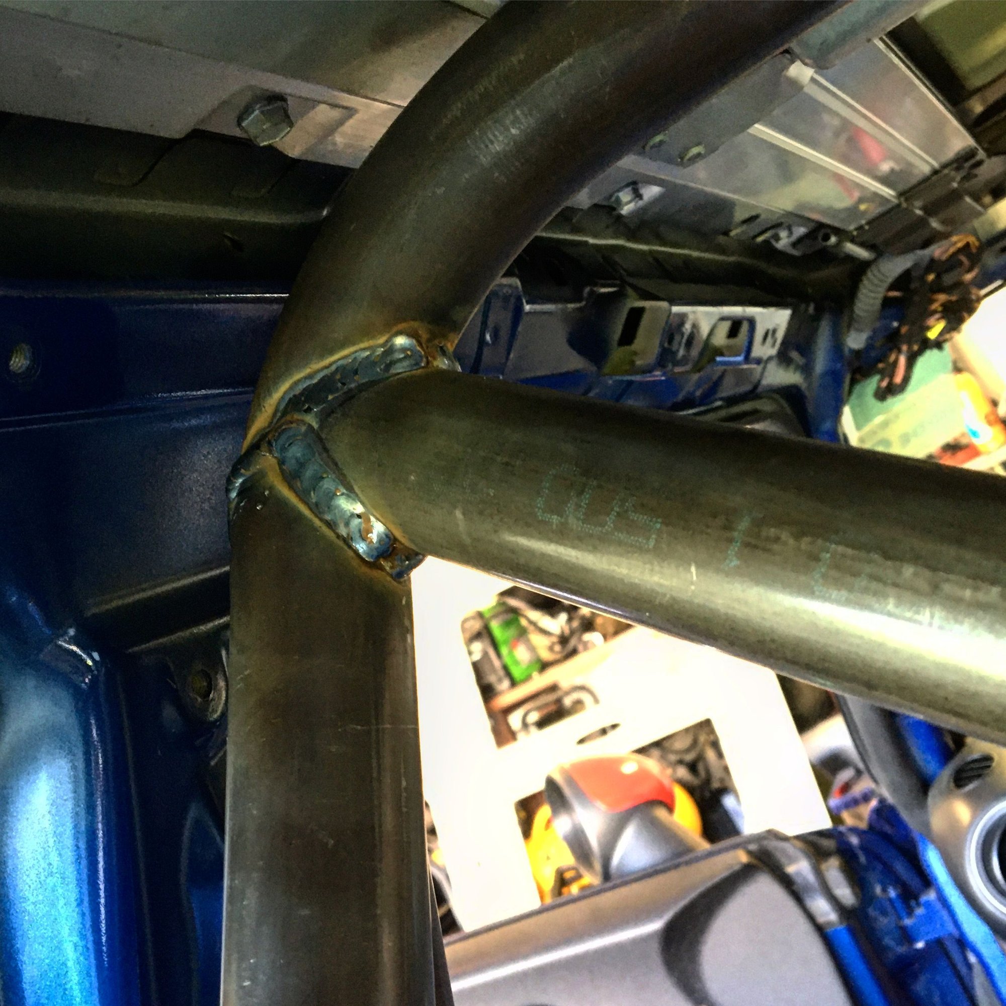

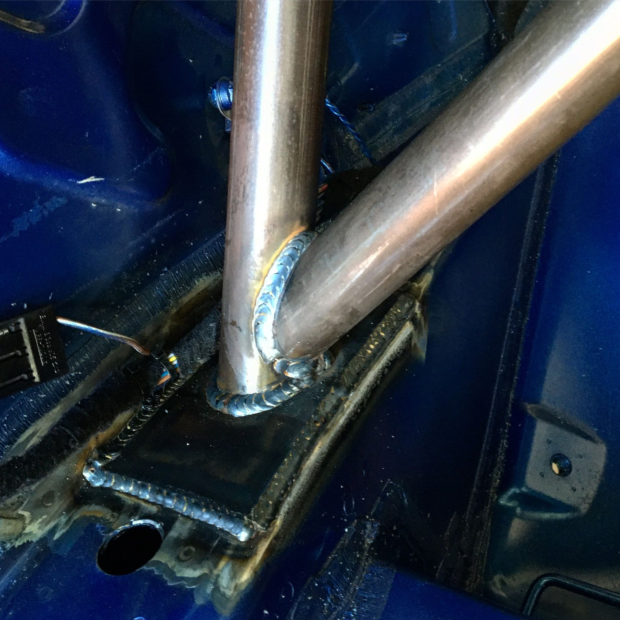

Time to get painting. Still need to get rid of the sunroof and figure out a timeline for turning this into a six point cage. Top Garage really nailed it. I’m actually happy that the Sneed4Speed roll bar was such a pile of garbage that I sent it back and paid a professional to do this right.
So close. So perfect.

So many comments...
So little space...
Is that supposed to be removable?
You do realize that is probably stronger than the rest of the car!
Do you realize how much that is going change the stiffness of the car and how it handles?
What, no seats?
Does Rob know the inside of your car is blue?
Now where are you going to mount the spare tire?
No, really, how many months did it take them to make that?
Ummmm you’re going to paint over that work of art?
Really nicely done!
A serious question - Why no cross brace on the hoop section? Or did I miss it in the pictures?

He knocked it out in one day! We messaged back and forth on Thursday, and I drove up to Atlanta on Friday morning. Put it all back together and drove home Friday night! And yes, it is noticeably stiffer
So we couldn’t do a diagonal because of my seating position. He had to bend the harness bar around the seats, so the diagonal would ave been sketchy. I’m going to adjust the seats a little more forward and he’ll add the diagonal and adjust the harness bar as necessary when we go to a full cage. Planning on going all in sometime me in January or February, it’s way too hot to be doing anything in the garage

My bolted-in bar made a noticeable difference in stiffness, which I didn’t expect given that it was “just bolted”. With the added stiffness, I thought it might change how the back of the car handles vs the front, but it stayed pretty even. I expect yours will be to your liking.
Now, time to put the seats in and get that thing to the track!

I feel so connected now. It is an absolutely awesome feeling and I cannot wait to get back to the track. Besides removing the headliner and like, 90% of the sound dampening material, I also removed the rear speakers to get the sound insulation out of the wheel well. The sound in this car is unreal. Every creak, every squeak, the sound of sand and gravel hitting the fender liners, the rattling and vibration from the solid motor mounts, the exhaust, when you lift, the sound of the turbo recirculating contrasting with the violence of the banging and popping, the cacophony of mechanical noise. This is the car I dreamed of as a boy. Ear plugs are a must, but damn I am in love.

“Someone” does really nice work.
Cool graphics on the cage!
