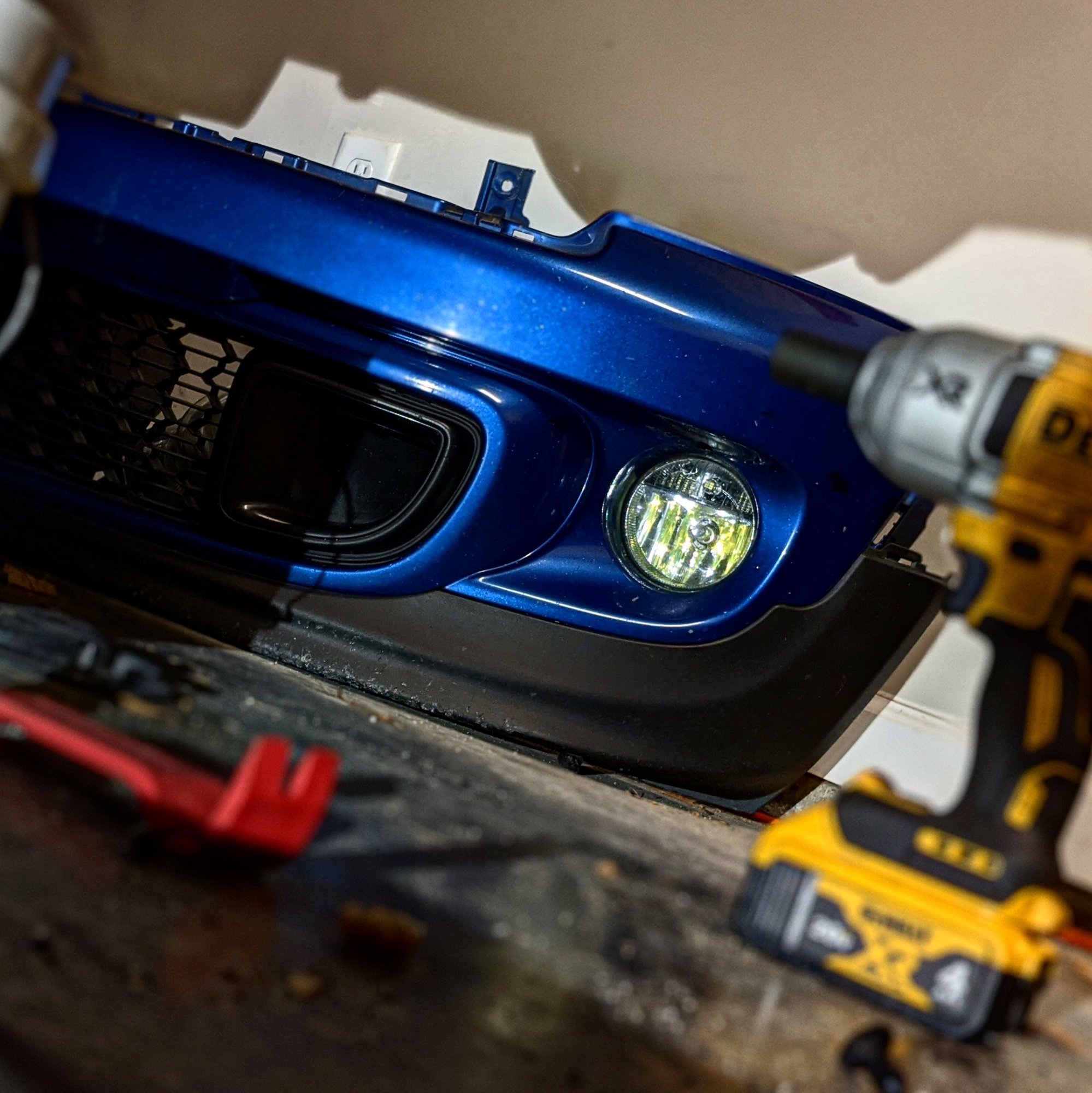

She's all back together and running great. 22.5 lbs at the snap of a finger, so I'm pretty pleased.
In no particular order:
All new studs, nuts, hollow bolts, washers and gaskets.
Primed the turbo with Liqui-Moly Turbocharger Additive.
Motul 300v 5w-40 and a fresh OEM filter.
Flushed coolant and replaced with fresh BMW Coolant.
Removed all loose gravel from the subframe and bumper support.
Replaced DEI Titanium Wrap on downpipe.
Our adventure in the gravel ate some of the titanium wrap on the downpipe, so I gave it a fresh wrap. I also discovered the mounting adjustors for the downpipe. It took six years to figure that out
