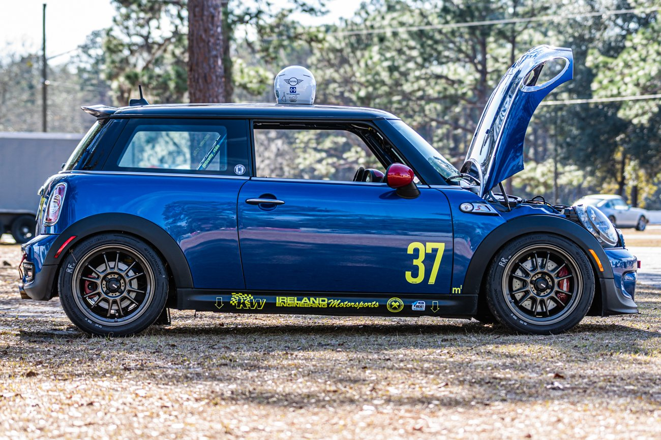

Nicely done...
That side picture of your car is a really good shot. It still has a great finish and I like the yellow lettering on the blue.

I like the stance. Very proper.
