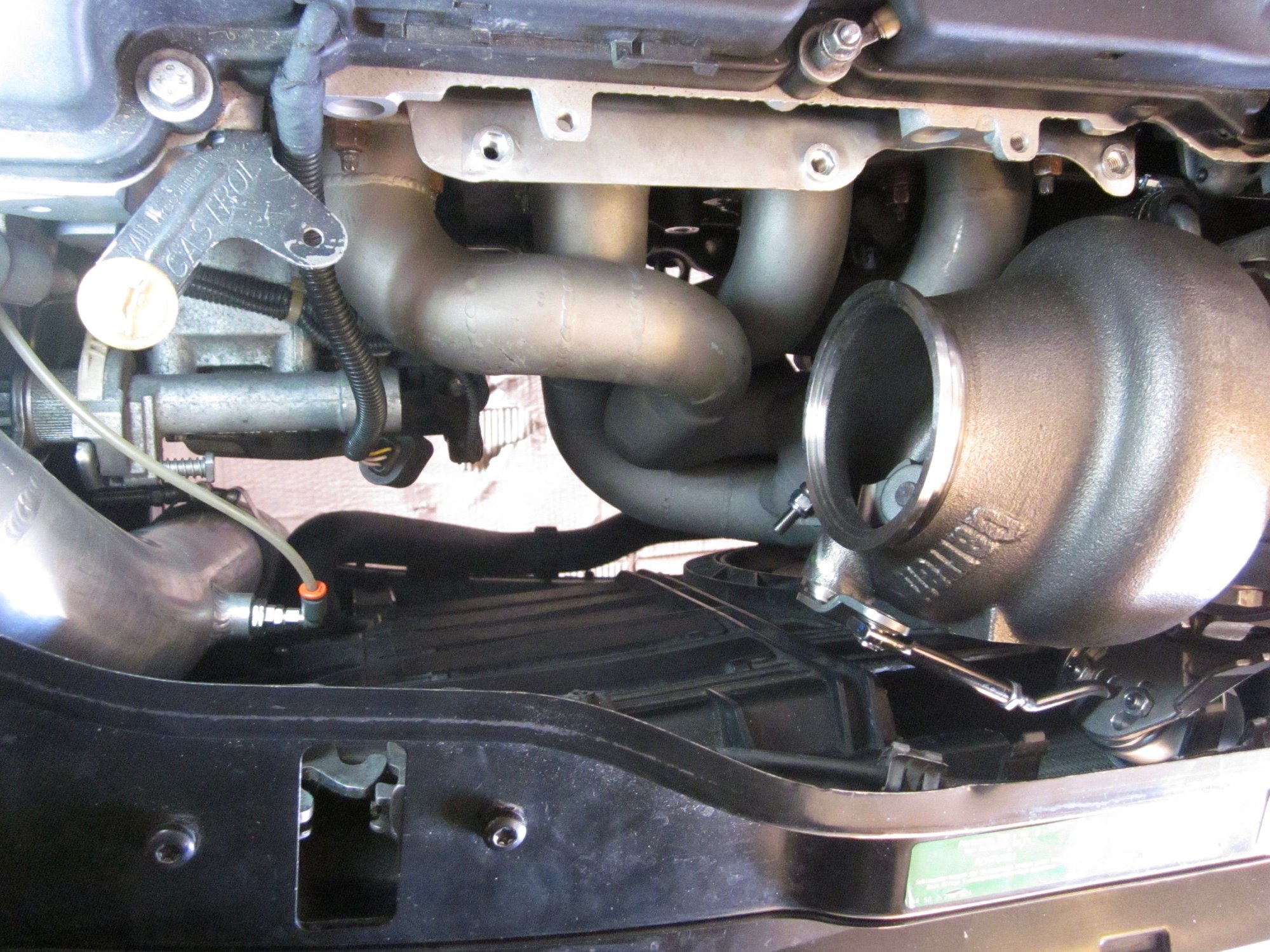

Small update.
I have been chasing an intermittent boost leak for awhile. It was't too noticeable but I was pretty sure it was there. I made a simple tester with a couple valve stems and a PVC pipe cap. After I pressurized the system I sprayed soapy water around hose clamps and the water injection fittings. Sure enough the push connect fittings were leaking like crazy. These fittings have always been suspect to me, I never felt like they were fully seated or secure. I decided I should look into replacing them with compression fittings. After totally striking out at Home Depot, I took a look a local hydraulic supply store. I managed to get 10 fittings and a 90 degree elbow for about $20. Definitely a "duh" moment . If I had know about this place or had thought to actually look at places other than the AdvanceOreillyZone equivalent hardware stores, building the direct port kit would have been so much easier. They also have t-bolt clams and silicon hose/tubing. Like, total face-palm moment.
I think it is probably time to reevaluate the set up and improve it.
Also, it turns out that if you pressurize the system it will suck all of the water out of the tank and dump it into the intercooler. I really lucked out that it didn't leak into the intake runners. Lesson learned .

Hey man, so I’ve come back and looked at your last post a bunch for reference.. I’m really digging your hardline direct port WMI setup.
How far do the 90 degree nozzle holders protrude from your intake runners?
I have a single nozzle WMI kit waiting in my shed for me to install, but wanted to make direct port work if at all possible. On my R53, the space for a direct port tap is extremely limited under the TMIC, plus the fuel rail is already sandwiched in there too. Just curious if there’s a glimmer of hope for me haha.
In any case, yours came out great by the look of it.
Thanks!
They stick up about 1.25". You could probably get away with something shorter. I found a local hydraulic supply store that has pretty much everything I would need to build another one or modify the existing set up. I wish I had know about it before I pieced this thing together
Here's another option for direct-port WMI injection. The jets are all mounted the same as the original Aquamist single jet pre-throttle body set-up, and are holding 30PSI boost.
There are also smaller 90 deg fittings that might be easier to work with.
