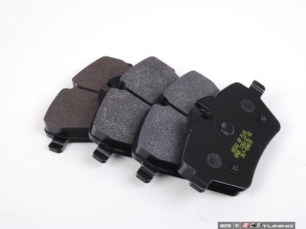

Here are the pads. Hawk Pads JCW Gen 1 fronts
http://www.ecstuning.com/Search/SiteSearch/HB560/

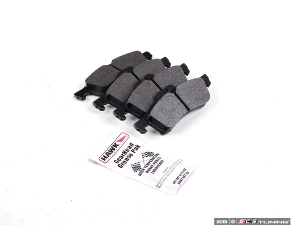

and the rear which are the same as the Cooper / Cooper S, MINI had the same shape pad for the JCW's just had a different compound.
Hawk pads rear
http://www.ecstuning.com/Search/SiteSearch/HB445/
