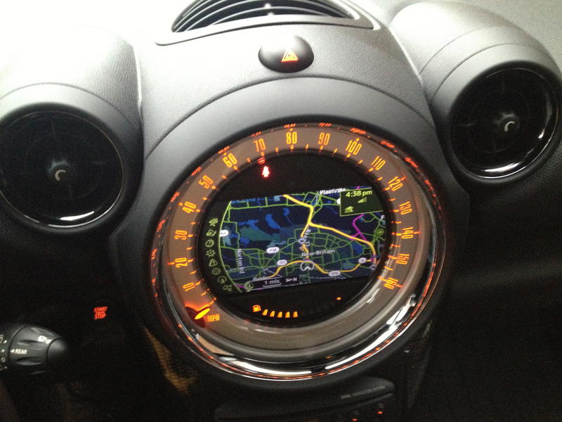

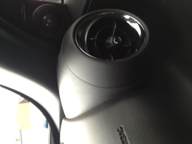

A dime would not even come close to fitting between the existing dash and new trims...

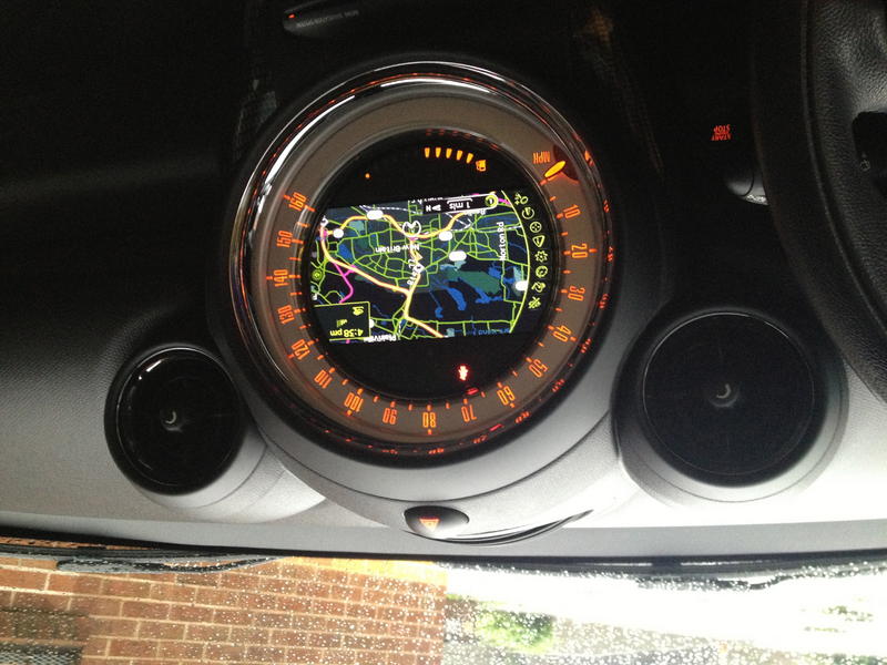

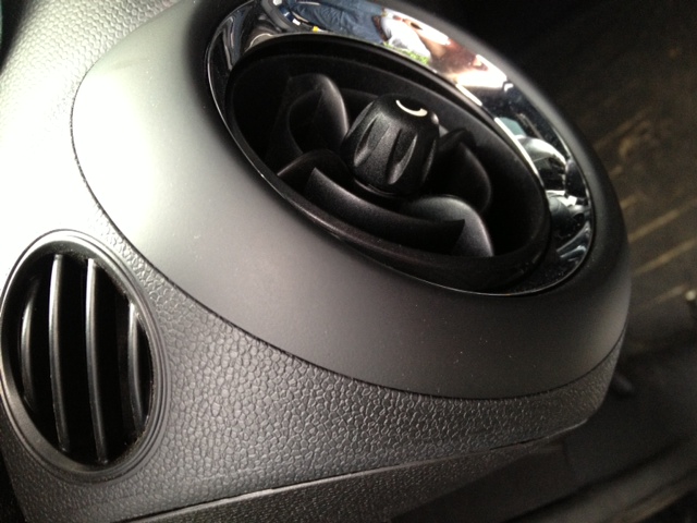

Here you go......Should be another in my gallery.....
https://www.northamericanmotoring.co...l-img_4534.jpg
Also posted 3 pictures over at this thread... # 38
https://www.northamericanmotoring.co...+Mouse+Removal

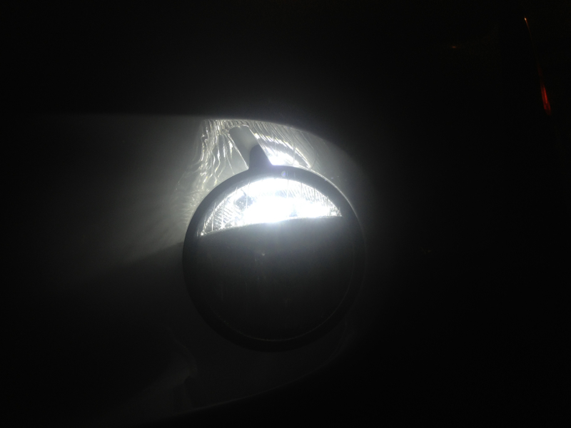

Flyer53 is running LEDs for city lights (the park lights in the top half of the fog light cluster).
Old Jul 13, 2013 | 09:52 PM
  #166
Flyer53's Avatar
Flyer53
Joined: Jan 2011
Posts: 885
From: CT
Quote:
Originally Posted by Koopah
Superbrightleds.com part number: WLED-CWHP15-T (cool white matches the xenons perfectly). NOTE: these LEDs DO NOT contain load resistors so you need to code-out the warm and cold bulb checks from the FRM module.
These are what I have in the upper half of the two bulb fixture......
They look great!

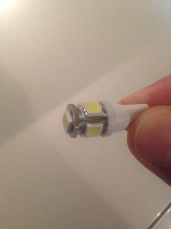

These are the ones I used. They match the color of 6k perfectly. These will also need to be coded out, no resistors.
Attached Thumbnails '13 dash in a '12-image-2608885617.jpg   '13 dash in a '12-image-946199262.jpg
