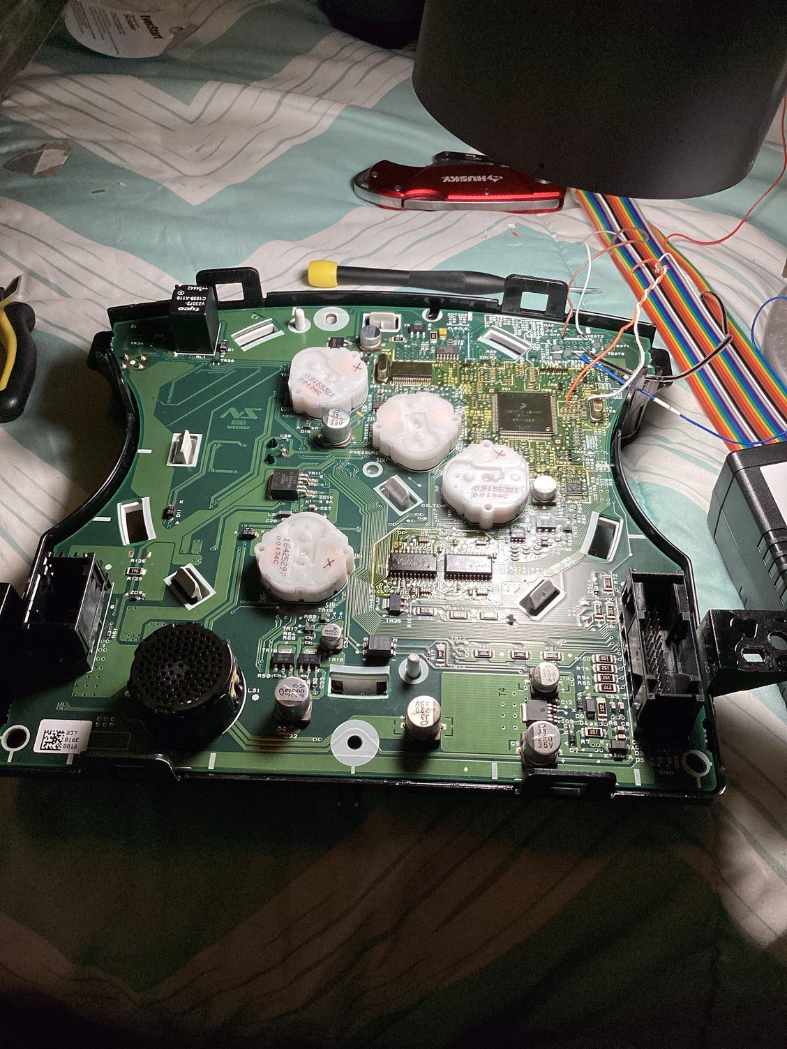

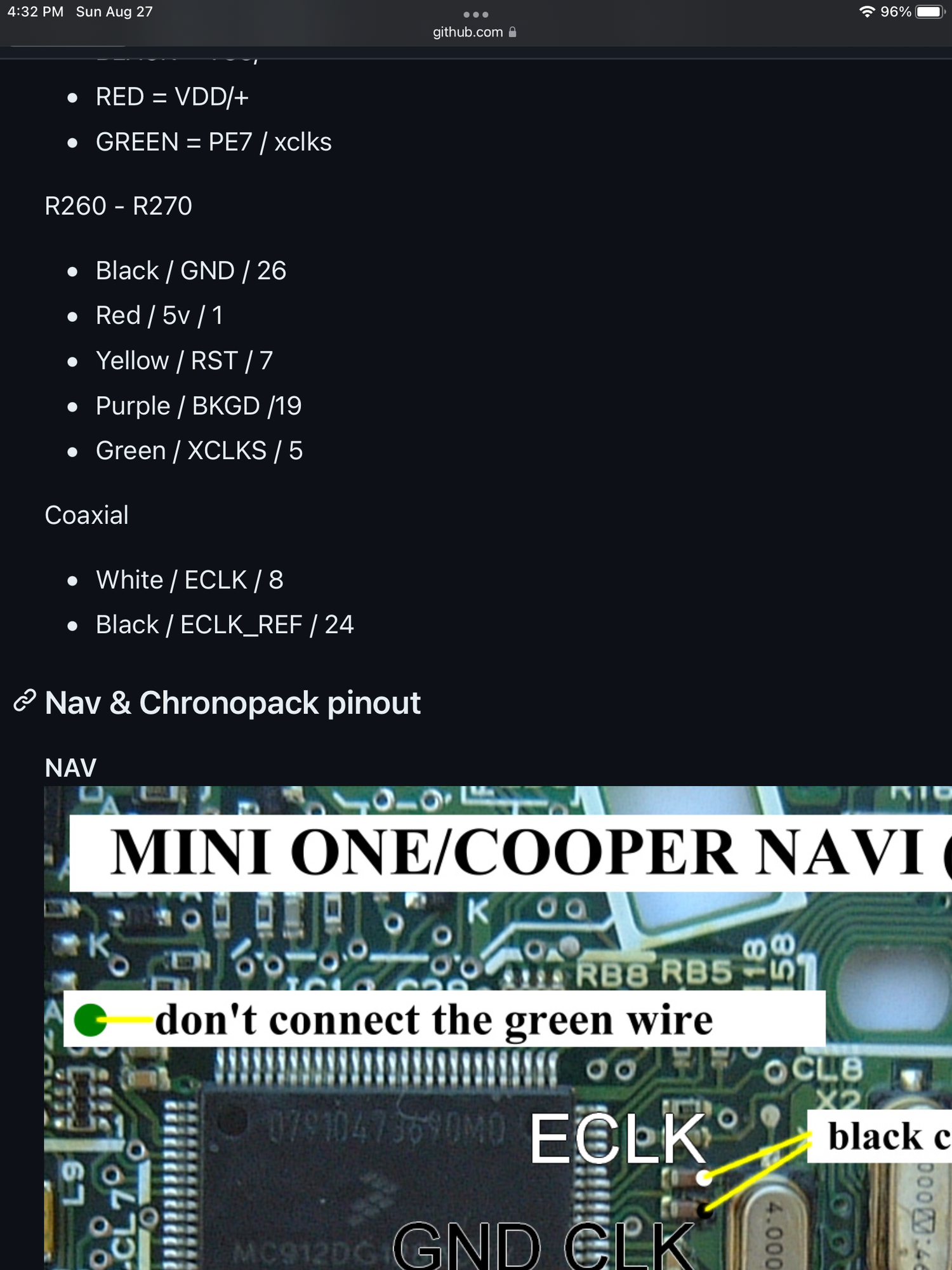

Which chip is the odometer stored in?
Originally Posted by Onizukachan
Different perspective.
Im coming from e46 /e83 and researching R53 Mini.
They’re basically the same as far as computers are concerned.
A> yes installing a virgin cluster will cause it to pull the vin and mileage from what we call lkm, possibly bc1 also.
B> used clusters are not virgin and will trigger a tamper dot.
C> Bmw can not reprogram a used cluster to work. They lack the tools and resources to do so.
D> you can not swap EPROMs. These aren’t late 80s e30s!
D> you or I can revirginize a cluster or lkm ourselves using a combination of two computer tools.
Yes, Virginia, there is a Santa Claus.
You need pasoft 1.4 (or bmwscanner 1.4, the clone program $30) to be able to reset the vin and mileage to 0 on the used cluster or lkm... ie revirginize.
Then you use NCSexpert to code the now newly virgin module to your vin/ FA, and then again also to the modify your FA to reflect the changes you have made, chrono, Nav etc. By changing the cars build options stored in those locations and recoding the entire car so everything works the way it should.

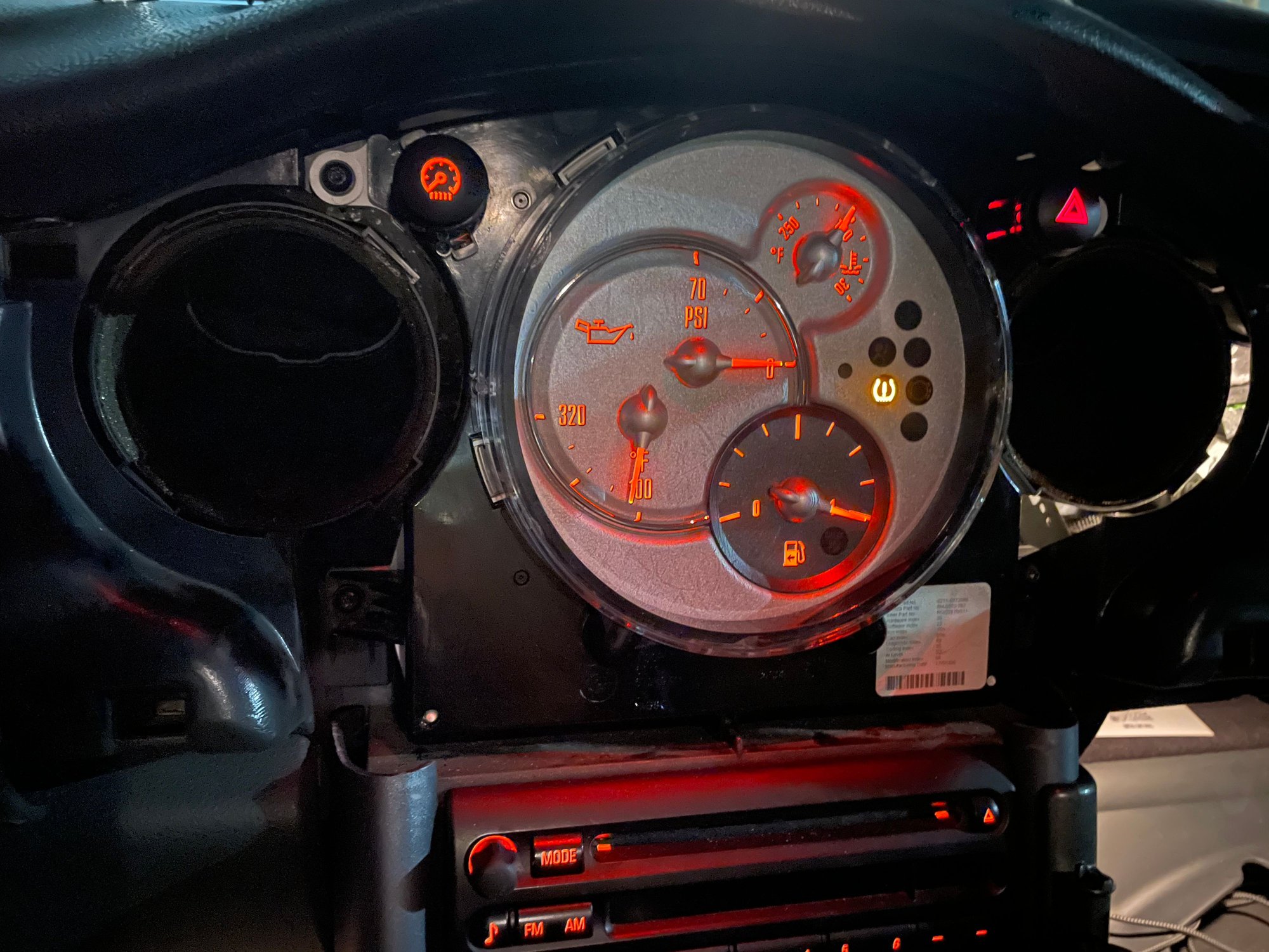

Wow, that was a long time ago… but this thread still exists and comes up as a top result in google so I might as well set it right for the next person
so to conclude this thread, I was both wrong, and also right.
I now own an r53 (see Route 66 link in sig) and one of the first things I did was convert from the now useless standalone nav (none of this side of town even existed when the last nav high disc came out) to chrono successfully.
I was right that the used clusters can be revirginized, but wrong about the tool. Apparently pasoft can’t revirginize the r53 center “cluster” like it can on bmws. I tried, option is still there but doesn’t work.
however they can be revirginized using an r270 to reflash it with a “0” mile virgin profile($20 on Amazon, all info on GitHub). and then pasoft is easily used to import vin and programming.
It could also be done with ncs, but pasoft is far far easier.
If going nav to chrono, you do not have to worry about coding gauge angles etc. the chrono actually uses the same settings as nav, since nav came first. In bc1 there are really only two settings for aux gauges, , dual pod or single pod. If you are going center Speedo single pod to chrono you have to also go dual pod to have a Speedo, plus for warning lights etc to work, and you have to revirginize chrono, and import vin etc, then also code to match.

Has anyone found virgin bin files for the navigation kombi?
Old Oct 7, 2023 | 03:12 PM
  #97
Onizukachan's Avatar
Onizukachan
Joined: Oct 2017
Posts: 571
Likes: 369
From: El Paso TX
Yeah, they’re all on GitHub. Both types, nav and chrono. .
