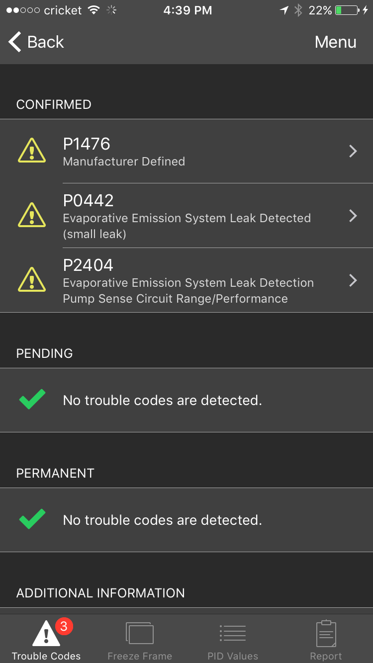

Traction triangle and TPS lights both turned on. They clear automatically after driving when I reinstall the Nav.
I attempted to use odb2 scanner and clear codes, but they show nothing related to the lights on dash. Ignore the attachment, it only shows old codes from vacuum leak.
Attached Thumbnails OK here goes:  Remove Chrono, install Speedo?-2017-05-11_16-39-41_000.png

I received this reply from the seller. I've sent him a link to this thread and asked him to chime in. I dont know if this software he suggests clears the lights AND fixes the mileage issue.
