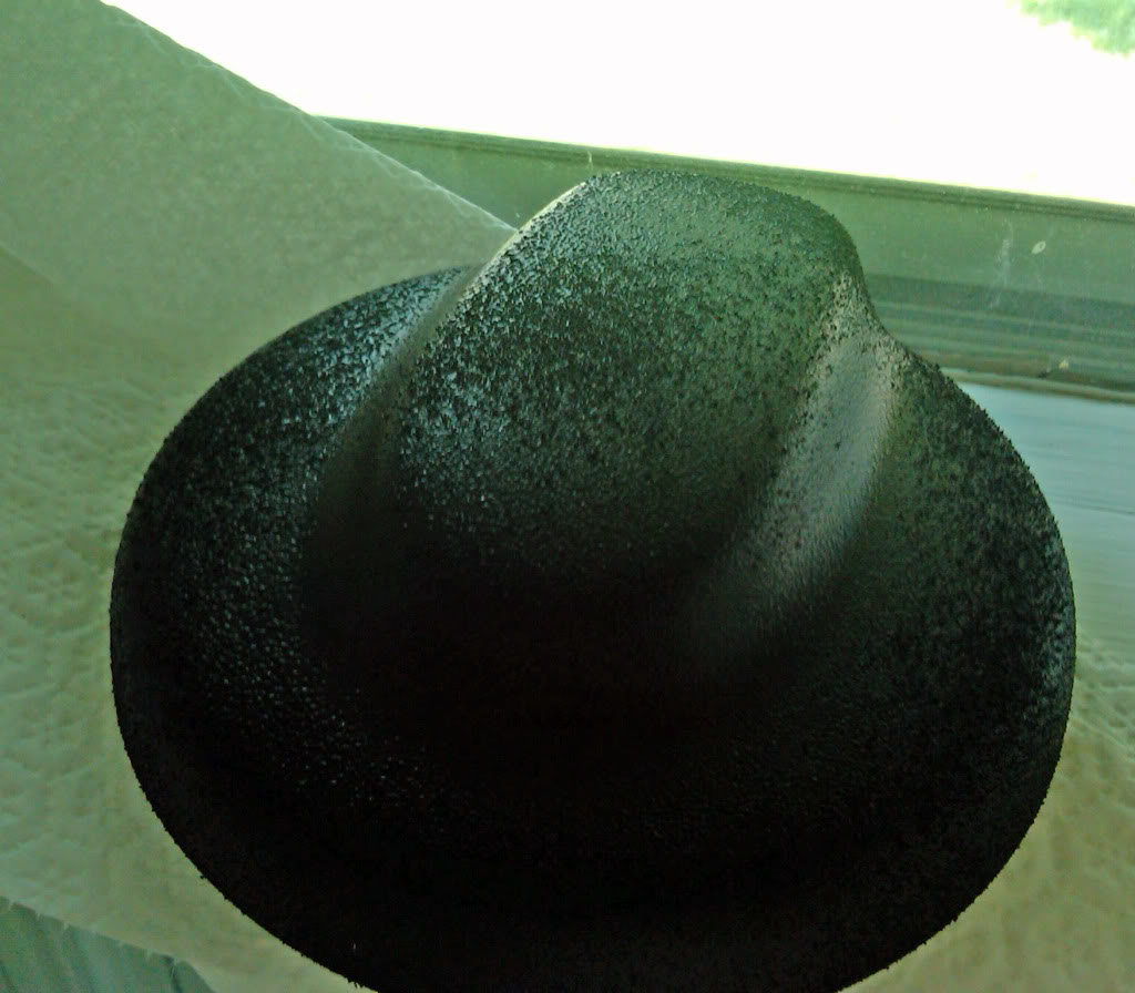

I don't know if it's the heat and humidity 100 degrees with like 40-50% humidity.(in which faq on plasti-dip's site says , do not use in high humidity), but i am having horrible luck getting my plasti dip smooth looking. I have done the gas cap like 3x's now and it always starts to bubble up kind of peach fuzz looking texture. Are you guys some how sanding it between coats?
My technique that so far is not working
1. clean chrome part with mineral spirits and then ammonia free glass cleaner
2. do not touch it with my fingers once clean
3. first coat, I hold the can 12-16" away and spray in strokes and lightly cover the chrome piece with a light coat
4. wait 30 minutes and come back and spray from 12" away and lightly cover the chrome piece again. This is when I see this peach fuzz type texture appear
5. wait 30 minutes and do the same thing as step 4.
6. come back and get pissed that it's all fuzzy and wonder if it's the heat and humidity here in texas
7 strip off plasti dip with mineral spirits and try again.
I am using the spray like i was spray paint anything else. Very smooth strokes not letting off the nozzle till I am past the piece i am painting during my stroke.

I would try a different can of the plastidip.
Out of the 5 cans I bought 1 of them had the same issue.
The newer cans seem to work better.
OK thanks, i bought all 4 of my cans from the same home depot. All the rest are out of plasti dip . Lowes by me doesn't carry it. I'll give this other bottle a try. My technique is correct right?

When I did my headlights, taillights, and gas cap it was a little cooler outside back in March. I know high humidity may make it bubble and shrivel up a little. I did my headlight washers on a different day and re-did my gas cap back in May and it was pretty hot out, not Texas hot, but pretty close. I put the pieces in my freezer to help cool them down and dry them. Also, I never waited 30 minutes, just use judgement. Don't stress too much over it, its very simple. Just spray and dry. I did like 2-3 coats, and everything is holding strong. G'luck
It's not spray paint though.
When you have a few minutes, go over the directions on the can.....PD is totally different. Layers have to be applied within a certain time frame, and CANNOT be applied in direct sunlight. Find a shady cool spot like a garage or basement
Paint thinner or mineral spirits will remove the old stuff. I had PD on most of my chrome parts and it lasted almost two years until I just recently installed Aesthetic Creations molded flat black trim in it's place.
