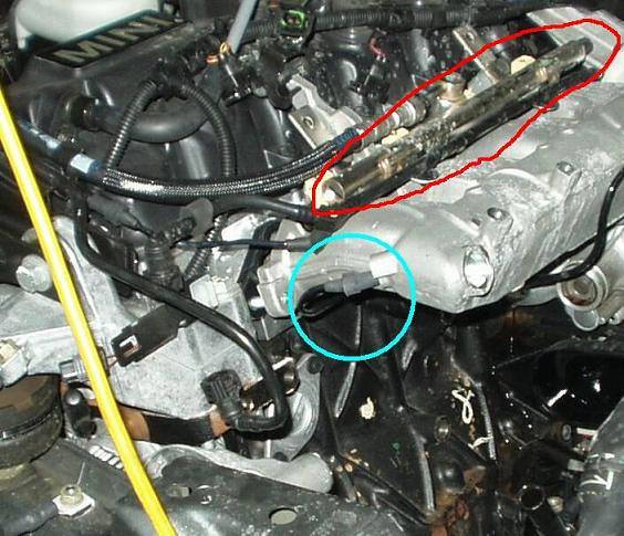

I'll check the hoses in a while and will let you know the outcome. It should be a problem there since I already check it yesterday. Maybe the sizes of the T might causes this?
Btw, What is this thing in red. It seems to have a "screw" at the end of it to make adjustment. What is it for?

It's the fuel rail.
The fuel injectors and pressure regulator are attached. The cap on the end is for a pressure guage for diagnostics.

Dr obnxs,
Thanks for the reply. I guess that has nothing to do with my problem isnt it. I've check the hoses but all seems to be fine. I'll take the car for a drive to see if there is any improvement....
