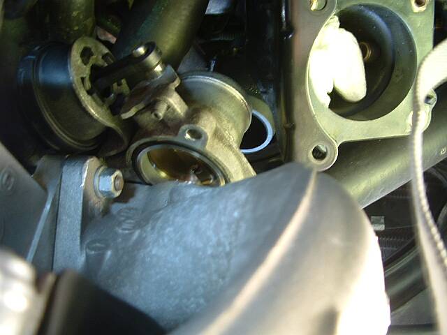

I have a new 2005 MCS w/automatic. I didn't have the yo-yo (which I experienced in a couple of used MCSes w/manuals that I was considering), but I have noticed a flat spot / lower torque situation in the 2000-2500 RPM range. I decided to try the VGS mod to see if it helps this at all.
The install took me about an hour and about 25 curse words.
The car is more responsive at lower RPM now, the flat spot is pretty much gone and the power curve seems smoother when accelerating than before. The smoothness is harder to quantify because of the automatic. Overall the responsiveness seems to be improved and there are no negatives at all to report.

I'm glad the VGS has worked out so well for so many of you. I'd like to reiterate that it is a good idea to install it in such a way that it's quick and easy to swap back to the stock configuration in case you have issues. Using a capped length of hose at least 6 inches on the lower bypass valve nipple is the way to go, that way you can leave it plugged into the lower nipple, uncap it, and plug it into the vacuum diaphragm (making sure to cap the long hose from the manifold) to return to stock.
BTW, I thought of an analogy for the stock configuration. It's as if you had a thermostat right next to your furnace, causing a feedback loop that doesn't allow correct control. My moving the thermostat further away from the furnace, it isn't as affected by the conditions near the furnace, hence no feedback loop.
