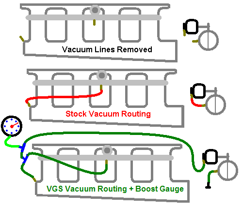

I'm not sure if the spot where CoryB tapped is manifold vacuum. It looks like that line connects the fuel tank evap valve to a nipple on the throttle body. If so, that might not be such a great idea.

In looking over everything and tracking vacuum lines tonight, I believe you're right. While I was checking, I found the vacuum nipple you were talking about and rerouted the hose to that. No real change in driveability, but at least I know I'm getting manifold vacuum now.

AFAIK, there's only one vacuum nipple on the intake manifold, right next to the #1 runner (passenger side of the engine), as shown in the pic. What part are you having a problem with?

I appreciate all the efforts of Andy and his graphics.
Is that a plug on the lower most illustration with the green connector hose (bottom right)? It does not appear in the Stock routing illustration.
Vince
Yep, I just used a screw to block the line. It would be neater to replace that line with a vacuum cap, but I wanted easy access to be able to swap back and forth to stock.

Bought the vac hose last night, will install either today or tomorrow. Is there a commercially available cap available to use in place of the screw that Andy has used?

The local auto parts store should have an assortment of rubber vacuum caps (Smurf condoms ) available, which slip over the hose barb on the bypass valve.
