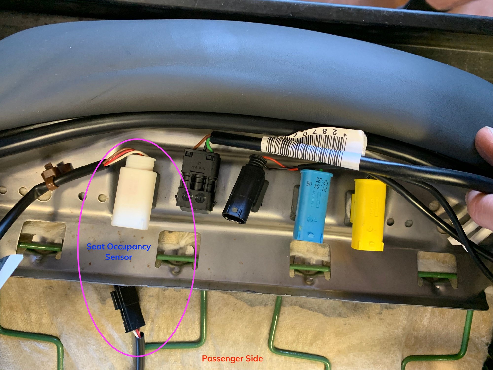

So just a couple years later but I finally have a set of the euro delivery Reacro seats in my garage. Do you have any advice for swapping with the stock seats, was it as simple as plug and play for the airbag, and seat heater? Just disconnect the battery or is there a fuse to pull instead of disconnecting the battery?

The euro R53 Recaros don’t have the passenger occupancy sensor. You’ll need to install the proper resistor on that plug. Google search for “MINI R53 occupancy sensor bypass” and you will find details on that item.
The rest is plug and play. Yes, disconnect the battery.

Ah JackMac to the rescue. I was going to say, I was finally able to finish the install of both seats this weekend. As everyone said they were an easy remove and replace. The only sensor the Euro seats didn't have was for the passenger seat occupancy as mentioned. Currently I have the airbag warning light but I will purchase a bypass sensor this week. Seats feel great, a huge improvement from stock.

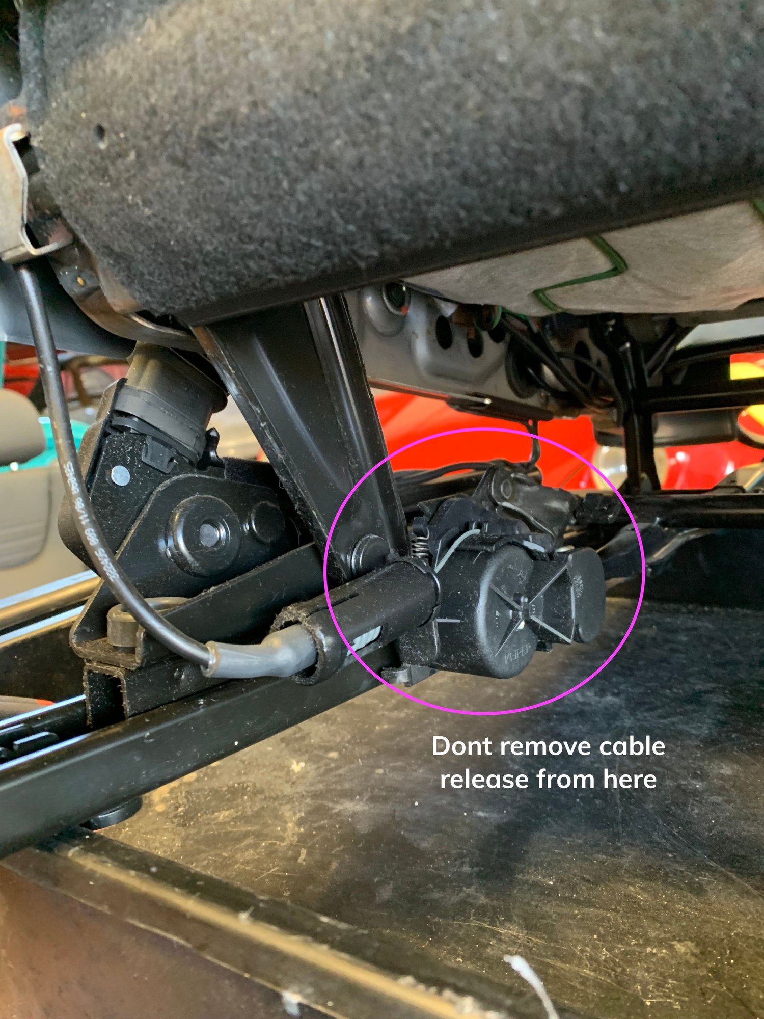

I will note for anyone looking to do the swap to make sure they disconnect the cable release (for the seat back to flip forward) from the seat back and NOT from the bottom of the rails at the tensioner unit. Removing from the seat rails was much more difficult.
