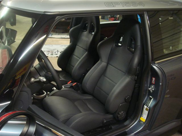

I opted for the Sparco version; these are JCW's panther black leather version.
IMO both the Sparco and Ricardo are much more befitting of the gal
