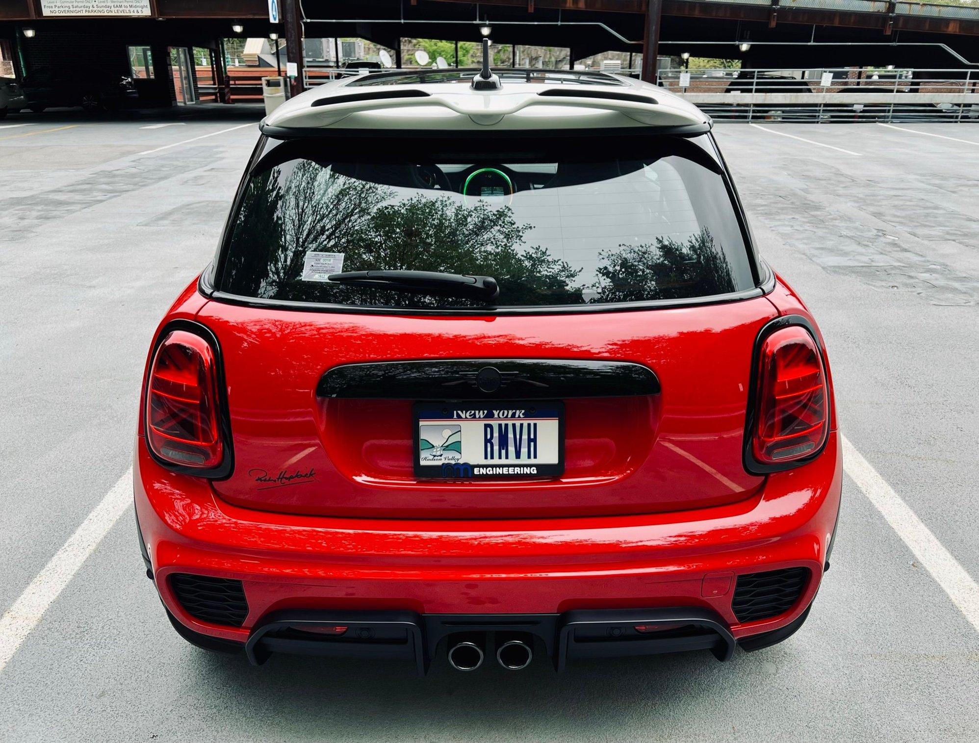

@MikeMJCW,
I realized I have no close-up pictures and I will take some and add them to this thread.
Maybe for you next modification you could enable the rear fog lights . I did it and here’s the post about it:
https://www.northamericanmotoring.co...unctional.html

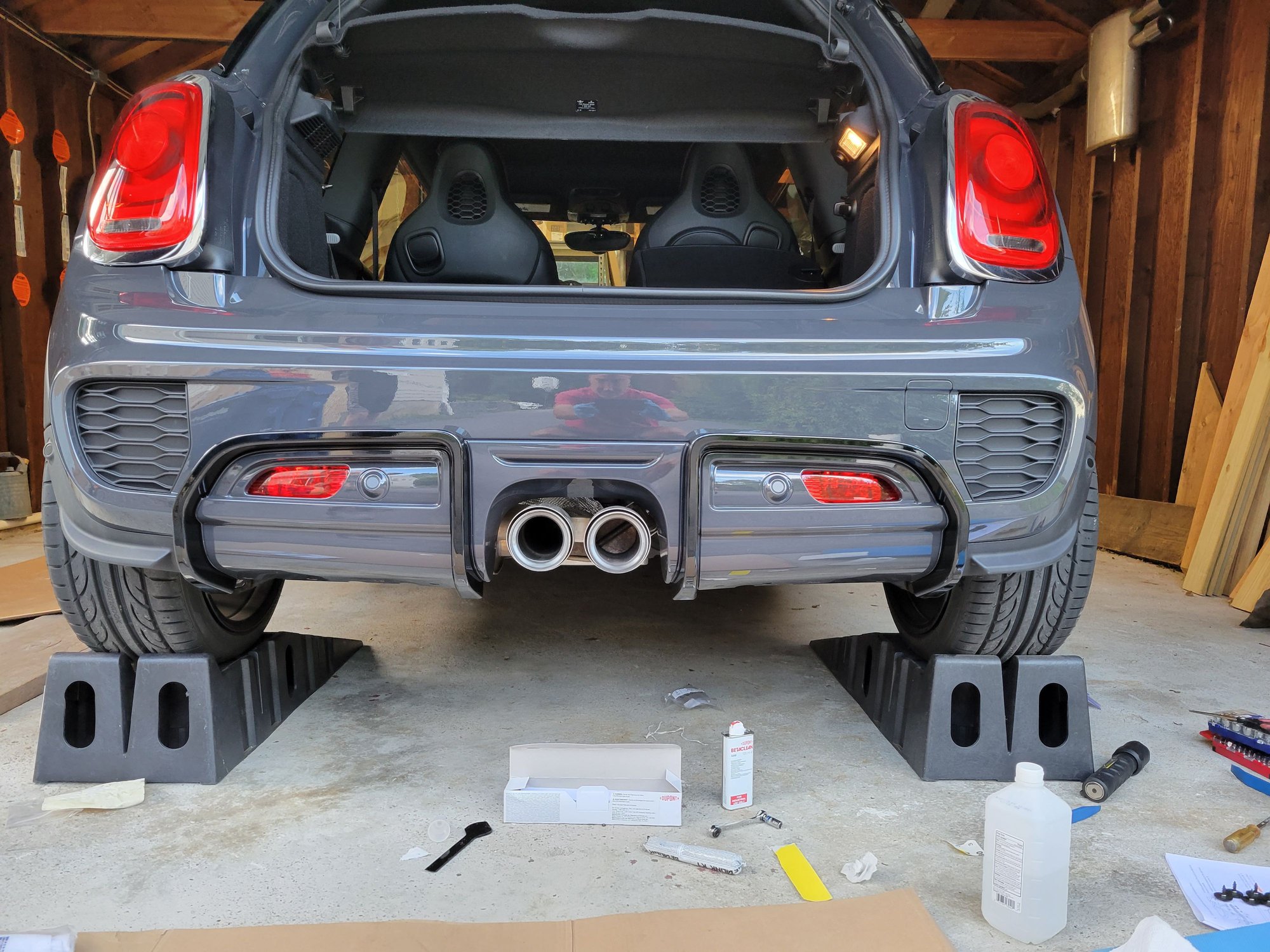

Pic is dry fitted. Thunder grey insets, gloss black band (to match roof and side pillars). I asked the body shop guys for advice, not my thing. Love the color combo, the diffuser itself isn't 100% i.e. a bit after thought-y,
Whenever you see glue or Loctite 9 times out of 10 the engineers goofed something. Speaking of goofed- if you forget to hook up the back up sensors (or need to replace the fog bulbs) simply remove rear wheels and unfasten the wheel arch liners. This gives access to rear mounted fog light housing bolts. Added a before pic, not using splash guards as the Hankooks don't pick up crap.

Old Sep 4, 2022 | 02:55 PM
RichsMINI's Avatar
RichsMINI
Joined: Jul 2020
Posts: 266
Likes: 166
From: New York State
HOT DAMN!! That’s one good looking painted diffuser Congrats…
Off topic, what brand race ramps are those? I was looking for a set and have been overwhelmed with brands and reviews.
Old Sep 4, 2022 | 03:43 PM
MikeMJCW's Avatar
MikeMJCW
Joined: Jun 2018
Posts: 589
Likes: 112
Rhino ramps 11909. I paid $50 with a coupon a few years ago at Advance Auto. I built the extension (bolt hole in the Rhino logo) for an Alfa Giulia I had. My mini was originally dropped 10mm but has probably settled a bit and it does scrap the front a little bit without the extension. The diffuser had cured but this afternoon I parked the rear facing the sun and I saw the diffuser pull away and the glue had softened. So much for $60 Betalink. What 3M did you use?
