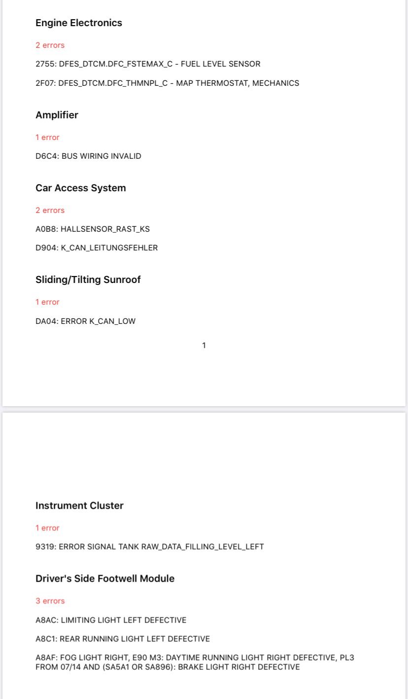

Went to the dealer to see if they would replace my FRM under warranty as I get a few error codes from BimmerLink, but they said it has to fail to replace and they said I have 2 other Oil Leaks which are way over my head and I kinda used up my friend credits with the shocks. They wanted $1500 for these two leaks, there’s two import mechanics in town but not sure if I could get both fixed for maybe $800?
Oil Filter Housing Gasket
Front Crank Seal
1st local mechanic also says I need to also look at thermostat housing again, no CEL codes but I get the 2F07 code from BimmerLink saying my car runs too cold.
Then Bimmer link also shows these codes that aren’t throwing an error yet.

Anything else on the N12 engine that I should replace since newtis talks about getting car in service position and pulling some of the front end off?
might be a couple of weeks until I can get help to do it, I don’t see any oil on the ground. I normally check oil once a week but will check everyday (it’s my daily driver). Last oil change was 1500 miles and I’ve only added about 1/2 qt.
How many more oil leaks might my future hold?
