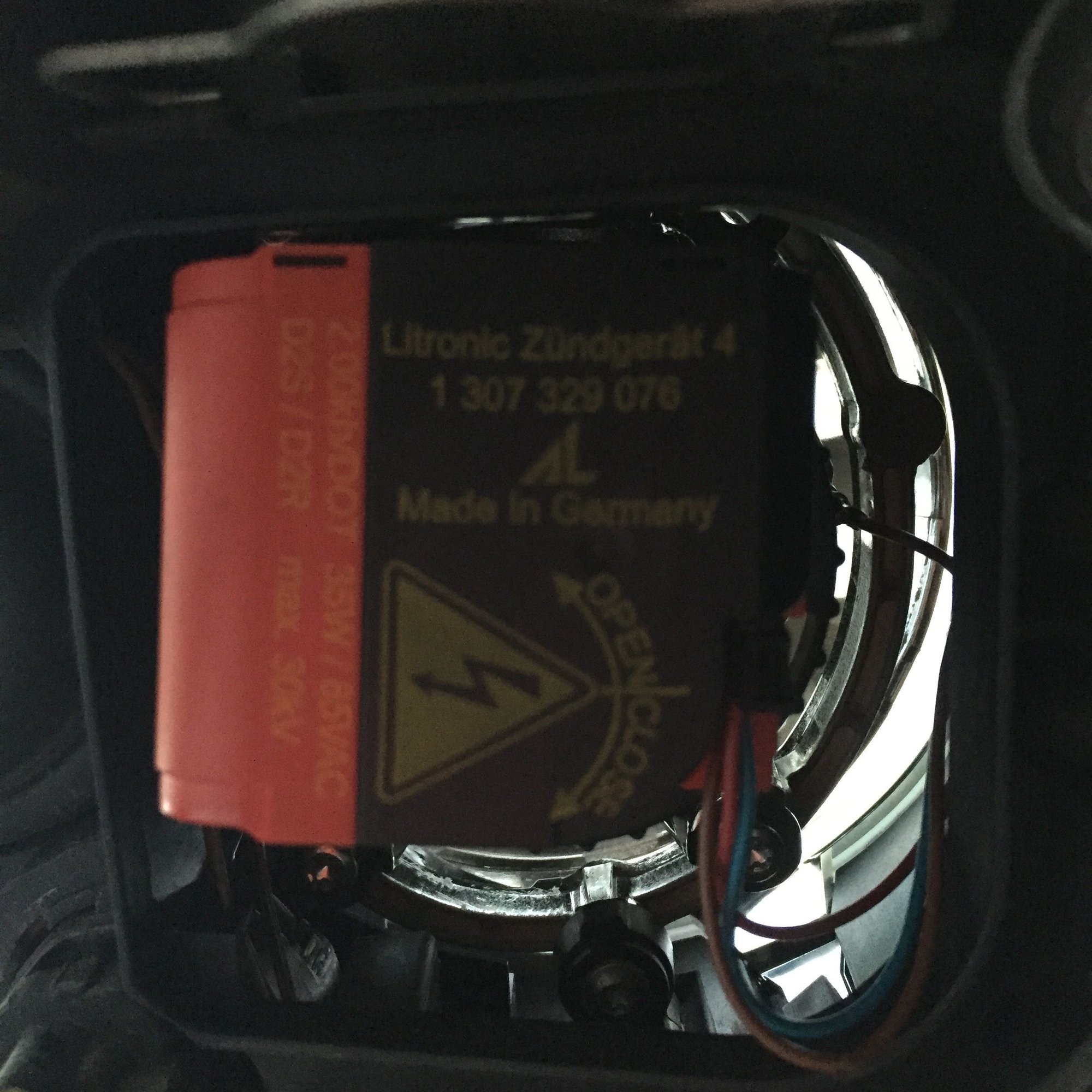

To make 100 precent sure that it was indeed the bulb ONLY and not the electrical stuff (ballast?), I decided to try take the one out of the driver headlight to try it in the right.

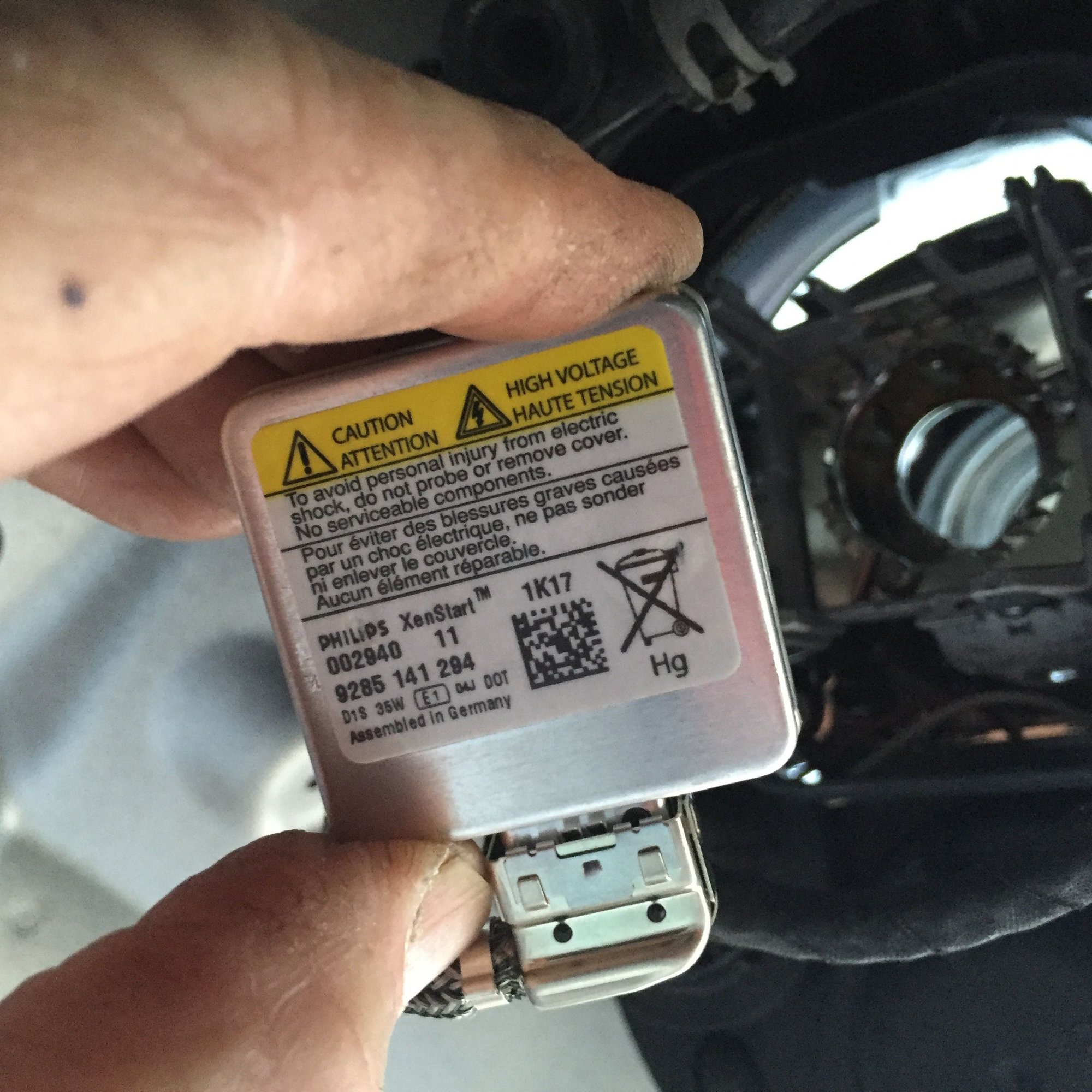

When I got into the driver headlight, I found that it was hooked up entirely differently and didn't want to try disconnecting it. (see photos, silver setup and bulb are from driver side)

Bulb from driver side headlight
The reverse of the bulb setup from other picture
The set up on passenger side after extracting the bulb and replacing it empty

Don't attempt to take the bulb out of that silver unit, its all on piece. You can just disconnect it and swap it with the other side and see what happens. if it doesn't work then its the bulb.

Weird looks like you have D2S on one side and D1S on the other side. Do you have pics of the front headlights ?
