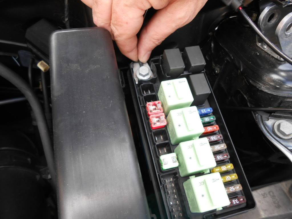

So I have a 2011 Countryman with genuine mini spotlights.
These are wired into the spare 12v supply in the engine bay fuse box. Looks like this (not my image):
Assume it came like this from Mini or fitted as a dealer fit accessory.
